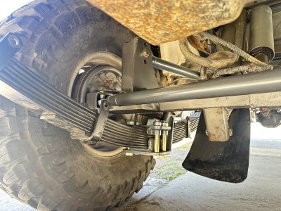

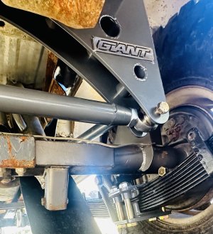

I have the Giant kit on my 94 Bronco and its pretty unbelievable how well they work on broncos. (use to have one on my tundra) works way better on a bronco. @Giant Geoff kit installs super easy and is all bolt on. I would highly recommend rear shocks with a 3" or larger body tho. If you run an under the bed shock mount the shock angle gets pretty drastic at full bump. The 2.5 bypass I run seems to loose compression dampening in the bump zone and they have pretty heavy shims in them. One thing I really like about cho's kit is the uniball shackle pivot and as far as build quality both Giant and Cho are very nice. Price on the Giant kit complete I'm unsure of I bought everything minus the Deavers for about 1400 with bushing and stuff. Id imagine the Deavers would add at least another 1000
Thank you for the advice, I like hearing how well the 64s work it helps justify the cost. I still have some time before I start purchasing parts just wanted to hear other peoples experiences.
Go with Giant kit. I've isntalled a few threat kits and nothing seemed to just Bolt right on, like the Giant kit does. Plus Geoff is on here and you can pickup in person no freight from Utah from threat.
