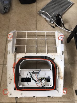

I designed a new enclosure for Trent's roof AC unit after the plastic one broke and I spent hours trying to scan it, used tons of dots and it kept getting tripped up on the grid part and losing its location and jumping back to the grid intersection it previously scanned. I understand why it could easily get confused but no matter what I did it seemed to prioritize the grid over the dots. Thinking back on it now I should have tried covering the grid so it would just scan everything else. Still though it seemed to easily lose its location in other areas and when scanning other objects too.

With the Einstar you can zoom in with the + sign on the back of the unit. That part shouldn’t have been an issue to scan even without the dots. Sometimes it’s helpful to scan as much as you can until it starts wigging out, then start another scan from a different area, trying to overlap a little with your last scan. Then continue that and use the software to merge them all together. I did that when scanning my front suspension because it didn’t like making a turn around the beams while going over top or under bottom
