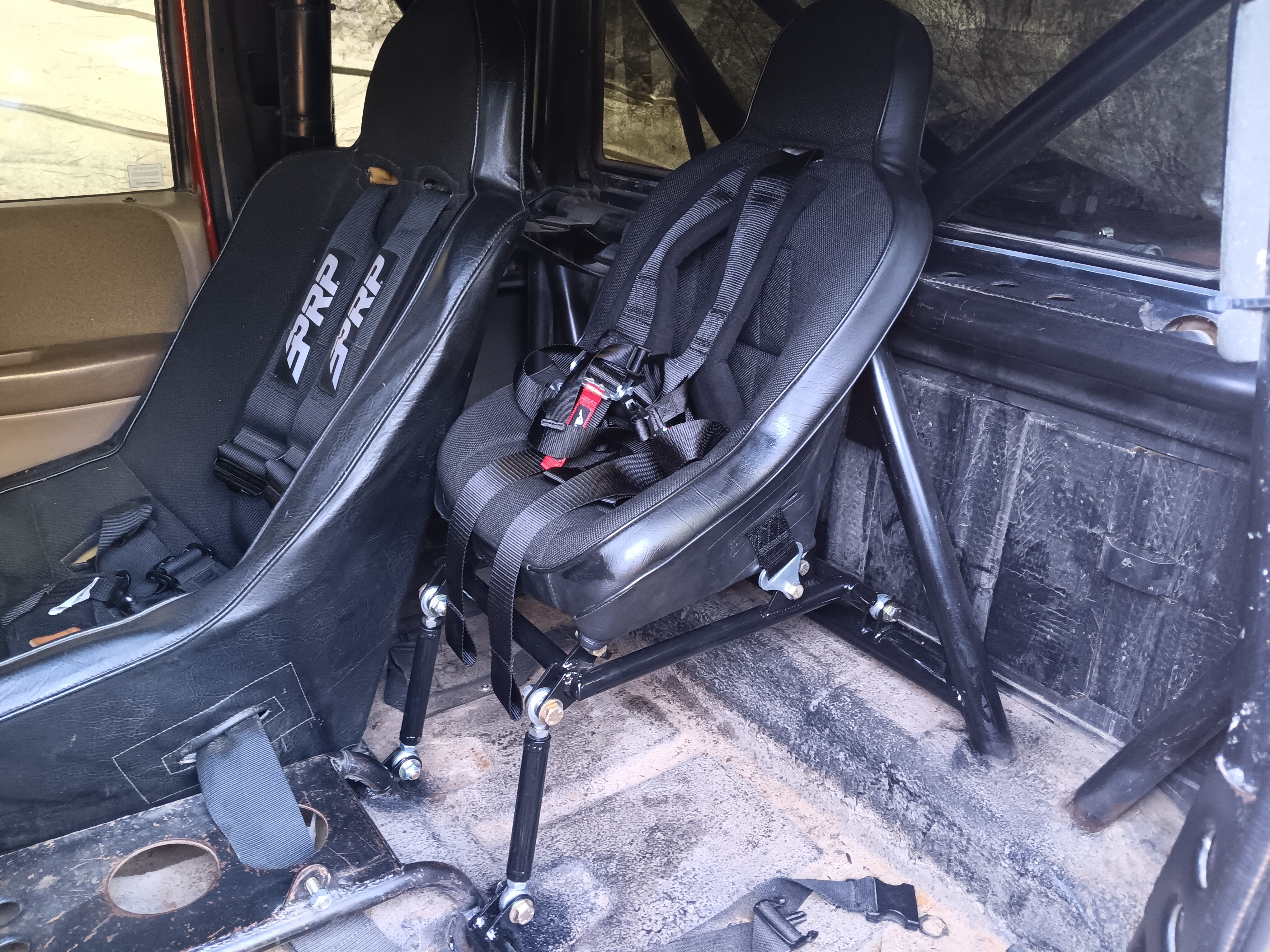

Decided I had to stuff a kid seat in there to see if I can get my little one in there. Right now she still isn't feeling it "TOO LOUD" but I have got her in it before sitting on mom's lap. So, i figure once we get her in again, she will like it.
FItting this tiny seat was still tight! Tried to make base modular so I can maybe stick it in G4 too:

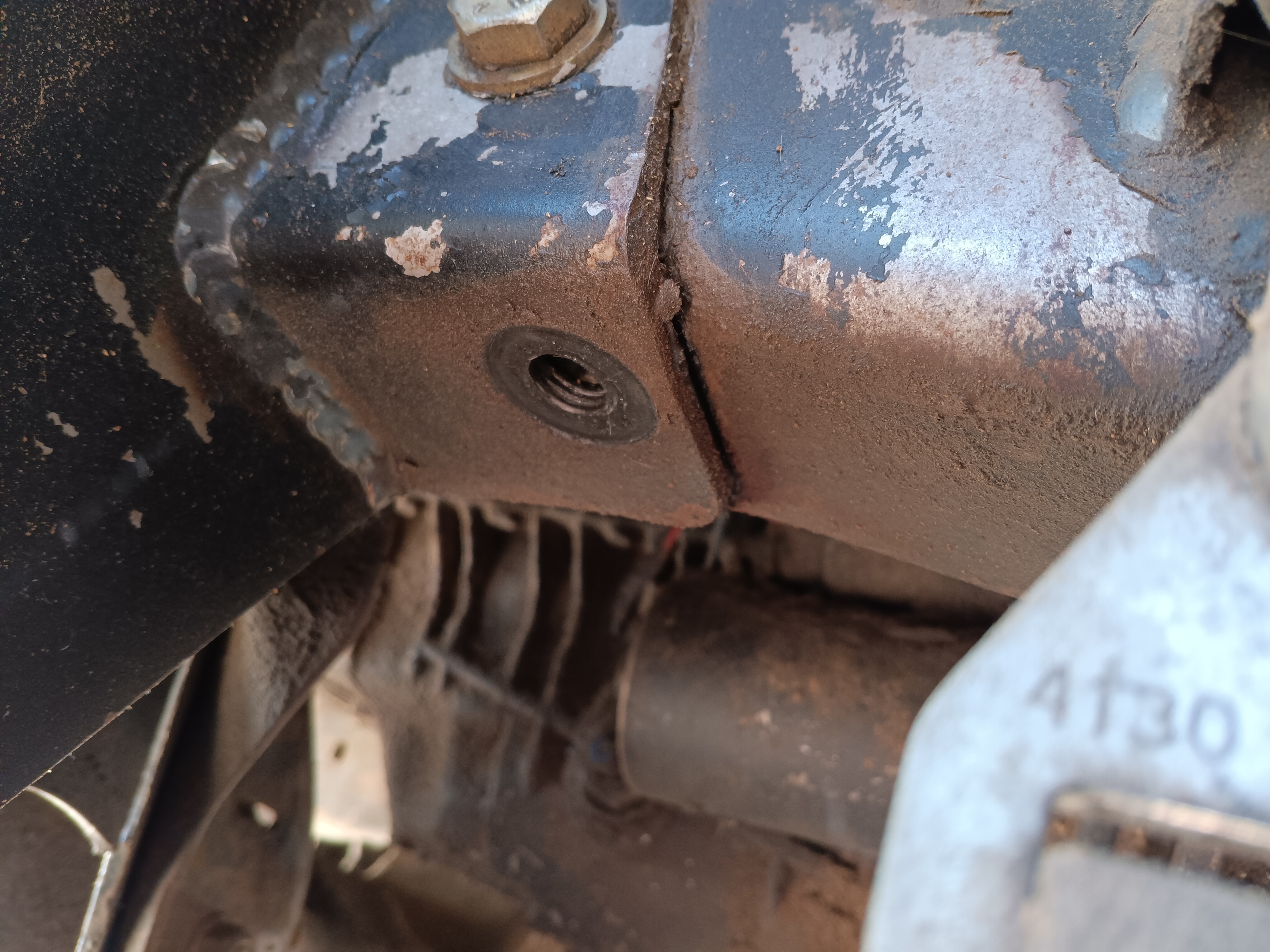

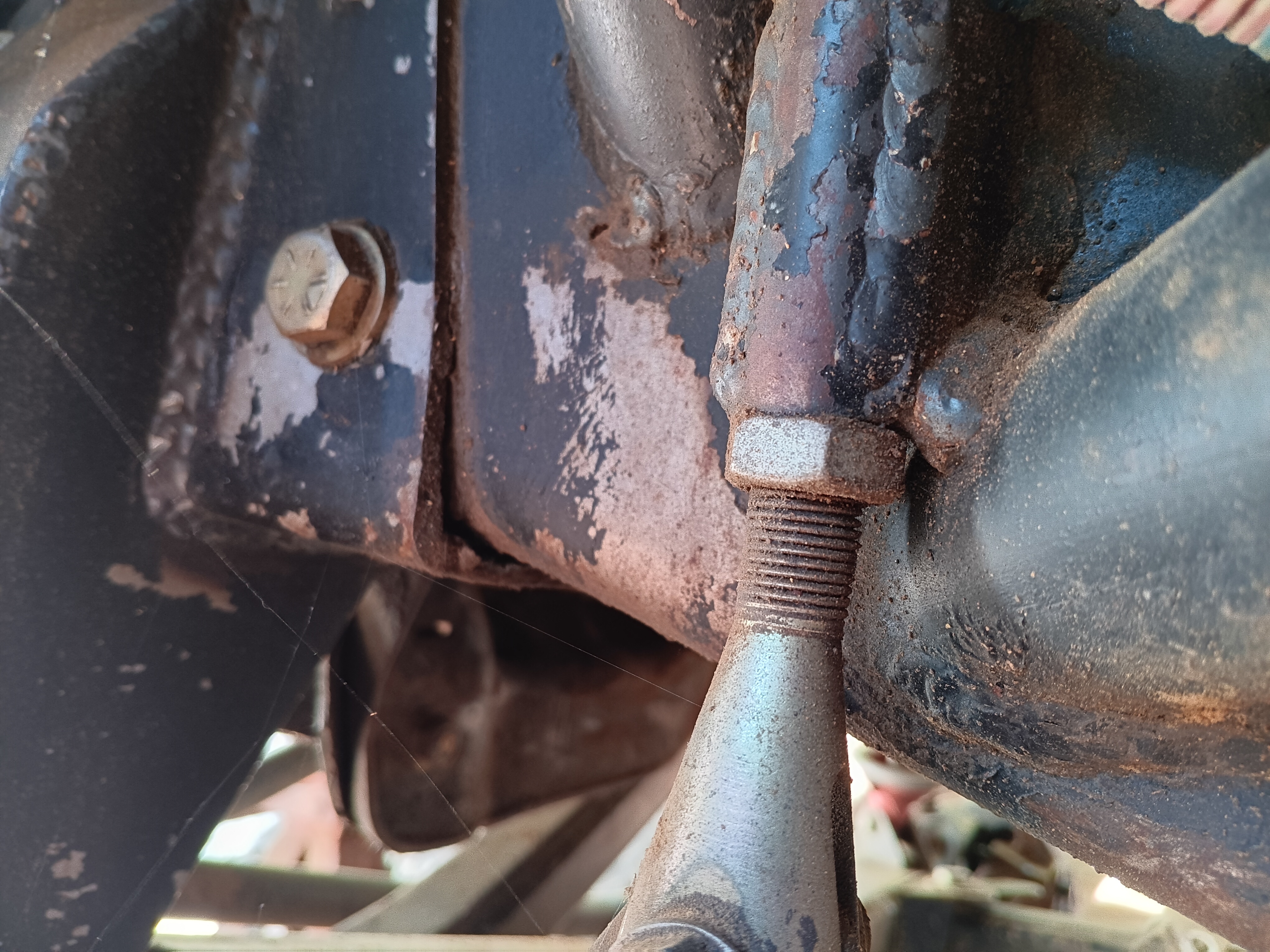

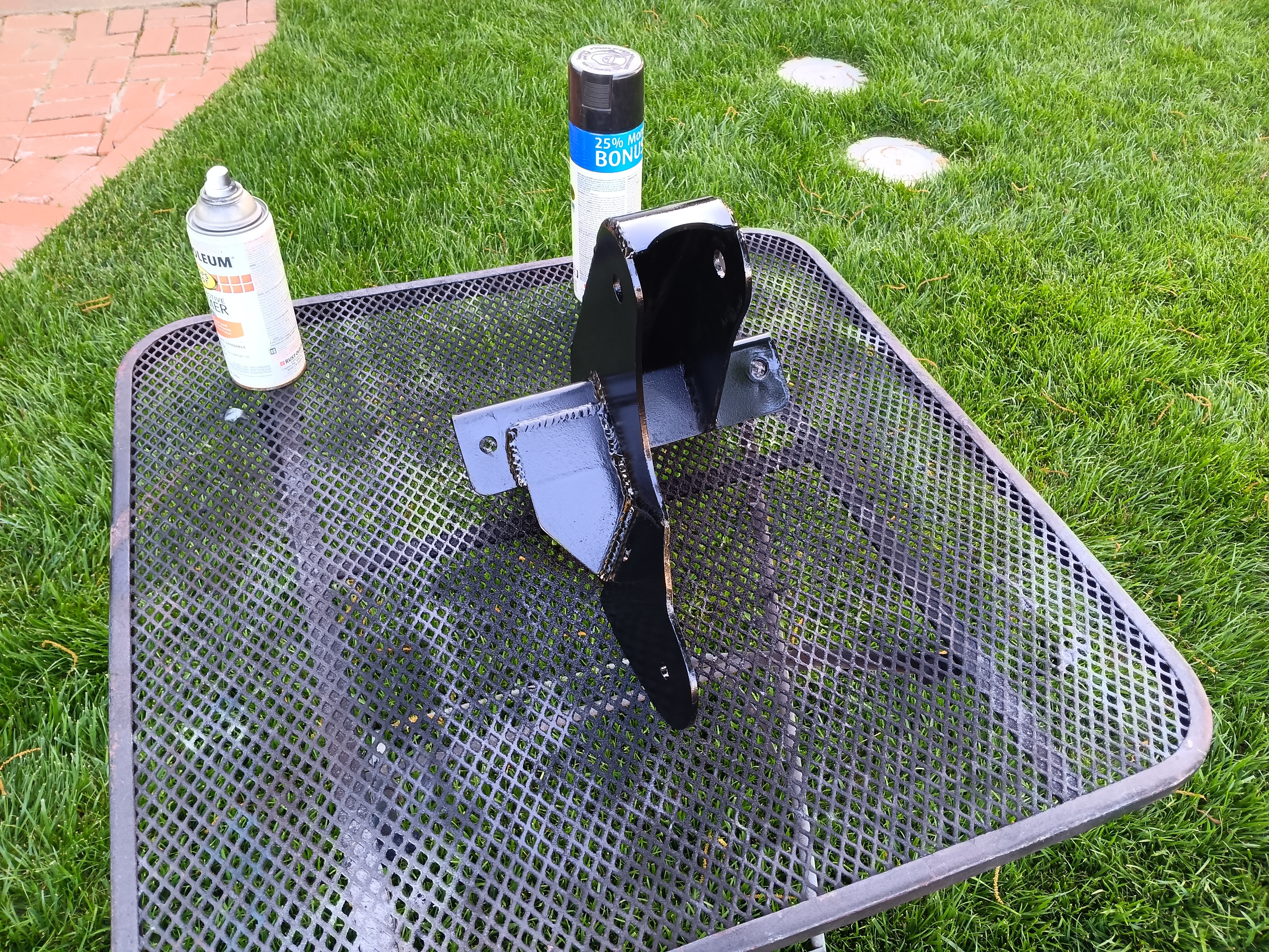

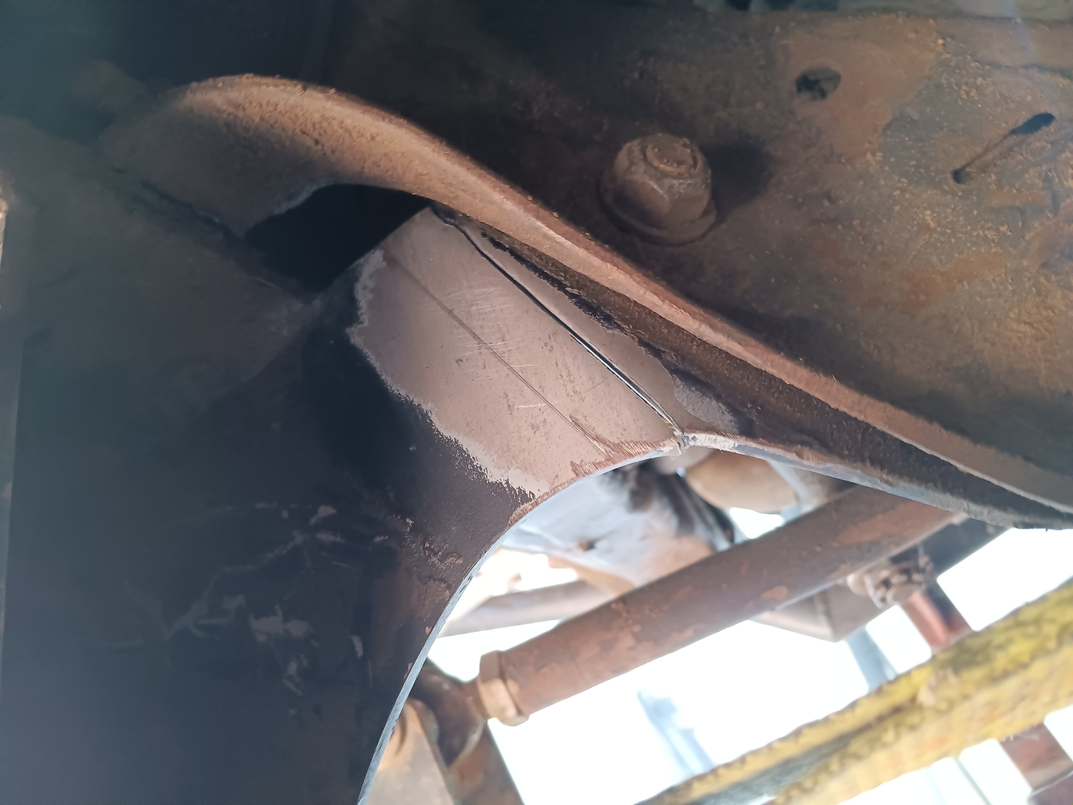

and well, the value is certainly going down for the moment. I went to check why it was towed out. And saw this! Oopsie! Threat's old beam bracket design... sheared it perfectly at the bend. I will get this fixed up and add a gusset.
https://imgbox.com/gg2AGth3

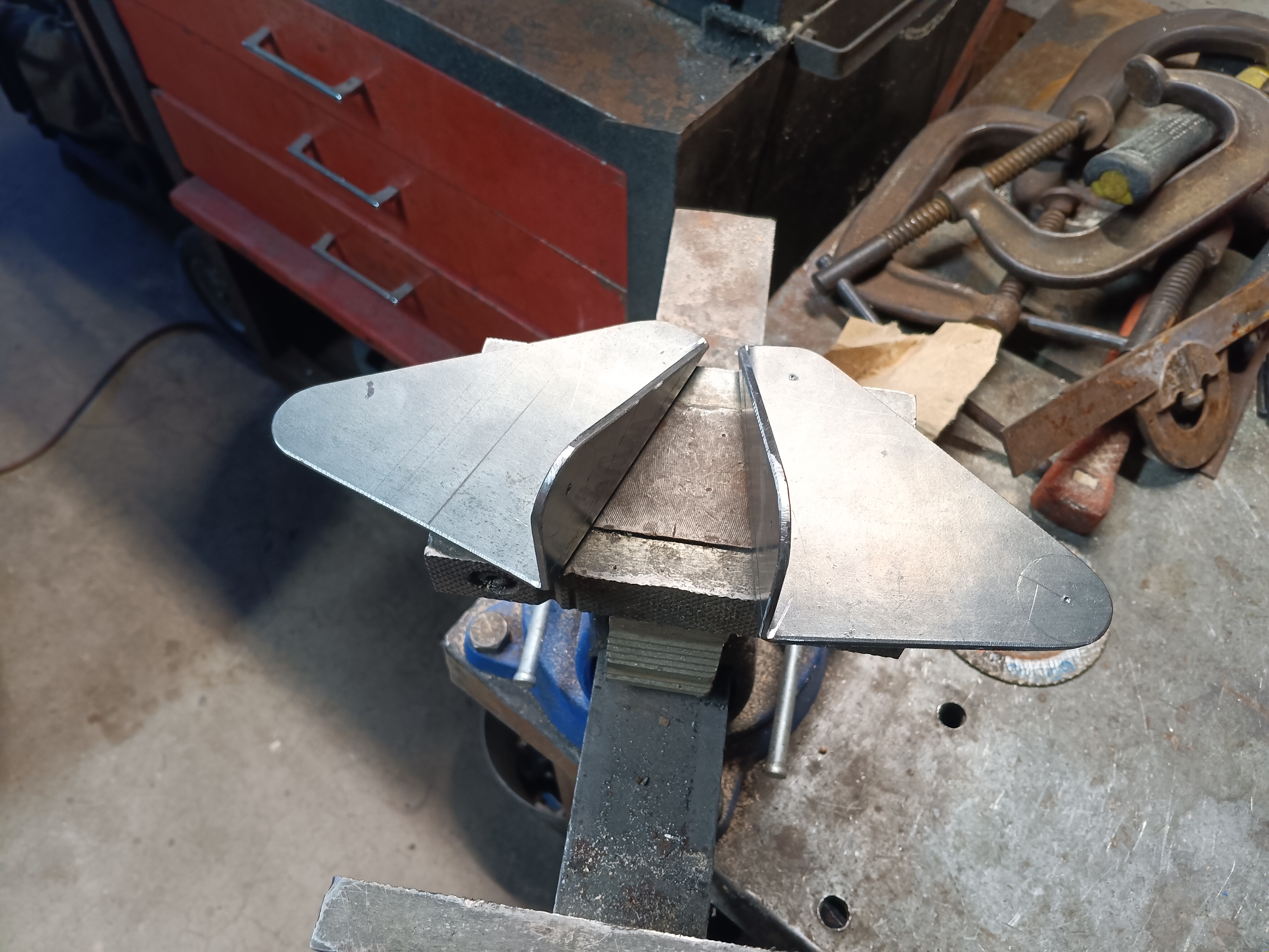

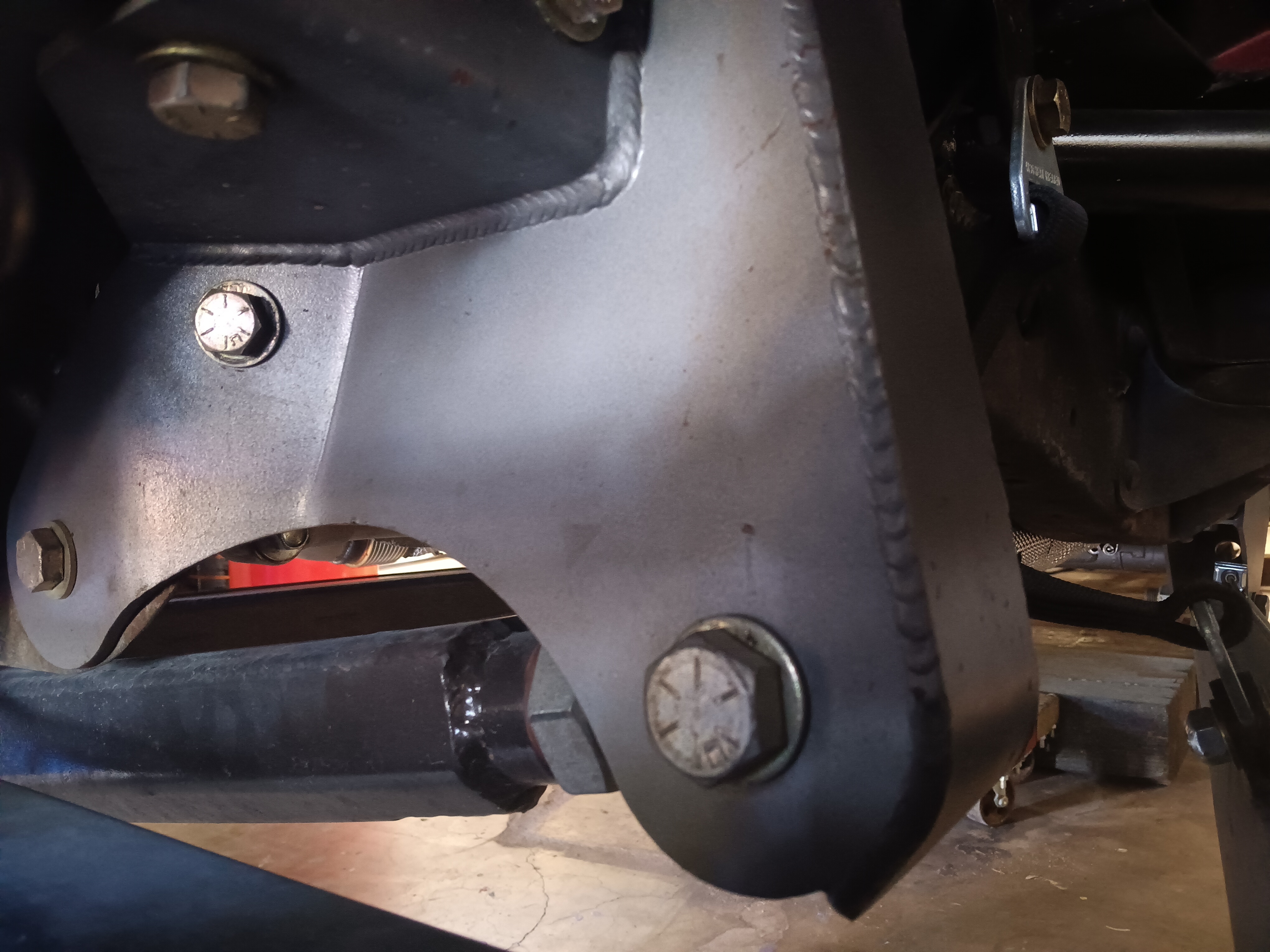

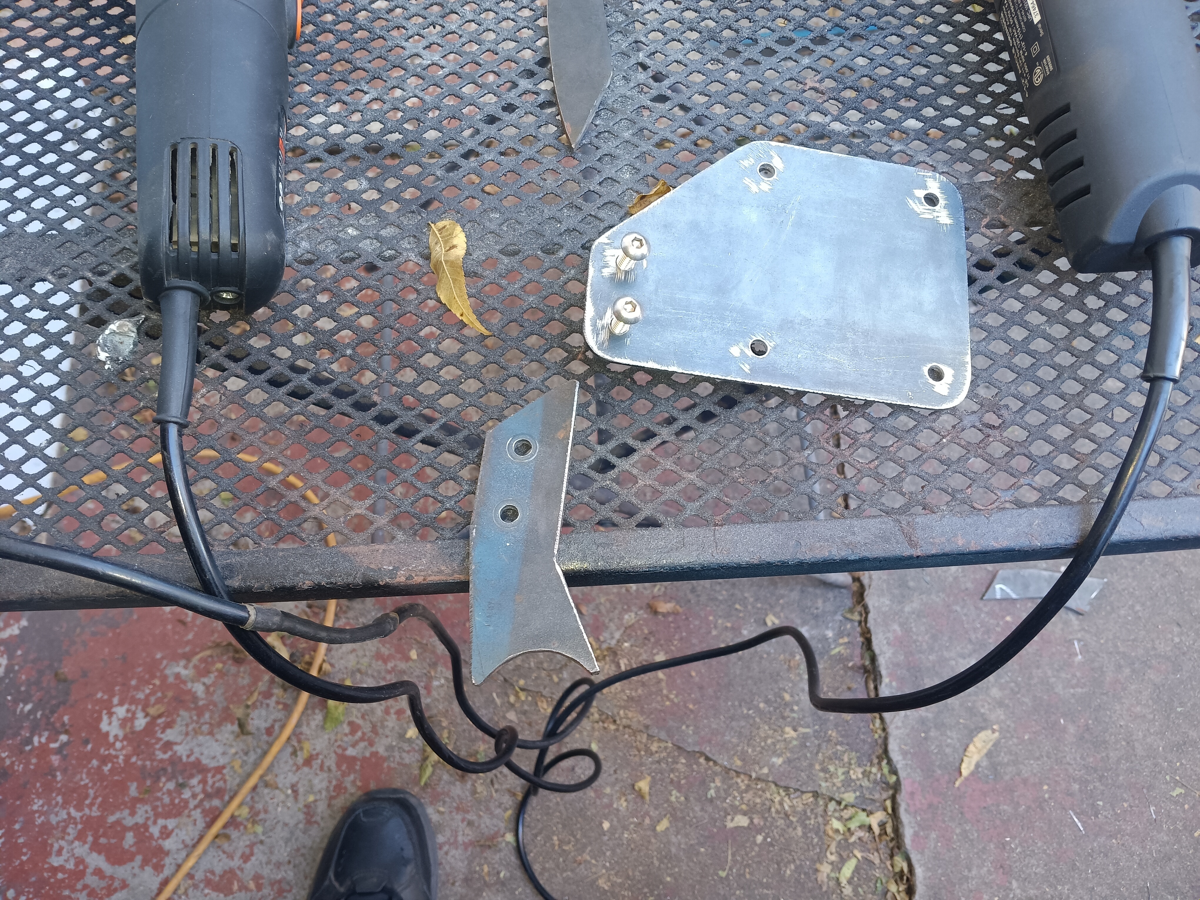

You can see difference here on G4's bracket. I will add a similar gusset and overlay the crack too probably.

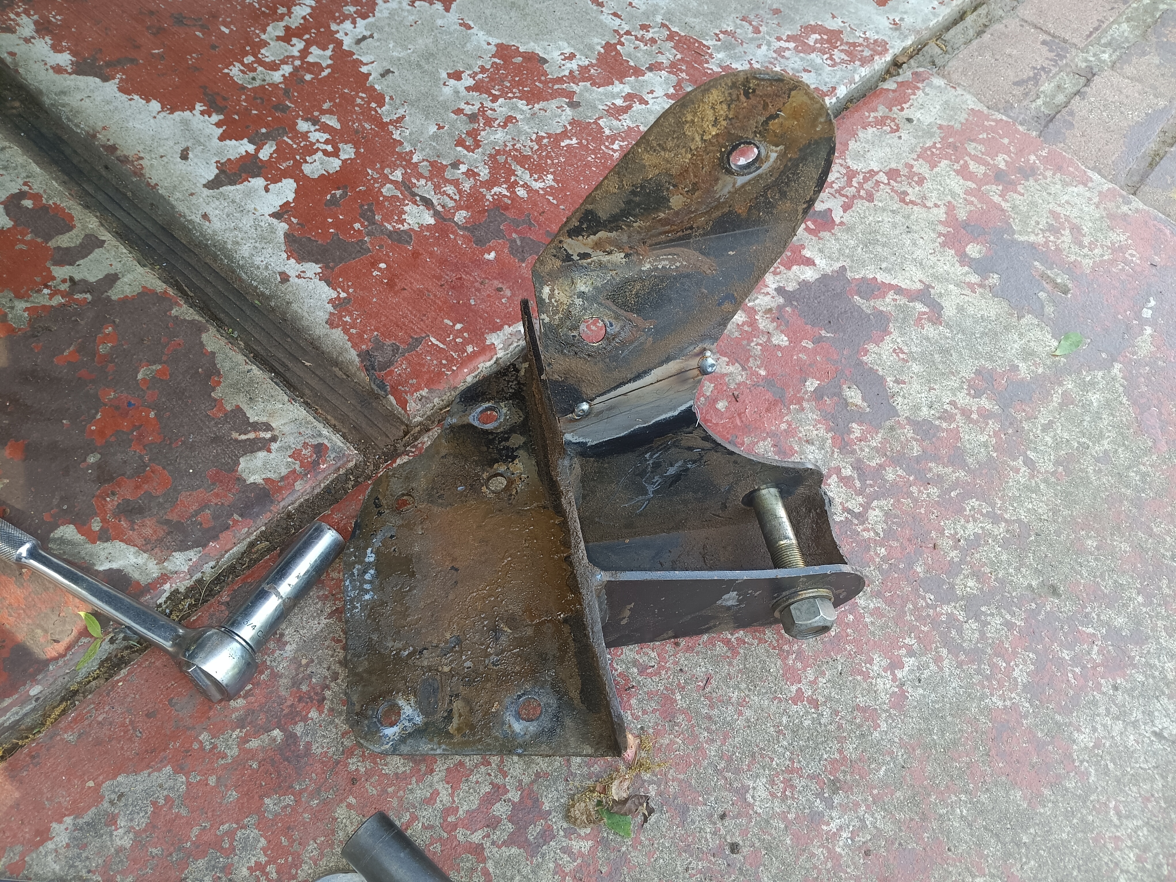

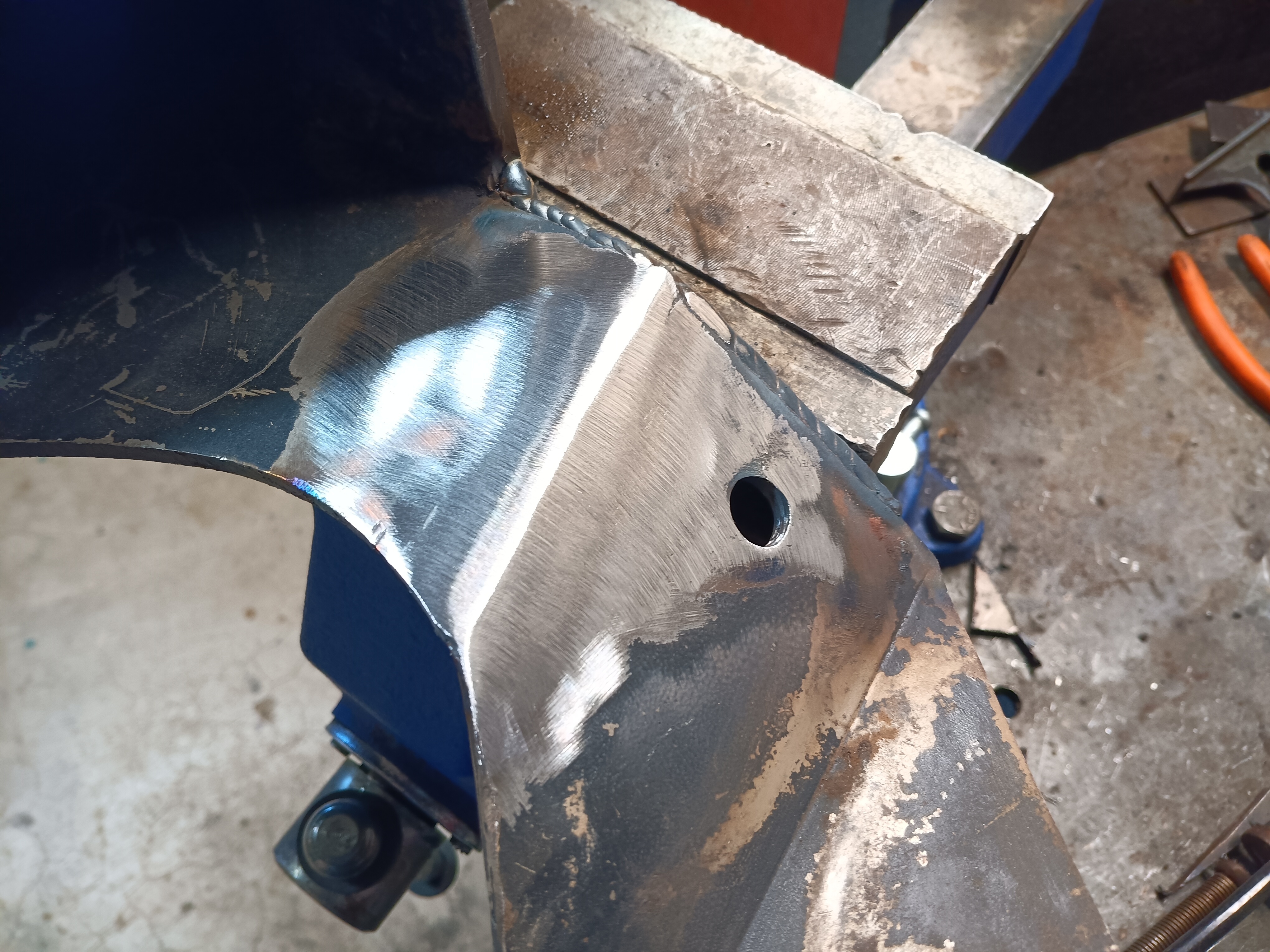

annd. Didn't take long to get it. Did most of it during lunch today. basically took off pass side lower shock mount bolts.. and got beam out of pocket. Then used my truck ratchet straps to yank it in place.. and used dowl pin in the bolt hole and twerked it over. Then tacked it with welder on 120V.
unbolted it all.... and gonna go build the gusset once i get the toddler to bed... God damn what a dirty mess under there from all the power steering jizzing over the years. And the non shanked bolt that "will never work" from 2014 or something is still perfect, as well as the hole... all while managing to rip that bracket in half. lol

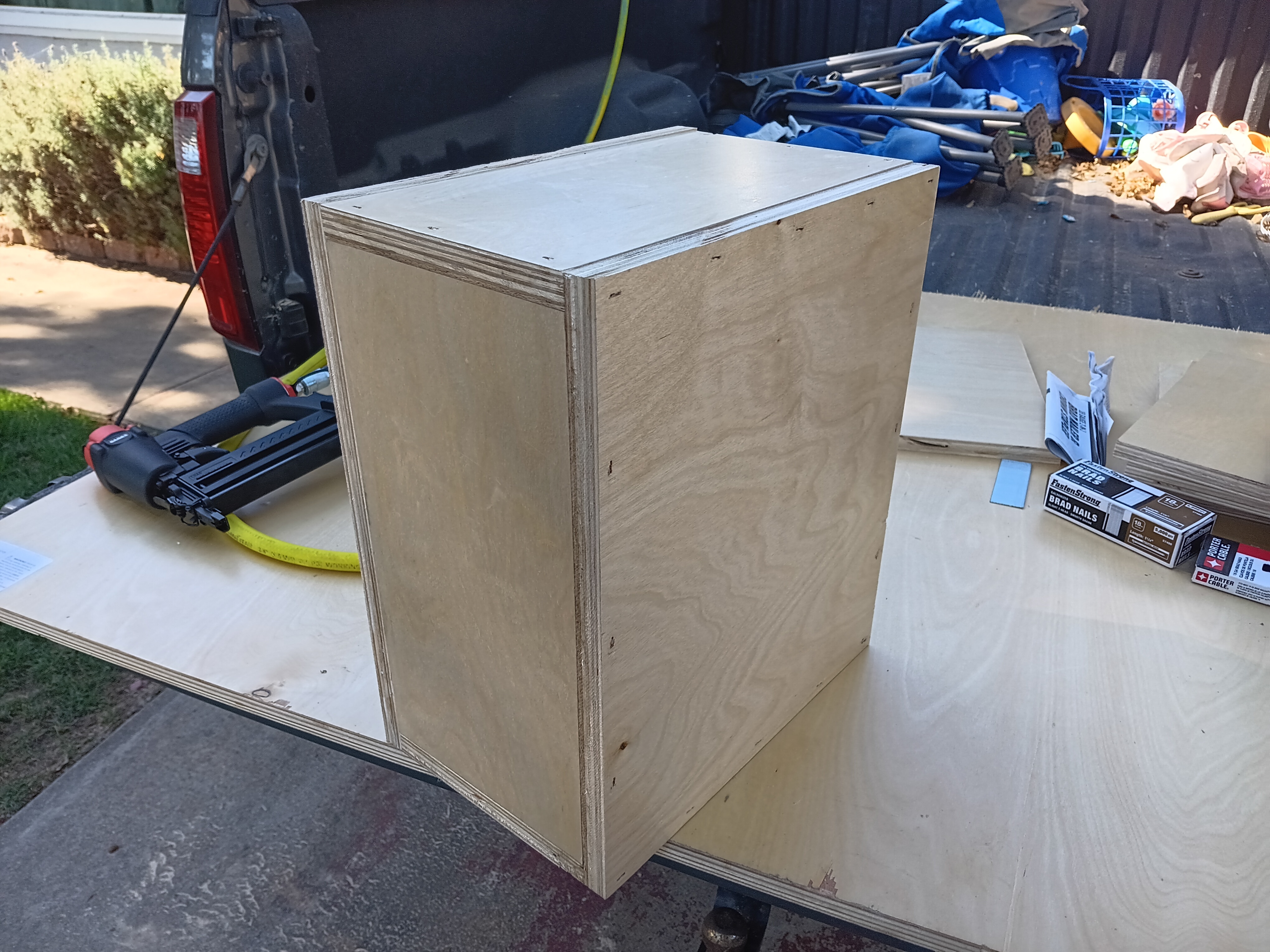

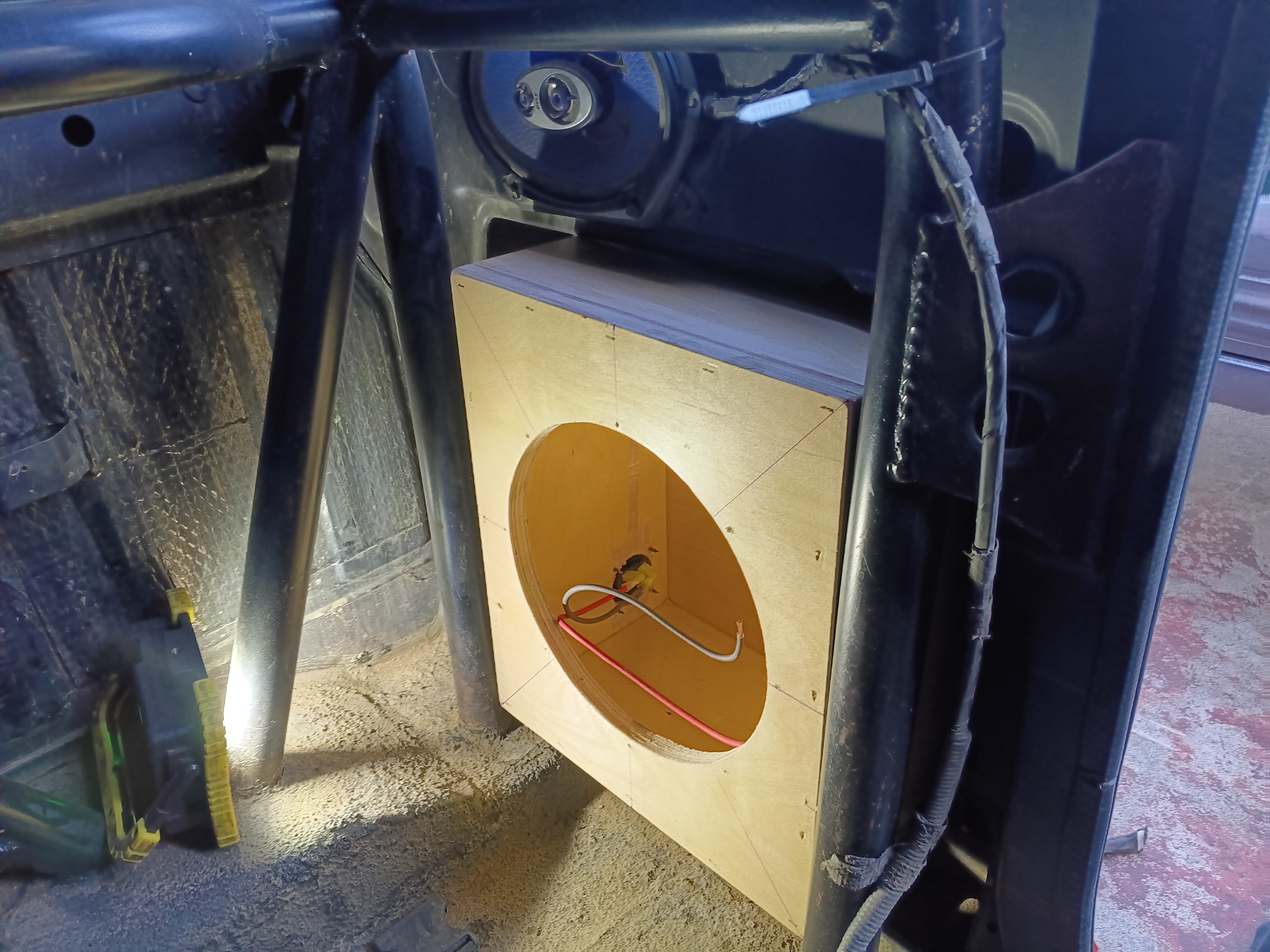

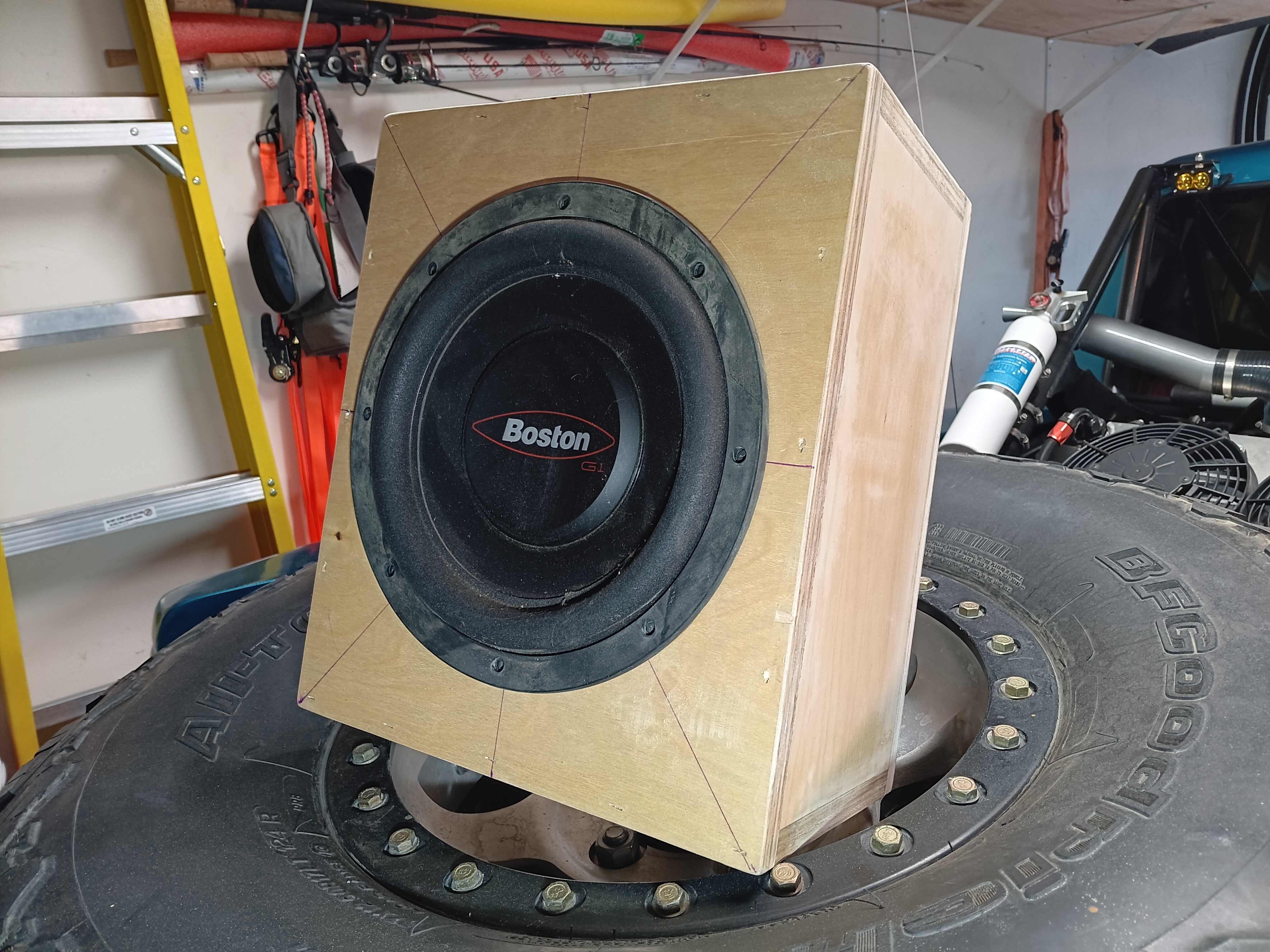

FIgured I would do some more work/upgrades to the backup pre-runner. After having a nice stereo in G4... I figured I need to put one in 2Ghetto now too. (And yet, all my DD have crappy factory stereo's. LOL)

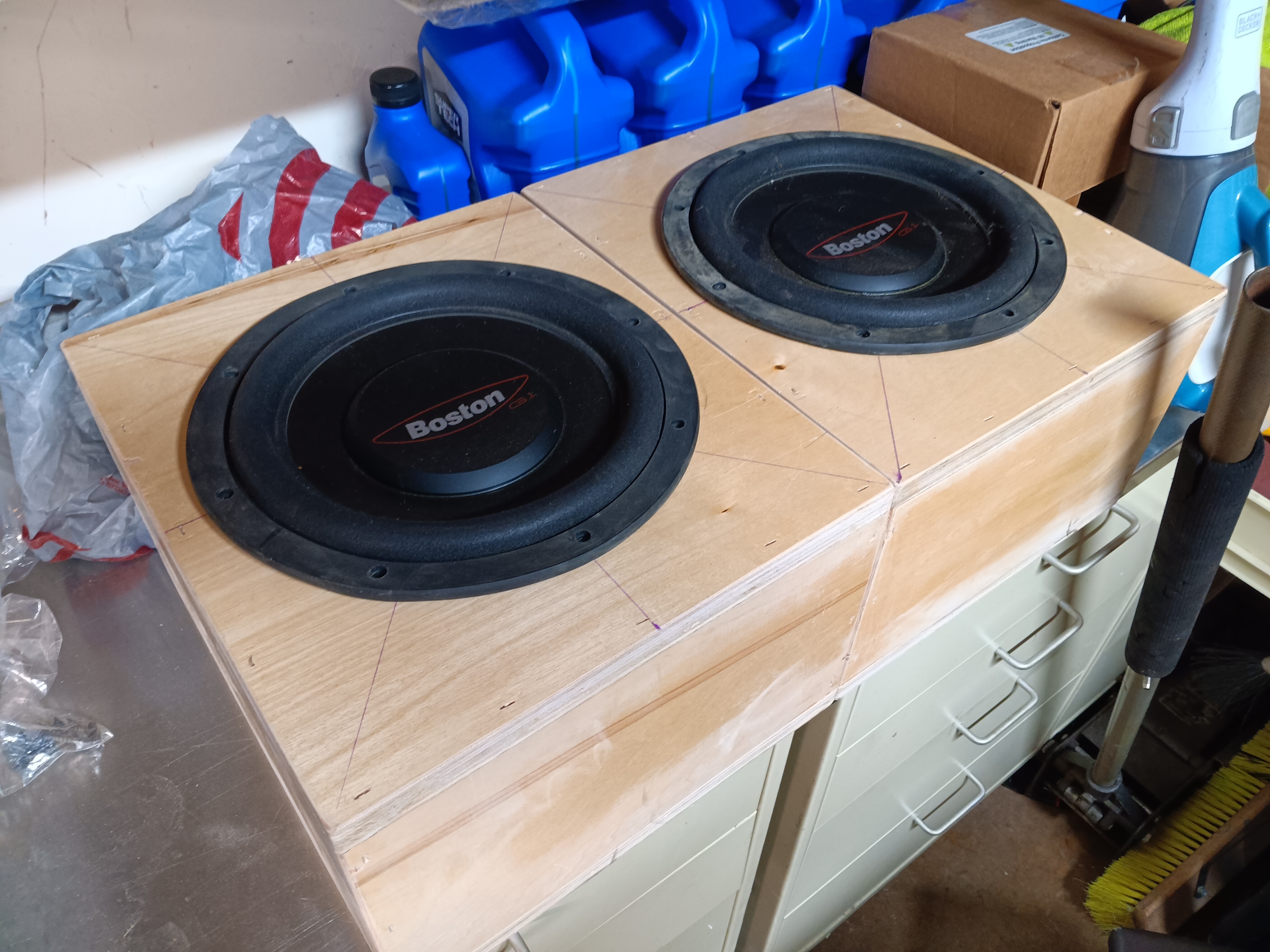

I had actually been given a couple of 10" Boston Acoustic subwoofers and an old sundown amp... So gonna use that shit. FREE FITTY!

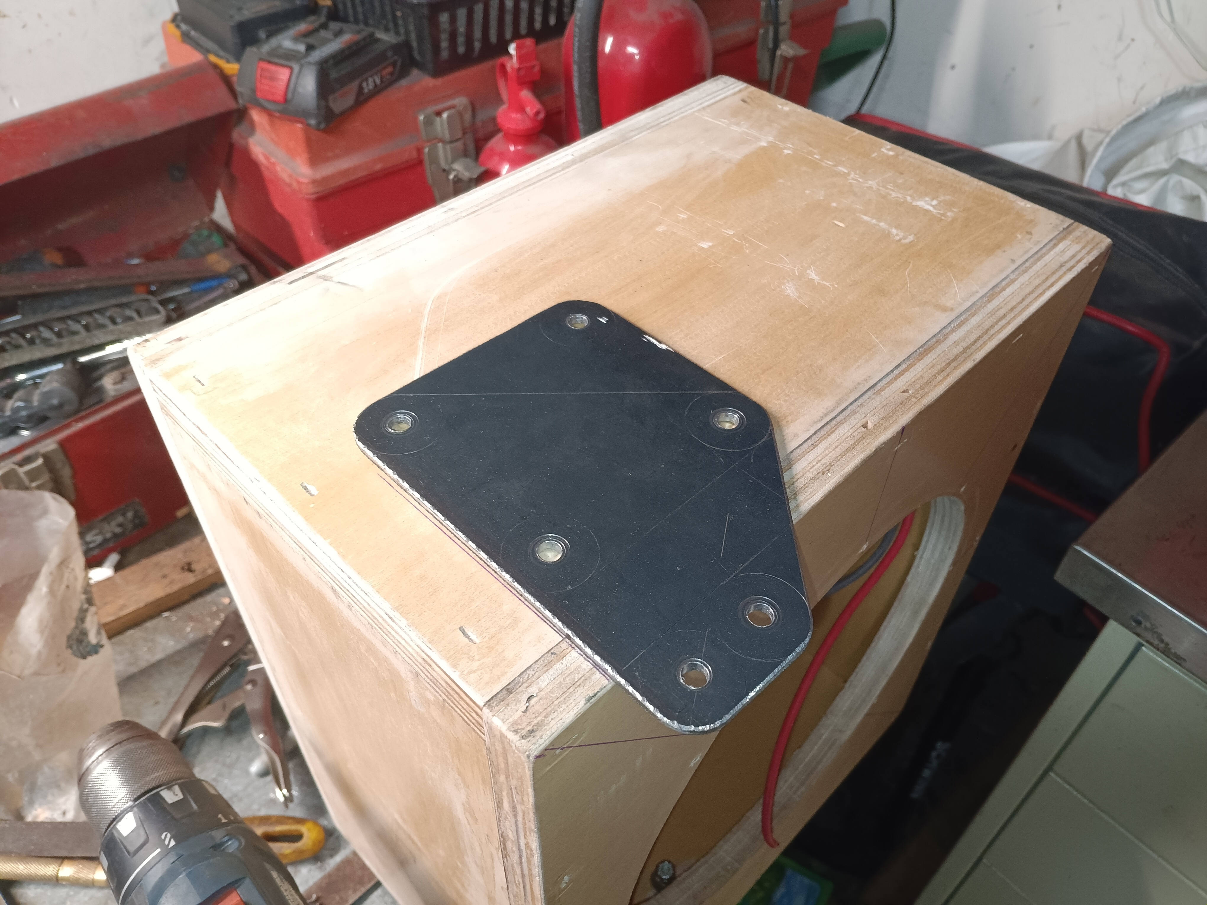

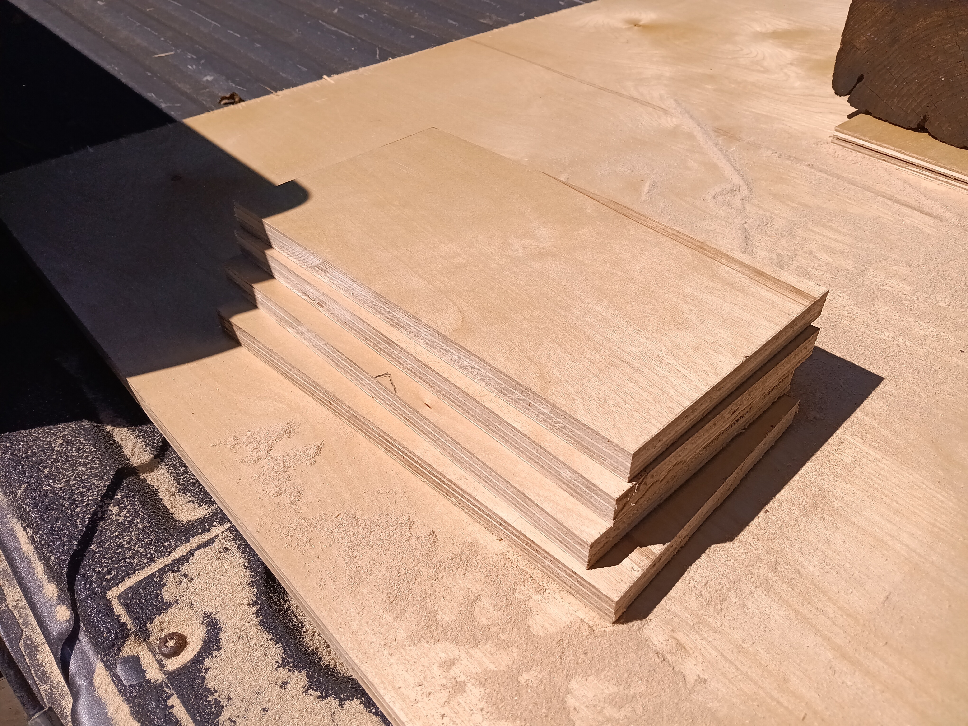

Started making the boxes:
This one part was the worst... cuts were a little off so edges arent perfect. Good thing I got a sander. LOL
Heres my donor speakers
Got about 30 mins of work done tuesday at lunch.... cut out some sheet metal in the pocket.
Boom, it fits! Gonna try to get more time on it today and get other side trimmed out and started on brackets.
