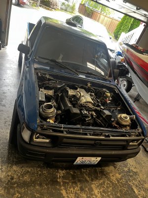

I’m doing a twin Cummins turbo non vvti 1uz swap in a 93 Toyota Pickup 2wd was wondering if anyone in here has done a 1uz swap in a 2wd yota ????

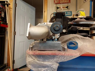

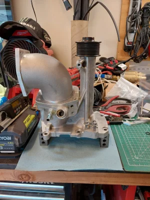

I have an early 1UZ. That intercooler manifold is the hot ticket to easy boost, should be plenty of fun. You're not helping my resistance to increased horsepower.
They make an adapter that bolts onto the lower intake manifold of the 1uz thats like $600... just saying.

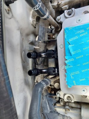

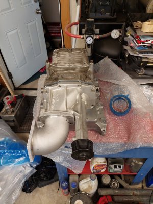

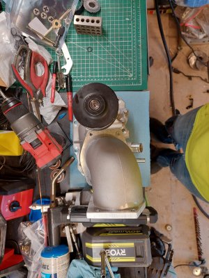

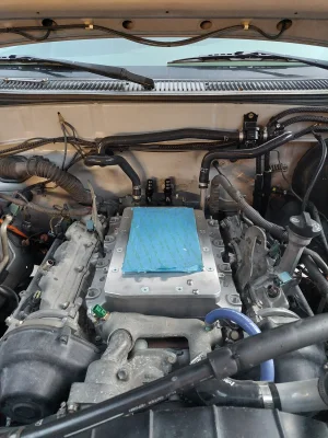

Easy is relative. I'm still ending up fabricating a bunch of little stuff the water crossover pipe at the front and throttle body mount requires modification. I also bought the wrong size intercooler heat exchanger so I need to find somewhere to stash that.
