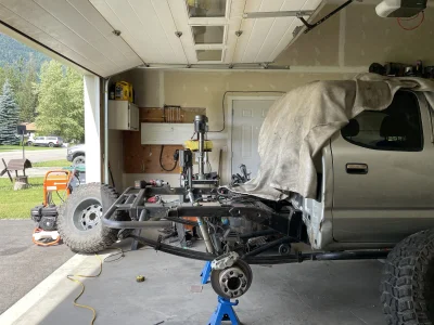

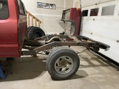

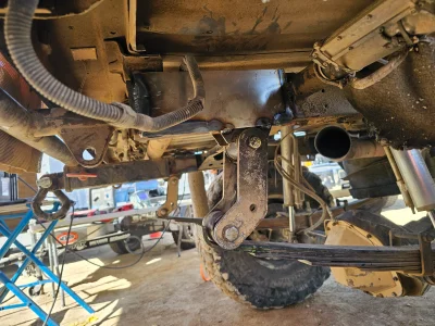

So I'm in search of any potential kits or files for boxing in the rear frame of a standard cab tacoma. I ripped off a leaf perch at KOH and patched it up but I want to now box the whole rear frame in. Would it just be better to retube the rear frame with rectangle tubing?

I don’t even try to fix/upgrade the stock frame. It’s way too easy to back half them and never think about it again
