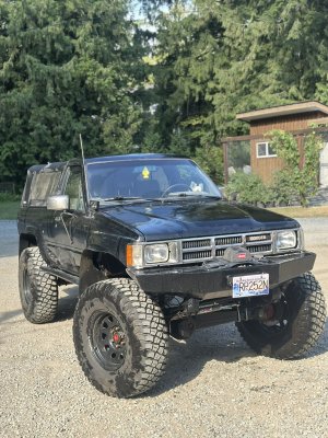

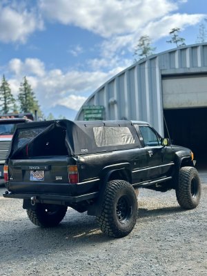

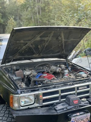

Engine:
- Toyota 3RZ-FE
- LCE Stage 1 camshafts
- LCE long-tube header
- Rear sump oil pan
- Chilkat engine mounts
- 2.5” custom stainless exhaust
Transmission & Transfer Cases:
- W56 5-speed
- New shifter bushings
- Marlin Crawler dual adapter (MC08)
- Dual 2.28:1 transfer cases
- Trail-Gear HD t-case crossmember
- Trail-Gear twin stick + boot
Steering:
- Hi-steer w/ GM ES150 tie rod ends
- PSC TC power steering pump
- PSC 1.5" x 6" hydraulic ram assist
- Tapped steering box
- Sky’s flat pitman arm
Front Axle (’85 SAS):
- 1985 solid axle swap, moved 6” forward
- Marlin knuckle gussets + diff armor
- Yukon 5.29:1 ring & pinion, 29-spline
- Triple-drilled 29-spline flange
- ARB air locker
- IFS hub swap
- V6 calipers w/ Tacoma rotors
- Long slip driveshaft (Pat’s Driveline)
Rear Axle:
- 1986+ width rear housing
- Toyota V6 E-locker, modified housing
- 1985 double cardan driveshaft
Suspension:
- Toyota 52” RUF (3rd gen pickup main leaf)
- 5” shackles (front)
- Trail-Gear 5” rear springs (bastard pack, 58”)
- 5.5” shackles (rear)
- Hangers moved
Electrical & Accessories:
- AGM main battery
- 54Ah LiFePO4 second battery
- ARB high-output air compressor
- 700W JBL amplifier
- 12” Pioneer subwoofer
- 4” Kickers, 6.5” door speakers, 6x9” Pioneers (rear)
- Aftermarket head unit
- LED headlights, interior lights, rock lights, and ditch lights
Armor & Body:
- Fractal Fabs front bumper kit
- Custom rear bumper (frame-tied)
- 4xInnovations rock sliders
- Trail-Gear transmission crossmember
- Front frame reinforcement plates
- Steering box moved forward
- 100L fuel cell (relocated)
- New rear floor pan
- Softopper
- 1” brake master cylinder
- Rear fenders clearanced 3" and tubbed
Wheels & Tires:
- 37x12.5R17 BFGoodrich KM3
- 17x9 -12 Rough Country steel wheels
- 1.5" wheel spacers
