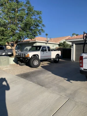

Hey guys,
I’ve been loving this forum and figured I’d share some on going with my 91 ranger.
It already had a lot of work done to it. Most of it was really good. Some was, rushed I would say and needs so attention.
It’s a 91, 3.0, 5speed.
Front has camburg 4.5over beams with camburg rad arms and engine cage, King 2.5’s and bilstein bumps. Has later model ranger spindles with the bigger brakes.
Rear had f31 deavers and a full bed cage, explorer rear end w/limited slip, disc brakes.
Cab has cage up to B pillar, tied into bed cage and frame.
How I bought it.
Plans have been focus on general maintenance/upkeep to get truck back to reliable usable form first.
I have a tendency to take a useable decent project and rip it apart and rebuild the whole car. Making them useless for a year or more which is not as fun for my kids.
Keeping this drivable while upgrading is a important.

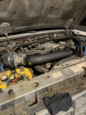

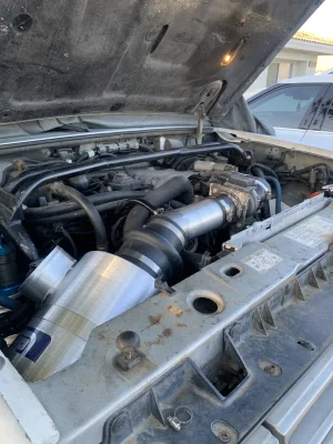

The truck passed smog but the stock air intake was toast. So I built a new intake that will work for now until the battery gets moved to the back. 333F3E59-A4C5-488F-BC22-8FD043E10EE4.jpeg
I also have been slowing fixing some of the custom wiring. I removed the Amazon lights and installed a sealth Baja designs light bar behind the grill and replaced the mechanical fan with a electric fan and shroud. Cleaned up some of the switch back and battery wiring while in there. Did some basic service to the motor while under the hood. Also relocated the charcoal canister and removed the cruise control. I am keeping all the smog stuff because they are getting pretty struck out here.

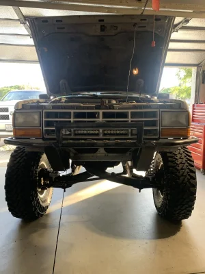

The front bumper needs some work. I like the look of it, but it need some welding help on the mounts and it’s a little crooked. I will address this when I’m doing some other fab work up front.
Any opinions on the square hoop? I’m not sure if I like it or not.

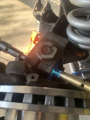

The front wheel bearings were shot and the upper clamp bolts on the beams were loose and seized in. Causing play in the upper ball joint at the beam.
Replaced all the brakes and put some time into fixing the alignment clamps. Penetrant and heat got that resolved. I have new upper and lower ball joints but these currently don’t have any play so I will do those down the road.

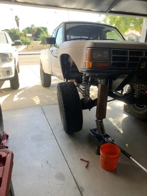

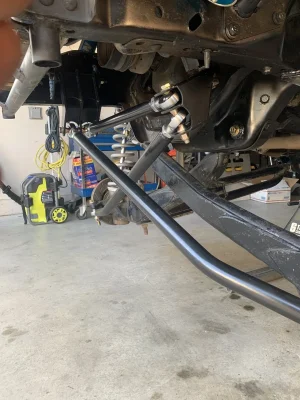

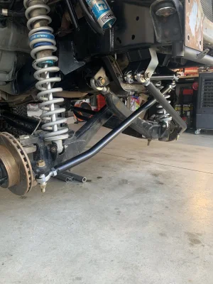

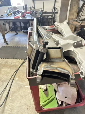

Next project on the list is the steering.CCDF2C2D-B6B9-4C43-9D5E-D2B581AF9688.jpeg
Stock steering is trash.
I’m going to be installing a Threat Motorsports single swing kit to get this under control. Also, will be rerunning the front brake lines down the rad arms. Thanks to the guys on here for input on how to do that.

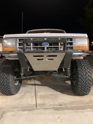

In an effort to salvage the bumper, I added a cross tube for lower support and a skid plate. Still going to pull it off and modify it. Needs a bunch of welding cleanup and repair but i think with some work it will be ok. E7A9F496-CF4C-46BE-AFC6-1AC6FCA0D0D2.jpeg

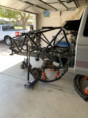

Seems like I have got a lot done since the last post.

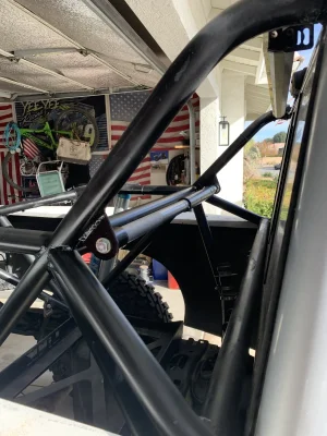

Built a new intake, relocated battery, got the swing steering done, replaced all the hiems in the front end, rewelded most of the front cage work best I could, added weld washers and new hardware for beam pivots and shocks, installed the autofab motor mounts. Currently working on the giant 64 kit, rear end truss and bypasses.
I also cut off the bumper because it was welded on like crap and I didn’t like how huge it was.
Anyone have any good examples of gutter ranger bumpers I can use for inspiration?
Thanks

Killer tuck. Looks great. Move the rear shackle back so you have to force the spring on to the shackle, that pre-load helps a lot.
I dig the Link MS sticker on the back. Brandy made my machined I-beam ends 20 years ago.
Thanks Geoff,
Appreciate your help with setting up the swinger location and spring hangers. Your the man.

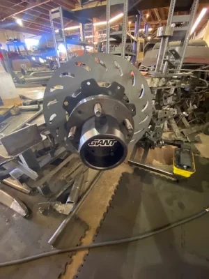

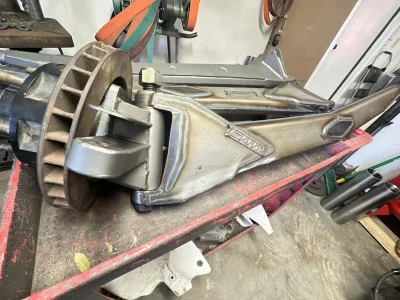

I wish giant made replacement spindles to get rid of the ball joint spindles…hint hint…

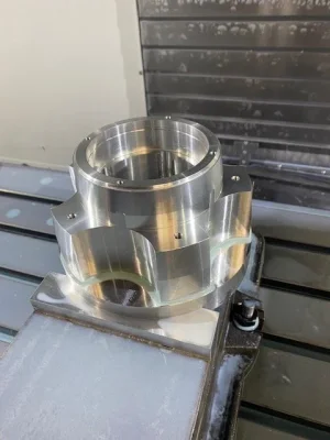

I was thinking about making a spindle like this but I would need to get 3 to 5 people interested to make it worth doing.

That looks awesome. What a killer option that would be. No more ball joints or small bearings. What kind of hub is that or would you use?
I’m in and I’ll ask around to some other guys I know with the same setup.

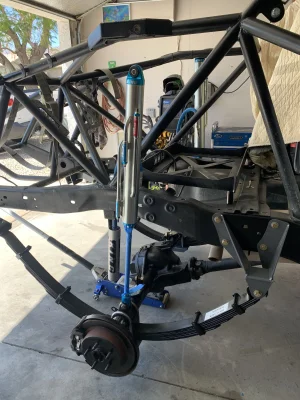

Need some input.
These are 16” fully extended, about 5 1/4” too short. The springs are set up from droop where the driveshaft isn’t strained so this would be full droop strapped.
Should I build new upper mounts that are lower and keep the 16’s
Or get 18” and limit with still 2ish inches lost?

Throw them on at an angle or do a cantilever setup.
Sean
Isn't there a cardboard trick for finding the upper shock mount?
Intersecting arcs. Leave shock mounted to lower mount only. Push suspension up to max bump and shock all the way collapsed (leave 1/2”-5/8”). Draw arc using upper mounting point while pivoting shock toward cab.
Now repeat the process all full droop/shock fully extended. Where the arcs intersect is the sweet spot where all the shock travel is used for the corresponding leaf spring wheel travel.
This is the way.
