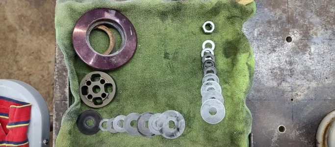

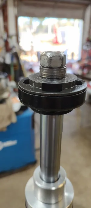

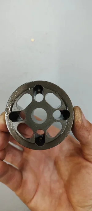

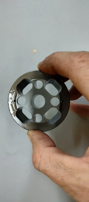

Hey I was finally able to get to work on my truck lol. Got the sizes for you and few pics

well its no wonder your bottoming out haha, that would be a good stack if you had a bypass next to it let me try to make a table on here
ADSRACINGSHOCKS
ADSRACINGSHOCKS
Compression
Diameter 0.800 0.950 1.100 1.350 1.425 1.600 1.800 1.425 1.800
Thickness 0.020 0.020 0.020 0.020 0.015 0.015 0.012 0.008 0.008
ADSRACINGSHOCKS
ADSRACINGSHOCKS
Rebound
Thickness 0.010 0.010 0.010 0.012 0.012 0.012
ADSRACINGSHOCKS
ADSRACINGSHOCKS
other things to keep in mind make sure the resi IFP oring land has no scratches in it or and oring lands for that matter, if it does have a scratch it can be buffed out with scotch brite
ADSRACINGSHOCKS
ADSRACINGSHOCKS
, run 200psi as your resi pressure at full extension and have fun, this will be a good stack for getting after it pretty good, it will be firmer than what you have now but shouldn't give up too much of the small chatter bump compliance

Awesome I'll start to get those new shims. Is the order you wrote them in the order from bottom (closet to the valve) out?
As for it having a bypass the tabs on the arms don't show any wear from one ever being there. I'm always looking for them used in my area but they sell fast.
Thanks for the info I appreciate it a bunch
ADSRACINGSHOCKS
ADSRACINGSHOCKS
the large diameter shim is against the piston on both stacks they are written smallest to biggest.
