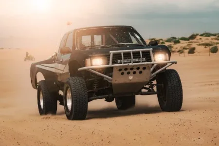

your rates sound right, do you have a picture of the truck? can you please give the following information , upper spring length, lower spring length, how much shock shaft you have showing at ride height, how far the slider/spring divider is from the lower spring at ride height.

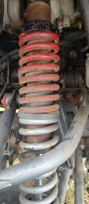

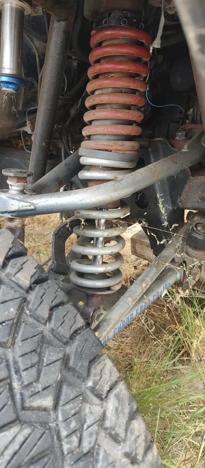

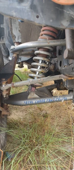

Thanks for the reply I appreciate. So here is the numbers.
Shock shaft showing at ride hight 6in
Lower spring length 12
Upper spring length 10
Spring preload lower 11 9/16
Upper preload 9 11/16
Ride hight spring length lower 9 7/8
Ride hight spring length upper 7 3/4
Slider to retainer nut at ride hight 1

Perfect, i like your spring rates and preload, your good there, i would do a progressive stack in those with a flutter, the only question we need answered is what piston you have and how many bleed holes and what size they have in them, i dont like the fox chart for valving its more complicated than they show a bleed changes a force curve so much can you pop one open and see what you have right now?

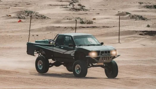

The first time I had the truck out the rear was harsh and needed adjusted. So I did research and found i needed more rear weight so I added a 32 gal cell plus left the stock 15 gal tank for smoging the next trip it was better but
prerantaco
prerantaco
needed to turn tubes that's when it was working well in the rear but front was bottoming out and not keeping up. We've been doing tests on Barstow main and the road next to outlet center Dr near Barstow main if you know that area.

main has some big holes, and watch for the hidden rock haha, weight is a big deal in any truck, imagine riding a motorcycle on the handle bars thats what a stock truck is, everything is in the front, getting weight bias towards the back is a huge improvement, finding a balance of up travel and weight is tricky on leaf springs but not impossible
