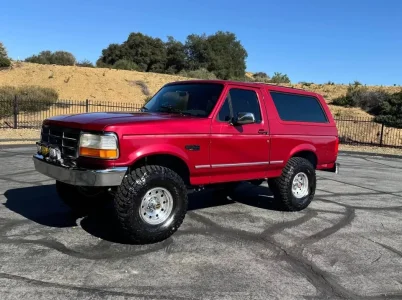

Old and sold:

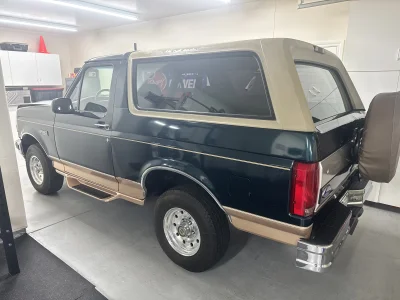

New hotness:
Plans include keeping this a stock width caged and capable ride offroad and comfortable to drive on the freeway. i want to keep as much exterior and interior parts and appearance to stock.

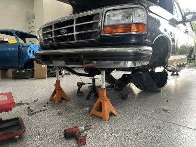

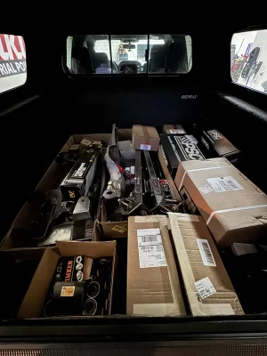

It is currently with a builder in town and he is kicking ass. So far I have a few cleanup items knocked out (oil leak, remove a shitty alarm install, wire wheel the frame, remove ABS, Remove SMOG, etc). I have been spending a lot of my time begging shops to let me give them money for parts, but there has recently been some movement on that front.

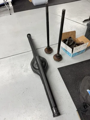

Ford 9" Rear End
4:88 Gears

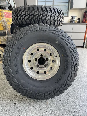

35" Tires

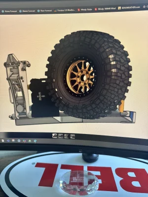

Tire Carrier Bumper (if I ever get it :rolleyes:)

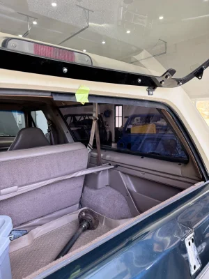

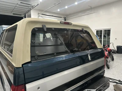

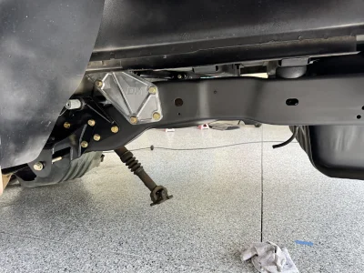

Some of the smaller things that we could check off include the rear hangers and sway bar install, skid plate and bumper, and the rear window.
Rear window is really badass. My old ride was always a leaky, slow, heavy, noisy pain in the ass. Hoping I can eliminate all those problems with the hatch.

What's the info on the rear window? I've been looking to do the same
Also interested on the info and where to get it
Awesome build and plans. Dig the window too. Best I've seen yet. Struggle with the rear roll up is real.
Vildosola's prep guy makes them. His name is steve lewis.
I had a friend get in touch with him and order one, so he ordered for me too. The only way i know to get in touch with him is on instagram. @bajachaser
Looks like @badlinesgoodtimes did a feature on his bronco at their shop
Really good looking setup and looks simple plus I’m surprised my back window hasn’t broke from the beating so might as well replace it before it happens I don’t have an instagram so I’ll have to figure that part out
