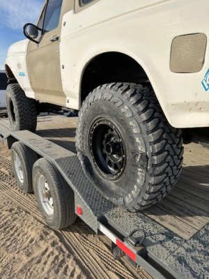

Not sure this is where I should post this, but I figured tire psi will affect shock tuning. What’s everyone run for pressure? Seems like back in the day everyone would say air down. Now it seems not so much to tune the shocks for smaller stuff. When I took my truck out for the first time I was running 18psi. Then I hit a rock and got a sidewall puncture. My tire guy said I should’ve been more around 25, 22 at the very least. So what’s everyone opinion and what do you run?
