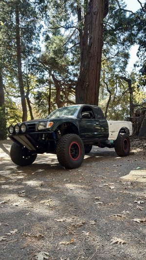

Picked up a 1999 Toyota Prerunner last weekend from a buddy. I don’t know a lot of the backstory on it, but I do know it was built by an employee at Dirt Designs out of Paso. The truck is TIG-welded bumper to bumper and all chromoly tubing. My buddy bought it, drove it three times in the dunes, then COVID happened and it’s been sitting on the side of his yard in Pismo Beach, so it got pretty weathered from the salt.
It’s got a TRD supercharger with a URD lightweight crank pulley, LCE supercharger pulley, and I was told the timing belt was done. Moving to the interior, it has carpet, A/C, heater, manual trans with manual 4WD, radio, PCI radio and intercom. All the headlights, dash lights, and blinkers work like normal, and the cage work is really clean considering how much OEM interior is still in it.
Each corner has King 2.5 coilovers, bypasses, and bumps. Up front is a custom long-travel kit (assuming Dirt Designs). Out back it has a custom fuel cell using the OEM fuel pump, 3-linked, Cone Industries sway bar, full-float rear, 2.5 hubs, and the bedsides are a little beat up.
Overall, the truck has great bones. Most of the work is just going to be prep, Scotch-Brite, and a few late nights. Goal is to have it back in the dirt by Halloween.
Bonus: the truck came with a DH mountain bike, a trailer, spare wheels and tires, and a pile of other solid parts.
Not sure on the plan yet. Might keep it, might fix it up and sell it. Raffle it off? Either way, I’ll give it the same attention to detail my Ford Ranger gets and have it dialed.

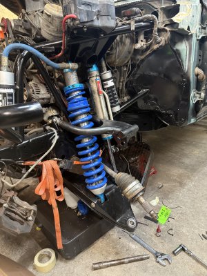

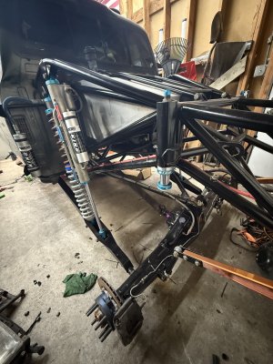

Got all the suspension pulled off, inspected, and ready to head out for sandblasting next week. I’m skipping powder coat this round, never been a fan since it hides cracks and makes upgrades a pain later. Going to hit everything with primer and spray it with paint out of a gun instead. Curious to see how it holds up that way.

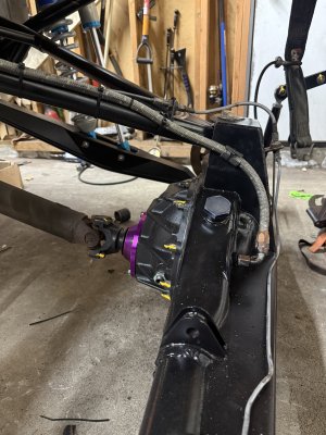

The 3rd member’s out too. Getting rebuilt with 4.88 gears so the front and rear match. It’s got a Detroit locker, ARP hardware, and a Strange case, but I’m debating swapping the locker for a spool.

Next up on the list: sandblast, prime, and paint all the parts, replace the driver-side wheel bearing, install the 4.88s, paint the cage, replace a few uniballs, hang the suspension, mock up the 37s, bolt on the shocks, then spin the truck around and pull the motor.

The cage is pretty rusted and its tight up agent the motor so it would be hard to paint. Just want to do it right. pulling the motor would allow me to paint everything correctly. I know, sounds stupid.
