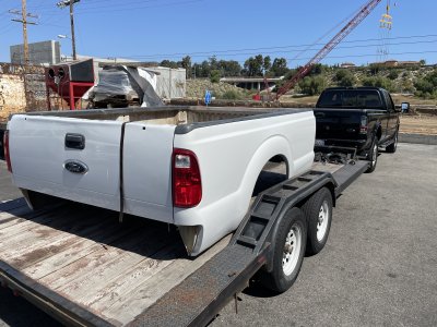

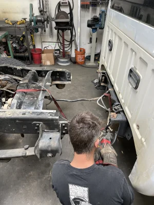

To Get the factory f250 short bed to fit properly Mikey had to cut 16" out of the factory frame right behind there cab . This process was pretty straight forward , just glue the frame back together , make a new front fuel tank mount and add a shorter driveline .
surprisingly it took a good while to find a clean super duty shorted but one finally popped up about 2 hours away and I snagged it .

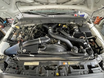

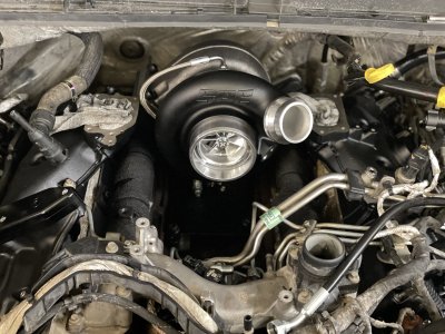

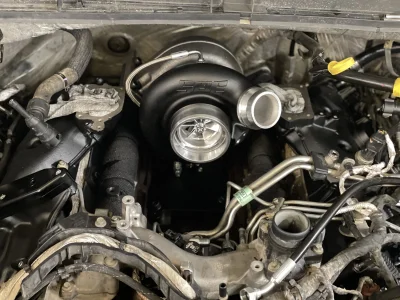

at the same time Mikey was cutting the frame , Jesse was installing the new SPE 70mm turbo and larger injection pump . this combo is good for about 700-750whp but its currently on a very mild tune , the power threshold of a factory early 6.7 powerstroke us around 700whp or the rods will likely turn to spaghetti with too much boost pressure , so were going to keep the truck at the 600whp mark until I have there opportunity to build a stronger rotating assembly . I also took the time to Powdercoat the turbo and all of the charge pipes satin black to help maintain the factory look .

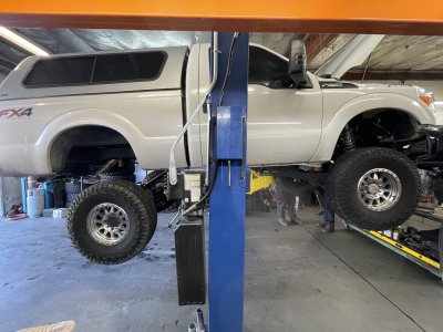

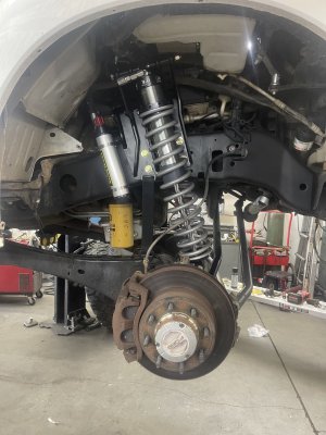

we landed on a custom length 3.0 coil over in the front with a repositioned Carli tower to fit the longer than standard Carli coil over set up . With this front configuration were able to cleanly cycle 14" of travel which we were more than satisfied with being a solid axle truck .

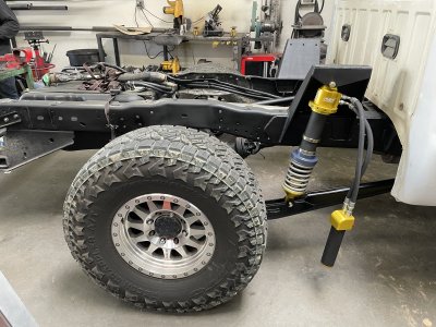

The rear was definitely more involved , originally we were going to keep it simple with a Deaver set up but do to lead times we were "forced" to link it to meet our KOH deadline ( at least thats what we told the wife ><) ...
Im going to break this part down pretty quickly ..
After Mikey did all his math on anti dive , anti squat , spring rate , ehicle weight , blah blah blah we finally started cutting into the rear again .

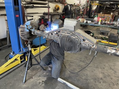

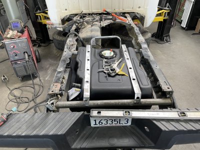

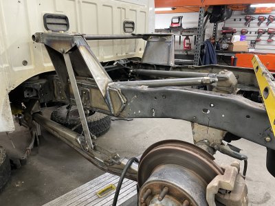

I believe we landed on a 48" rough stuff trailing arm link with triangulated upper links , with slightly less than a 2:1 shock ratio (I might be wrong so Mikey can correct me ) , a 550lb single rate spring for the time being and ADS 3.0 MBR internal bi pass coil over . to get the upper wings to work we had to replace and relocate the factory fuel tank . luckily we were able to make an after market cab and chassis f450 40 gallon fuel tank work . was pretty much plug and play with the fuel sending unit. Mikey decided to do plate style upper shock mounts which turned to be super clean and beef .
with the rear set up complete it was time too check the travel numbers and we were stoked . Initially the truck cycled 25" in the rear but after getting the new driveline installed and seeing there aggressive u joint angle we decided to strap it at a safe 21" of travel , still plenty of travel for this big pig..

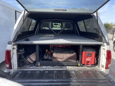

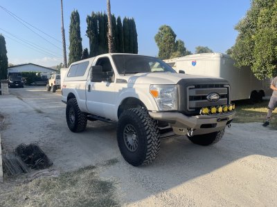

the next stages were building a fabricated bed platform , pullout drawer for camping and tool storage , obviously it needed 40"s and some indestructible bumpers from Todd at mercenary Offroad ..
Although this is the current stage of the truck its definitely not its final stage , with the ever growing weight the truck we are constantly making adjustments to counter . But yet another stage of parts is being collected and hopefully she'll have a more refined set up in the next coming months.
