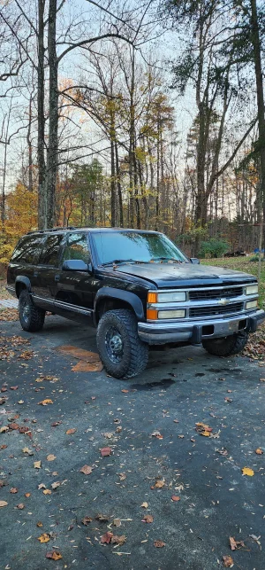

Started with a stock 95 2500 Suburban 6.5 turbo diesel.
It had some issues mainly just from sitting for about 5 years. Leaking power steering cooler, fuel lines, brake lines, basic gmt400 things.
Bought it and pretty much instantly tore it apart.

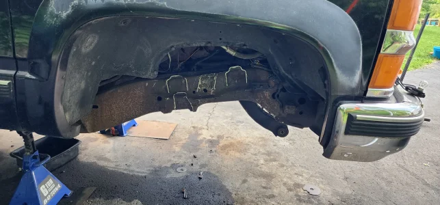

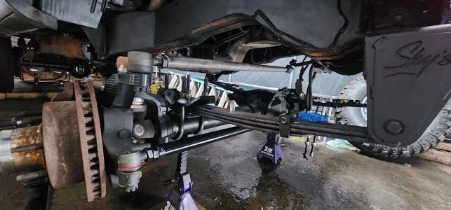

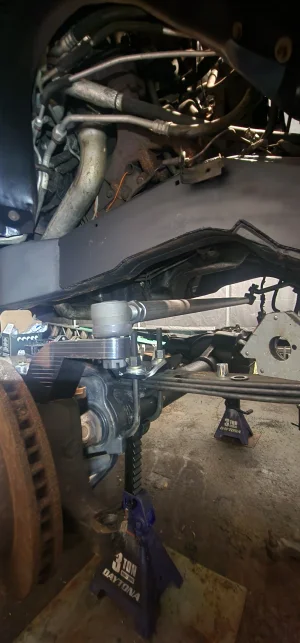

Ripped the IFS off the front. Severely underestimated the amount of grinding that would be involved.
Got frame reinforcement plates in and hanger setup installed. Running Ford 2.5in lift leafs from BDS. Hanger kit is the Skys 99 to 04 Dana 60 kit.

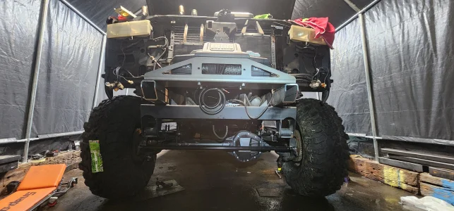

Rear suspension is all ORD. Shackle Flip and long travel Shackle. And a drop bracket on stock leaf springs.
Axles are a 2003 Superduty Dana 60 5.13 gears and a Detroit locker.
Rear is the factory 14 full float. 5.13 gears and a spool.

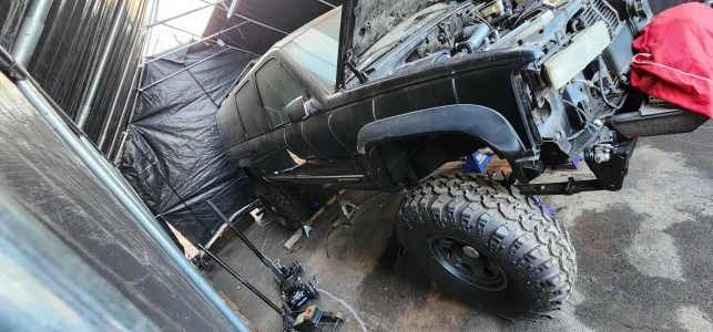

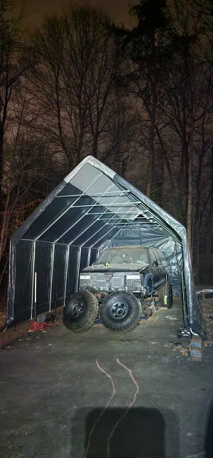

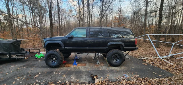

Running 39.5 swamper Iroks on 17in methods. (Snow storm destroyed my cheap carport hence the pile of poles)
Front sits a little high but still have a bumper to build and will be putting fresh rear springs soon.
Been getting the steering and some other things figured out recently. Still need to order driveshafts which is my current dilemma. Front shaft seems like it's going to be a pain to figure out.
Been getting a front bumper mocked up

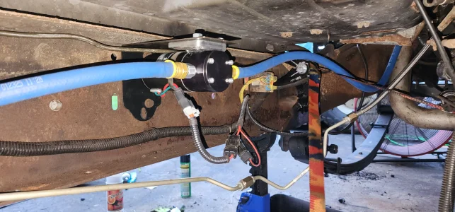

Intake setup. New intake pipe. Lots of parts from leroy diesel. Fass lift pump. Big fuel lines. New stainless lines on the tank.

Also I'm sure no one was worried but my carport situation improved as well. (Couple more years until I can hopefully build my shop. Daycare ain't no joke.)
