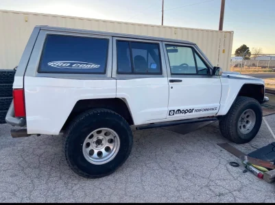

It started life as a green Japanese export Cherokee and spent it's life in Japan until 2020 when it was imported back into the states. Everything cosmetic (Hanneman fiberglass, bumpers, paint, wheels) was done in Japan and the suspension, motor, and interior were bone stock. My guess is it was some sort of Sema type build and was just for looks. But I was stoked because it looked cool and allowed me to build the suspension exactly how I wanted it. This is how it looked staight from Japan.

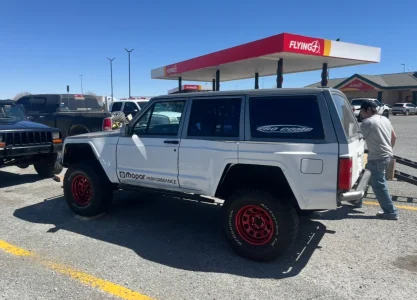

I kept my wheel / tire combo because I had practically brand new BFG's and didn't want the fuckin Ling Longs that were on it. Quick wheel swap in the gas station parking lot went smooth. Thing ran so good compared to my black XJ since it only had 53k miles.

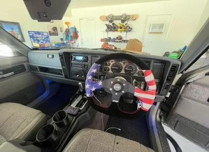

I got it home and cleaned it up and ended pulling a couple hundred feet of aftermarket wiring out. The head unit only worked on Japanese radio frequencies so I pulled that too. It was also wired for a backup camera but had no screen IMG_6914.webp

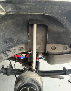

Had a Sand Hollow trip planned for March 2024 and needed to fix the rear end. Decided on a low profile shock tower to house some raptor takeoffs and hopefully keep it from bottoming out all the time. All 1/4" plate. Designed them myself then had a buddy cut them on this plasma table and weld them up for me
Got it buttoned up a few days before the sand hollow trip and it rode like a damn dream. The old man emu leafs are pretty soft and the 1st gen shocks are pretty stiff so they evened each other out really well.

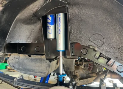

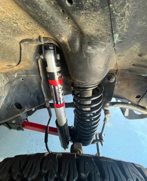

Liked the Raptor shocks in the rear so much that I put some more on the front in August 2024. Between the XJ and my Expo I've gotten pretty good at rebuilding these things :ROFLMAO: The Jeep stayed like this for the winter of 24/25'

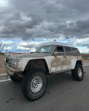

The upside to the shitty auction result was that I cared less about keeping it in good shape. Shortly after I drove it up to Sheep's bridge above Phoenix and thrashed on it for a few days. Went a lil deep on a couple crossings and flooded the floorboard once lol

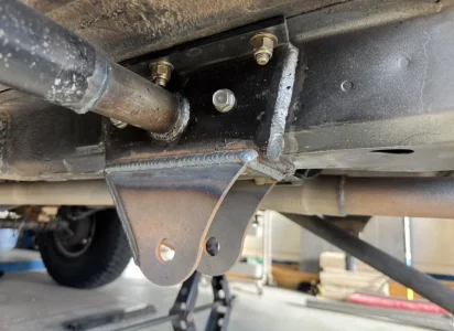

This past september I finally did a long arm kit. Went with Rusty's JeepSpeed 4 link kit and was super impressed. The brackets wrap fully around the unibody and sandwich the floor, and got welded on too. 2" 0.250 dom links and 1.25" heims. Can finally flex out pretty good. Also did ruffstuff replacement shackle boxes on the rear which help out a ton

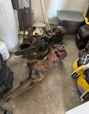

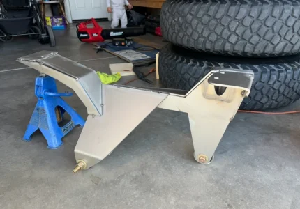

Pulling the trigger on a D44 ttb swap. Started collected parts a couple weeks ago and now have all the big pieces I'll need except coilovers. Jax no longer sells their ttb kit, but I found a dude who just started producing his own ttb crossmembers and purchased one. Theres some kinks with it but I think I've worked the issues out. Overall its well built but needed a little fine tuning.
CFM Industries coil over towers with a 3.0 coilover spring inside for a visual. It'll be a tight fit haha

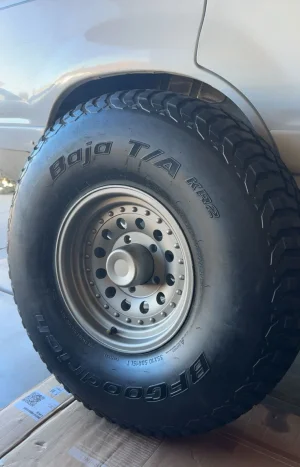

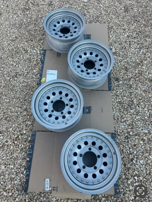

@BATTEN hooked it up with some 5x5.5 outlaws that were sandblasted, so I hit them with a can of alloy armor and they turned out better than I expected. Found a set of Baja TA 35x10.5's for sale for $200 with decent tread and swooped them. Can't beat marketplace deals. Gonna give the skinnies a try in hopes that the lighter tire helps keep this thing nimble and narrow

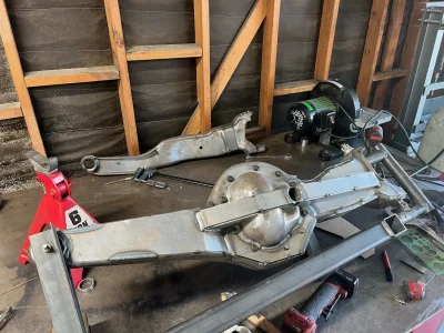

Picked up the beams from sandblasting and did a little mock up

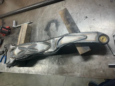

The DIY dana 44 plates fit up good. I cut a set out and used about 3/4 of the plates in the kit. I did 2" wider beams so I modified the truss and a couple plates to make it work. But I'd recommend it if you are keeping them stock width.
These look great. I like how you did the flat front plate on the driver beam instead of the kit

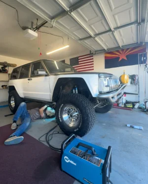

Back in Havasu chippin away at the swap and it’s crunch time! Goal is to have the jeep rolling by next sunday (6 days away) that way I can trailer it back to Tucson and finish up all the little shit. Goal is to having this thing ready to rip WITH working 4WD by middle of March

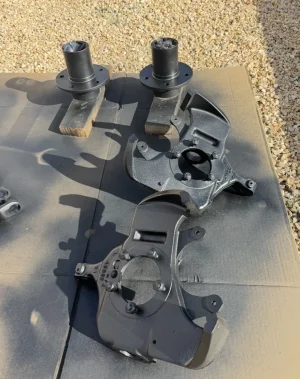

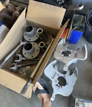

While in Tucson I got the knuckles and hubs sandblasted and painted them to look pretty. Also picked up some fox coilovers and bumps. 2.5x12 & 2.0x2.0

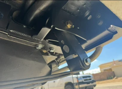

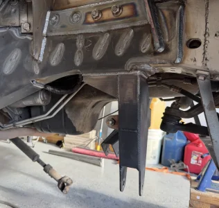

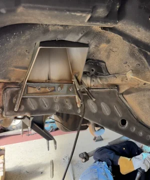

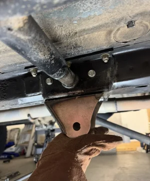

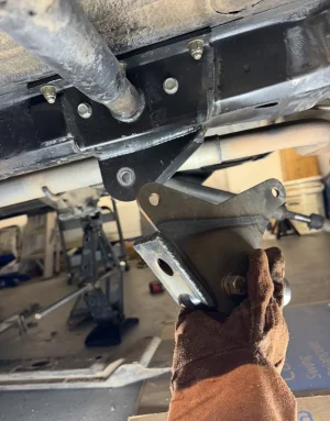

Instead of bending the radius arms or doing anything fucky I decided to just move the pivots lower so the arms clear the unibody. Starting cutting the old tabs off that way I can use the Threat mounts that came with the radius arms. About 1.25 inches lower than my previous mounts

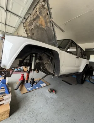

Put in the coilovers just to drool for a second. Eibach springs getting delivered tomorrow
