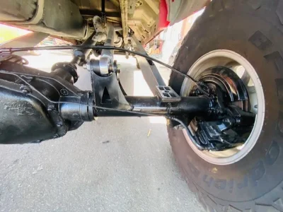

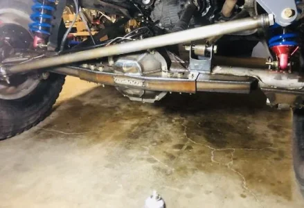

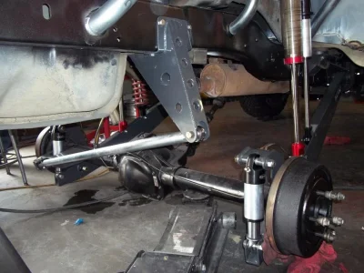

I run a complete stock axles. I don't even gear them. My trick for better traction is better suspension and weight. Now I get much better performance on the other end.
