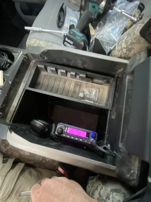

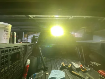

Well it’s been a while but she’s got a new 3rd brake light and antenna now. Gonna mount the radio in the center console. Need to figure out how to run the antenna cable into the console from under the flooring and then the power lead to the battery. Going through the passenger side.

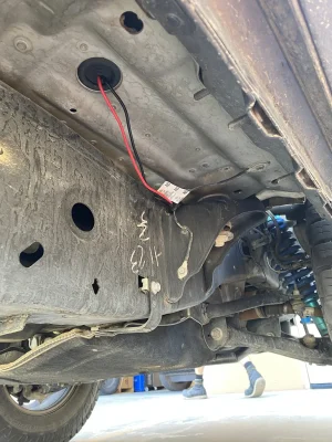

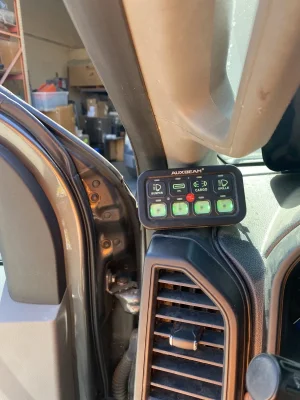

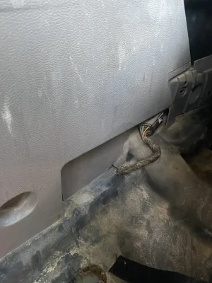

Ended up running the coax under the seat and the power out of the floor board through an existing grommet. Didn’t have to drill a hole in the side of the console but I did have to drill a hole on the inside.

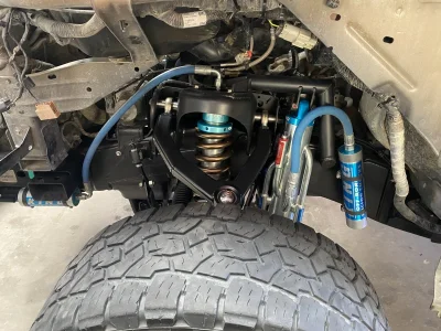

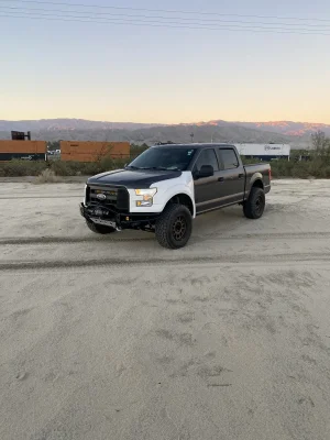

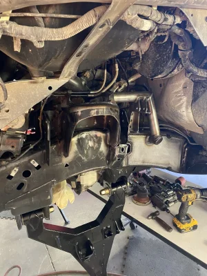

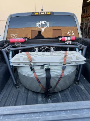

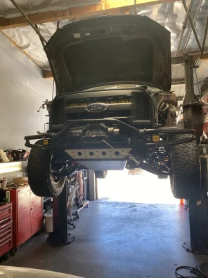

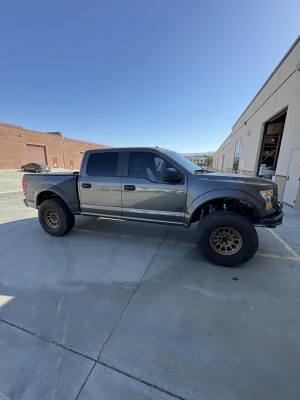

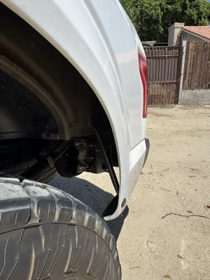

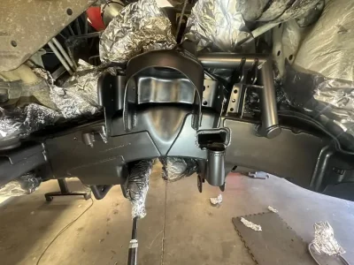

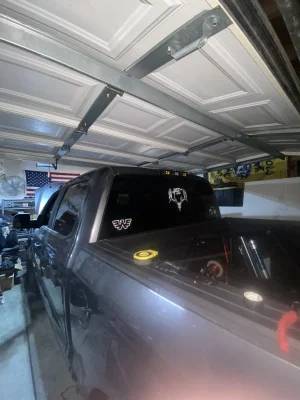

🎶 It’s been a while but here we are. Got the rear glass installed, bed side supports from some 3/4” conduit, 4” giant rear housing, 10” EWR 3rd, 5.13 gears front and rear, 37’s on bead grips, factory spare filled with water. Had to replace my exhaust because it was shooting straight back and melted my limit strap. Went with a 40 series flowmaster and 3” from the cats with resonator delete. Also did some powerstop rotors and pads. Raptor liner on the bedside and paint match from touch up direct. Just needs a buff job… if I decide to care enough. And probably some other stuff I’m forgetting.

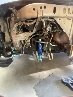

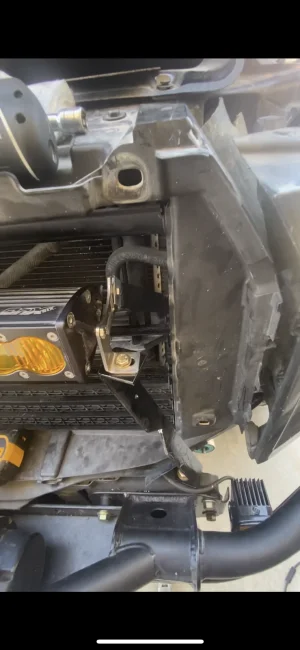

Coolers mounted and plumbed
