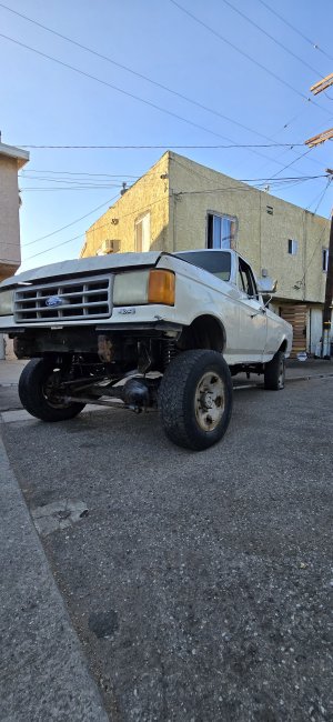

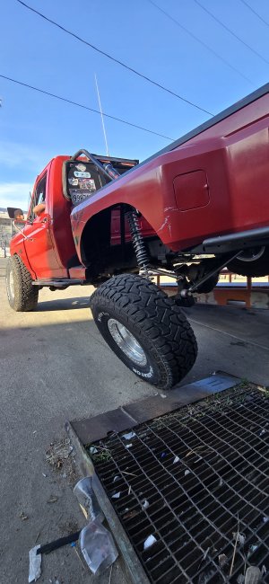

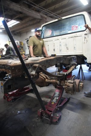

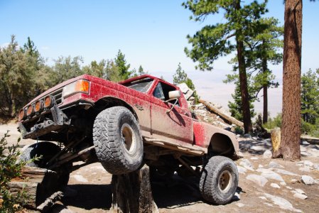

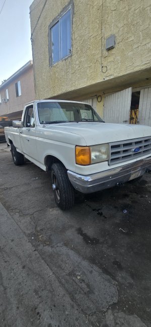

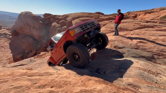

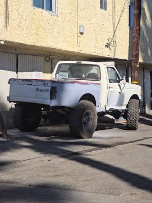

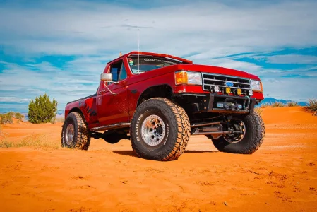

Well what started as a 1990 f250 4x4 long bed we got at the auction has quick became my crawler. We purchased the truck because it was 4x4 and efi 460.
First we added a set of 2011 f350 axles.
Then we chopped the frame to make it a short bed. Hence the f225 name.
We added a flareside bed to give it that extra clearance.
For the tcase we went with a 205/203 doubler to get that low low crawl gear
-Selectable lockers front amd rear
-ram assist steering
-superwinch 12k winch
-fox coilovers front amd rear with custom li k setup
-baja design xl80 lights
-rugged radio
-40" xcomp tires
-raceline beadlocks
-premier on board power welder
-custom rollcage
-5.38 gears
So much has been done to the hard to remebr it all
