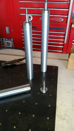

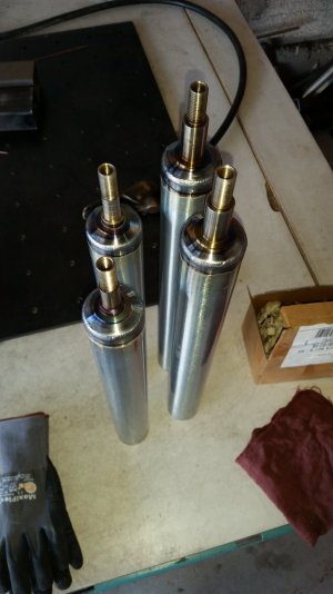

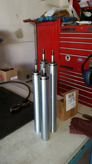

Besides what is covered, it takes 2 min to clamp and pull the top cap off the front shocks to gain easy access to the IFP piston, plus you can replace the usually weeping top cap seal as well (i guess technically it would be the lower arm side of the shocks) Just mark the cylinders left and right so you know which top cap is clocked for which cylinder.
A lot of parts are av for them, and the factory rears are becoming popular as a universal IBP 12” shock for other applications. Valving wise the stock stacks are garbage, but I’ve deviated from Fox’s valving chart years ago. My valving stacks improve street ride quality and dirt performance, and being a fully tuneable shock I’ve had 2 guys bring them back to fine tune them even further.
