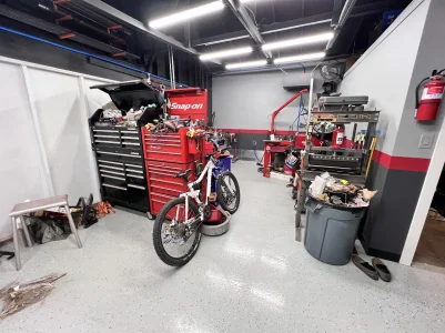

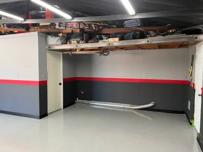

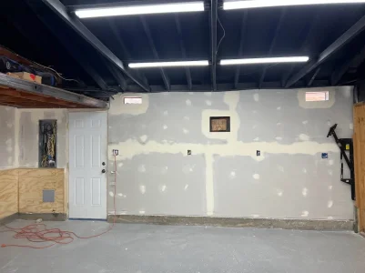

You can see my blue airlines in some of the pictures. I put dedicated drops at the plasma table and air hose reel. Also plan out your 220 outlets out and have more than you think you'll need. Put a couple on either side of the garage door so you can run an extension cord to anything in the driveway that won't fit in the garage. Thinking ahead helps a ton.

Ok sweet. Your joists and rafters look good in black. I may steal that idea. I have the same airline setup at my current house and it is great. I think I am going to try and stick my parts washer and compressor outside. I may see if I can get my blast cabinet out there too so its less dusty.

I have my compressor outside in a little wooden outhouse looking thing I made. Huge difference having it outside. I punched through the stucco and ran a PVC pipe through the stucco hole, then ran my rapidair piping through the PVC to keep it from chaffing.
Painting black made a HUGE difference, but was a big pain in the butt lol. I used a handheld airless paint sprayer. Definitely work from top down. Paint the joists and ceiling first, then run all your electrical, lighting, outlets, etc. Then drywall/paint, then floor.

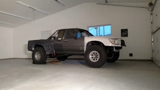

I had my garage insulated and drywalled on the walls and ceiling when I built my house and it is so much nicer as the weather swings don't affect the temperature in the garage much at all. I painted it all white and it really helps with lighting. Having done drywall a few times, it wouldn't take you very long at all to install, tape and mud. Using a heavy matted roller and it'll hide most imperfections. Plywall would be nicer to mount things too but at triple the material cost and the fact that it doesn't blend out mud well I'd pass on it. Might be nice for impact resistance but I don't have any holes in mine yet 6 years in.IMG_20160130_171454825_zpslbmetrbl.webp

i just want to say SCREW YOU... i wish my garage was this big. I have about 2 inches from front bumper to wall, and back bumper to garage door.

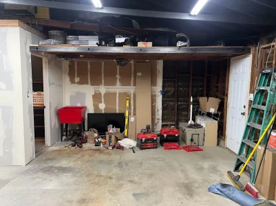

What did you use for your tube racks in the last picture? Are they just lagged into the studs?

Cheap set off Amazon. Ground back the main welds and redid them. Took less time and money than building them myself. But yes. I think four lag bolts into each stud. No deflection and I’ve got a good amount of material up there now. Obviously stack it higher closer to the stud
