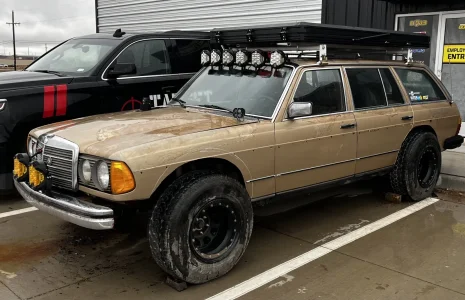

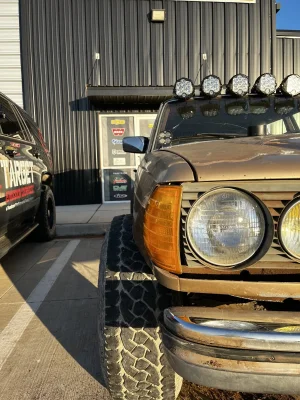

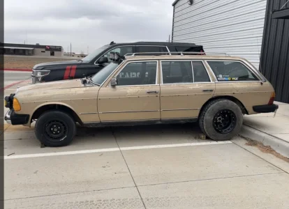

Snuck out of the house and thew a quick spacer lift onto the Mercedes, not exactly how I want to do the lift long term but my impatience got to me looking at these tires in it. Roof bars to mount the roof top tent also showed up this week but I’ll have to get to that install in another week or 2
My spacers showed up yesterday to change the lug pattern from 5x112 to 5x4.5 so I can run a typical jeep pattern 15” wheel
The front hub bore on the Mercedes is 66mm, however, my adapters choke down to the smaller hub bore of the 5x4.5 section of the wheel so I need to chuck them on a lathe and open the bore up the rest of the way.

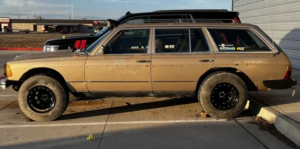

The rears went on no problem and I got a rough cut out of the rear fenders done before I had to pack it up for the day. Still have a lot of cleaning up the metal to do, and the inner fender actually goes all the way through to the inside of the wagon so I’ll have to create some patches to seal it back up which is no big deal

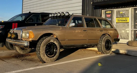

Here’s some photos of the rear slapped together though! Little stink but action as well as a before and after so you can see the height gained from the spacer lift

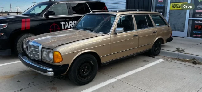

Got everything at the shop finished up early today and had some time to work on the Benz before heading home. Got the wheel adapters machined out and the fronts fit on today. Rough cut on the fender and finally got to see what she looks like and dammit I nailed the stance if I do say so myself.

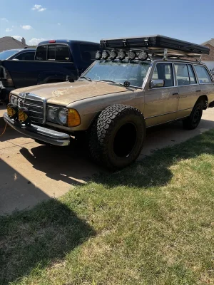

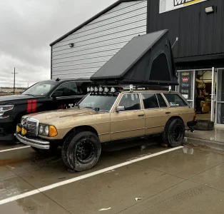

Popped the tent on today getting ready to pull it home so I can do all the wiring and interior
It’s fun to see it really starting to come to life can’t wait to get it out on the trails! Hoping to take it on a Merus Adventure trip in Palo during Canyon for her first maiden voyage but may need to do some testing out here at the local OHV trails first to make sure we don’t run into any major issues before a trip that far out of town

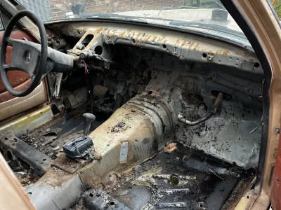

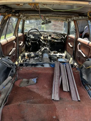

Started ripping the old nasty interior out.
Good news is no major rust found so far I’m pretty sure this wagon lived most its life in New Mexico so thankfully it’s not too bad.
I was contemplating refreshing the original Mercedes seats but I think if I’m going this far I may as well throw a simple cage in and go with PRP daily drivers up front and a 3 person bench for the rear.
Dash and hvac system come out next then it’s onto creating a new simpler wiring harness. IMG_0787.webpIMG_0798.webp
Sounds like you might need to reach out to my Gambler friend @Golden_Cedes on insta. has a very nicely built merc... also in gold.

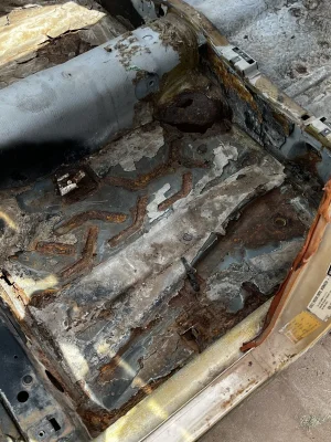

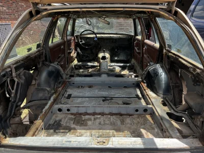

Made a decent chunk more progress on interior removal. Got everything out and cleaned up for the most part. What a nightmare of a mess! Found a little bit of rust but not bad at all and will be easy to fix while we’re doing the cage.
Also while I have the car this far apart I’ve been itching at the idea of going ahead and doing a solid axle and 4wd swap into it. But we will see. Here’s some progress photos!

I used to own a 300TD that was bought new in NY city, and eventually made its way to CA, had a similar amount of rust. The bottoms of the doors were so rotted out you could look up through them to see the window regulators😂. What's the plan to ditch the hydraulics in the rear suspension?
Stoked that you are continueing building this beast.... But that Rust looks :sick::sick:
I was down with my back there for a while I feel a good bit better now! The rust does look bad but it’s where I’ll be cutting for transmission and transfer case now so not too stressed about it. There’s other spots that are decently rusty as well but we will leave them for character

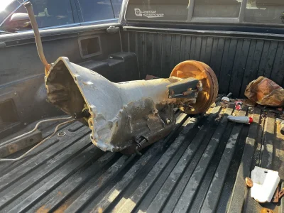

solid axle swap front and rear 🤘🏼🤘🏼
Width and mounting points in the front are the same on the frame of the Mercedes as a jeep xj. So my thought process is a high pinion Dana 30 out of an xj fab up a crossmember mount and run a radius arm long arm style control arm setup.
Then in the rear do a leaf spring setup with a ford 8.8
