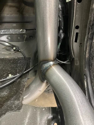

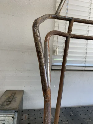

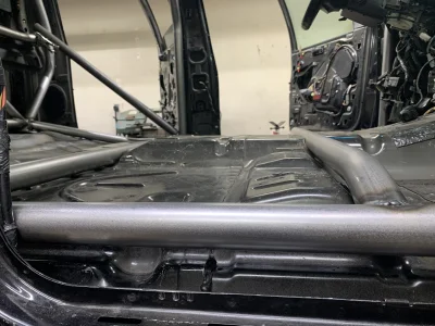

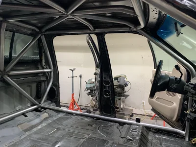

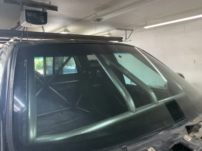

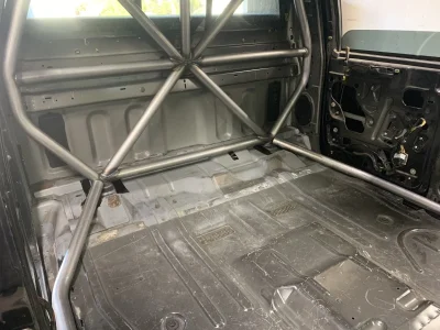

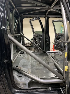

I’d sleeve it. It’ll otherwise be difficult to get it installed without a large gap at one of the notches.

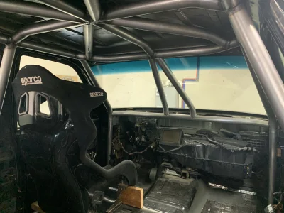

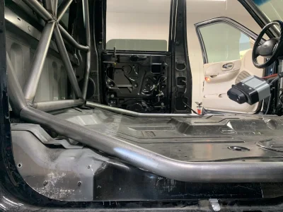

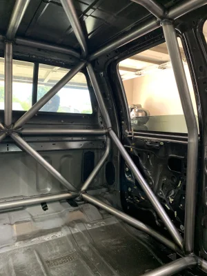

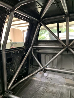

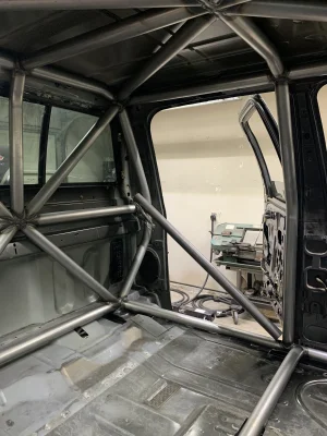

looks good!

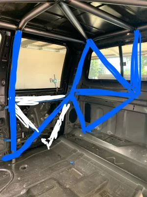

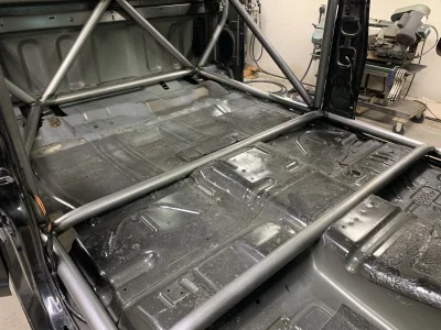

but in the spirit of olden days DR internet fab..... you should have made that back floor cross member/seat tube land on the bottom of b-pillars...and then also tied that same junction back to frame.
Like it is now is a "dead tube" and everyone is going to die. LOL
looks good!

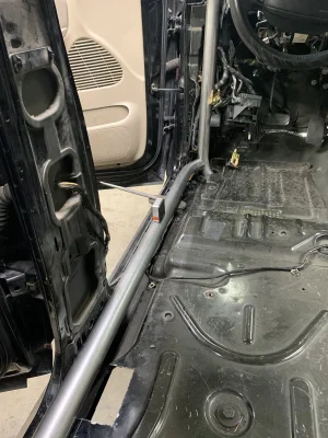

😂 I know.
It would have been directly over the body mount bolts making them inaccessible. Could I have bent the ends and done some wild fucked off notches, sure.
Fuck you lol

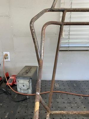

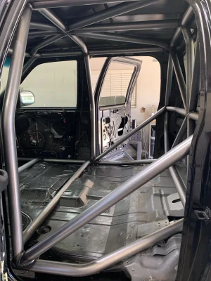

Do you ever start wondering why something looks off and the next thing you know you’re balls deep and there’s no turning back?
Fuckers more crooked than the pictures make it look. I didn’t want to go full containment, but if I’m buying another set I might as well do it.
