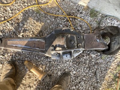

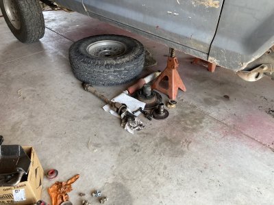

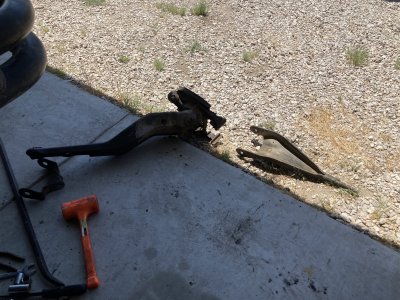

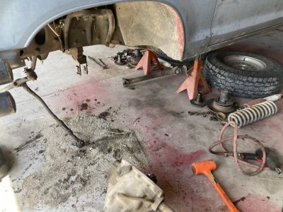

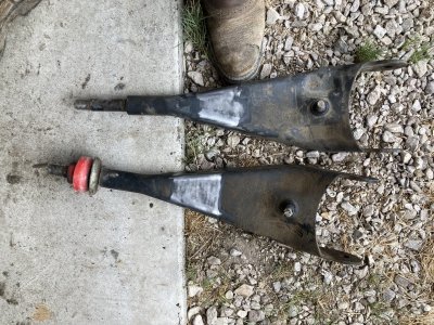

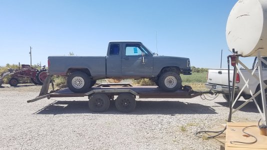

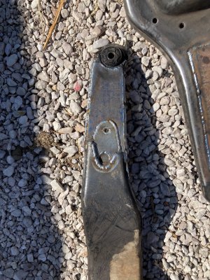

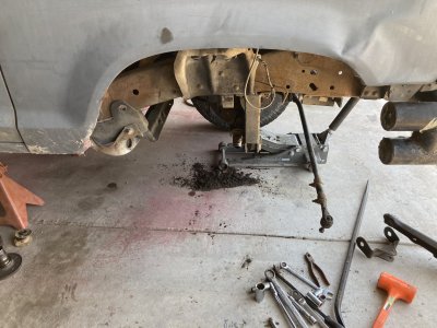

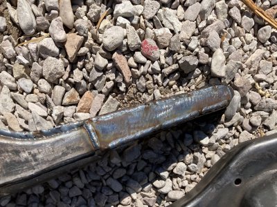

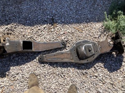

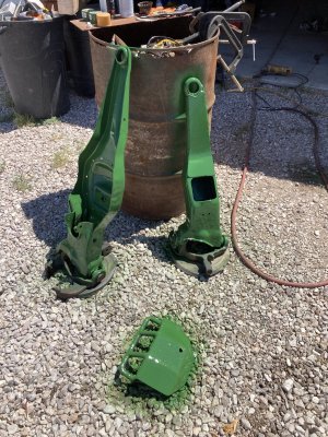

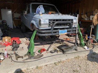

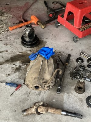

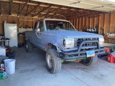

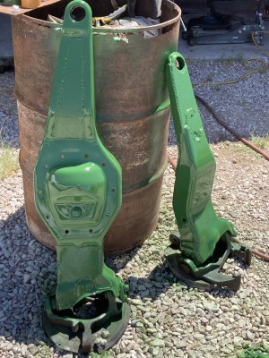

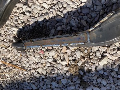

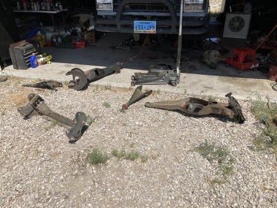

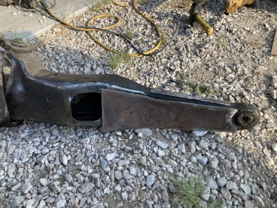

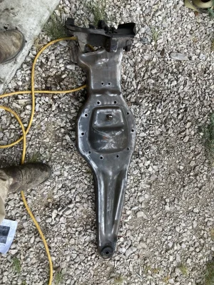

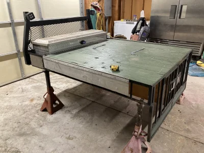

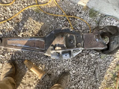

So this will be a rather large pic dump. Bought the truck as a project for $500. It’s an 89 4x4 that came with a 2.9. The guy had started the 4.0 swap but got discouraged with the wiring. I bought it, finished the wiring, swapped in a D35 and 8.8 from the explorer the engine came from. Regeared them to 4.56’s and added lockers. I extended the radius arms and swapped in 65” chevy leafs, with the help of the DR dudes and the ranger station tech files. C64193DF-7460-4766-A8D0-E6E293A32A14.jpegBA66EE7B-664B-4303-BDF0-20F529E47CF9.jpegCF458D81-9E3E-4225-B262-EFDB299E21BB.jpeg6D0571A3-4B15-4524-9588-3F84D94D29D8.jpegDA56C99B-E63A-4659-B529-C811A023BC63.jpeg72DB1EDE-4FCA-46AF-9864-E821D1BB1D98.jpegD69F6B12-8271-4A2C-912B-B06B12AE052A.jpegD44575E0-2A0E-499A-AC2A-A539C71B2874.jpegA189D3F2-0BD3-4852-A771-5D9B024EA33B.jpeg

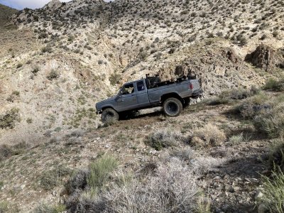

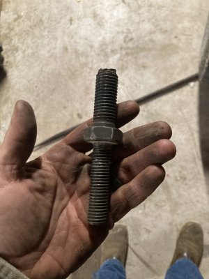

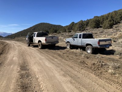

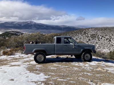

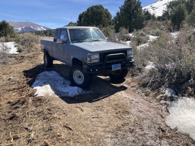

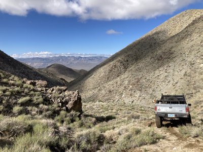

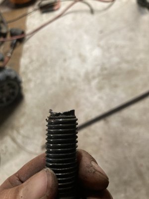

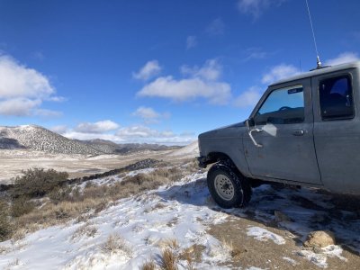

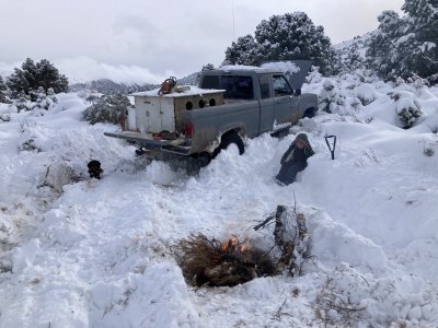

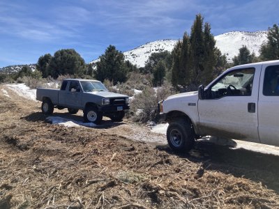

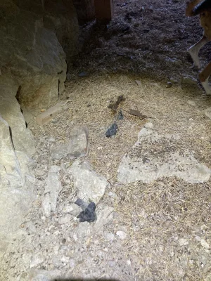

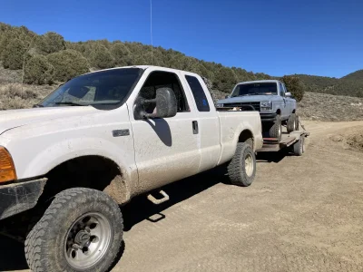

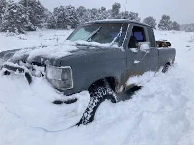

So on the first shake down run I found out that you have to shorten the RA/coil retaining bolts. They hit the axle shafts. The rest of the pictures show the trip leading up to the transmission failure. It had the original FM146 and it seized up while breaking trail in the snow. Because of the remoteness, the truck had to stay there for 4 months, until the snow melted off and I could get to it with my F-350 to drag it out.

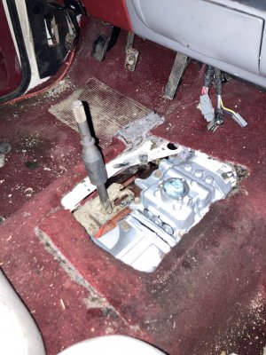

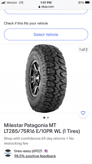

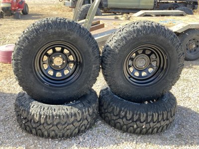

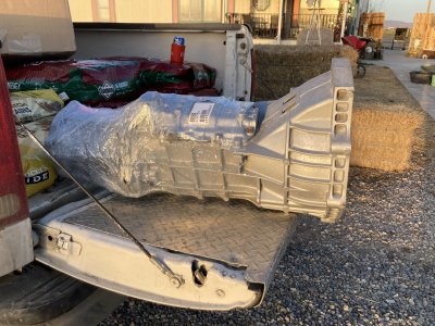

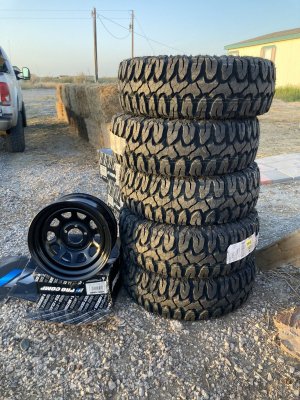

So it’s home and I replaced the trans with a rebuilt m5od. I decided to install the 4.0 flywheel, clutch and starter instead of going with the weaker 2.9 crap I already have. I also bought new rims snd tires. I went with Milestar Pategonias in load range E 285/75/16’s which are just under a 33x12.5. I got the tires off eBay for $1125 shipped to my house. The rims csme from 4 wheel parts and are procomp 16”x8” with a 4.5” offset. Then there’s the next list of things I need or want to do. I should have it up and running today. I may or may not put the tires on and trim fenders. We will see.432EB832-1FC6-45E8-AE69-20C3EB837A0A.jpegBD7EE162-BCCA-4511-AA45-157AD0826426.jpegB7C4DB1C-5E24-45F0-A317-966B90F162A4.jpegD43DC726-D63C-4FB6-91DF-584FF9186CA7.jpegFA68B302-95D8-48EB-B853-35C385734FD5.jpegA03DCFAB-61AB-4F27-A7DB-8F8C1481D397.jpeg
