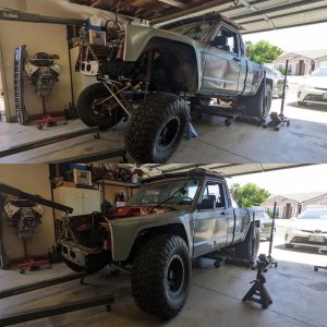

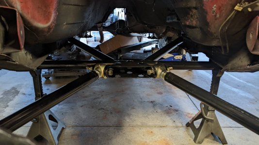

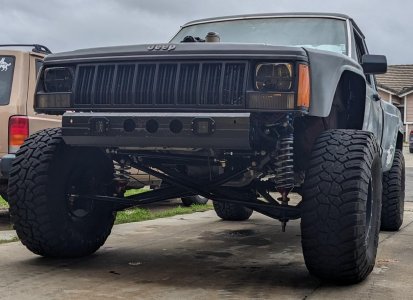

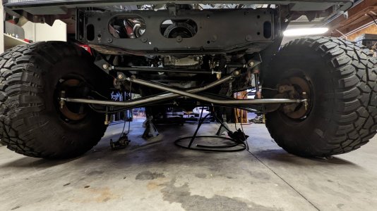

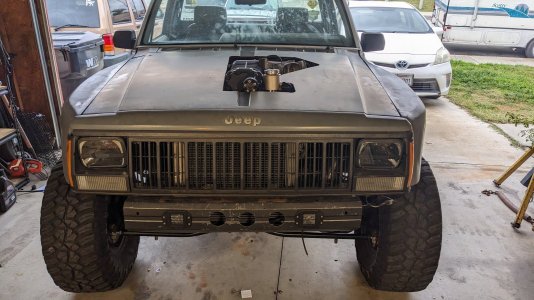

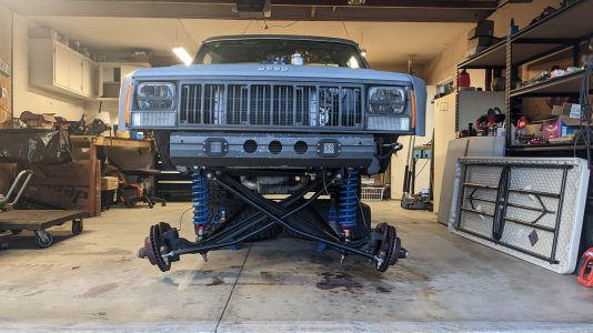

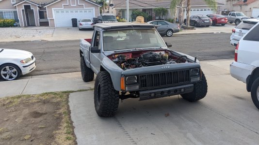

This is my 1989 Jeep Comanche,
Suspension:
-Equal length I-Beams 1'' Kingpin, Front steer, 5x5, Disc brake
-Double Swingset Equal length steering
-Centermounted Radius arms
-Radflo 2.5x14'' Coilovers
-Front Cycles 21'' Metal to metal
-Rear Stock leaf's and shackles, Resi shocks
Motor:
-Gen 3 5.3 Iron Block LS
-2012 GT500 Eaton M122 Supercharger
-Holley Terminator X-Max
-Holley intake Base with a custom adapter
Trans:
-4L80E with HD2 kit
-Winters Shifter
Body:
-All Hanneman Fiberglass
-Gray Rustoleum paint
Thats the major stuff, many small upgrades here and there. Photos to follow:
Please ask questions and give helpful advice!
