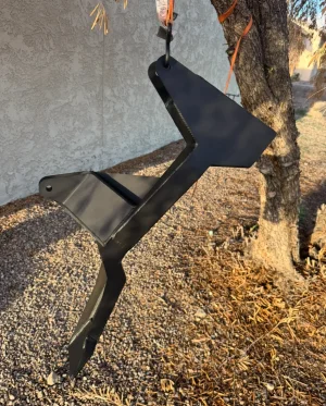

Pulling the trigger on a D44 ttb swap. Started collected parts a couple weeks ago and now have all the big pieces I'll need except coilovers. Jax no longer sells their ttb kit, but I found a dude who just started producing his own ttb crossmembers and purchased one. Theres some kinks with it but I think I've worked the issues out. Overall its well built but needed a little fine tuning.

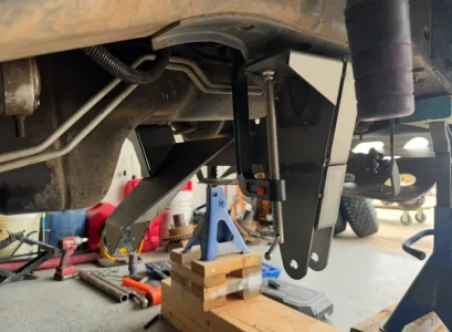

CFM Industries coil over towers with a 3.0 coilover spring inside for a visual. It'll be a tight fit haha

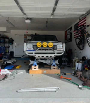

Front end off, mocked up the crossmember, figured out ride height and got the crossmember and shock towers welded up. Next on the list is to get the front frame stiffeners and shock towers tacked on. Beams are getting sandblasted tomorrow then can start cycling the suspension 🤘🏼

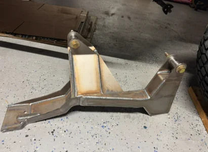

Crossmember pre painted for black alloy armor. Will get final layer once installed and welded

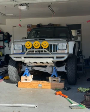

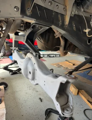

Picked up the beams from sandblasting and did a little mock up

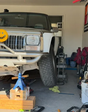

Ride height
Roughly 9 inches uptravel
Radius arm mock up. 33 inches from heim to beam
coilover compressed length anywhere from 20-22 inches. Most likely going to run a 12 in shock
