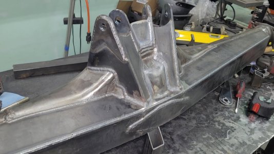

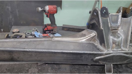

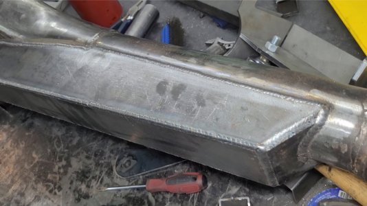

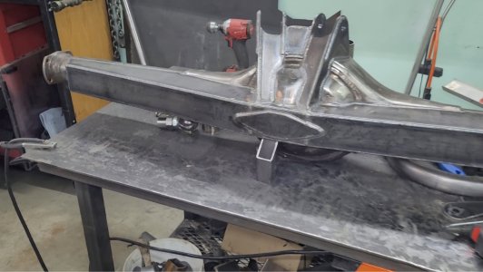

Pictures from when trussed and tabbed the rear end.

That seems to be pretty beef have pics of the damage
But it wasnt beefy enough! I didnt take pictures. Its hard to show and do it justice in a picture the issues. What should be a machined flat "face plate" surface having 1/8 -3/16" high and low spots, and the surface being bent/cocked, hair line crack a quarter to third around the mounting surface, from getting bent/cocked. An axle tube thats bent 2.5* or so....
Doesn't come across on camera how bad it actually is
