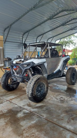

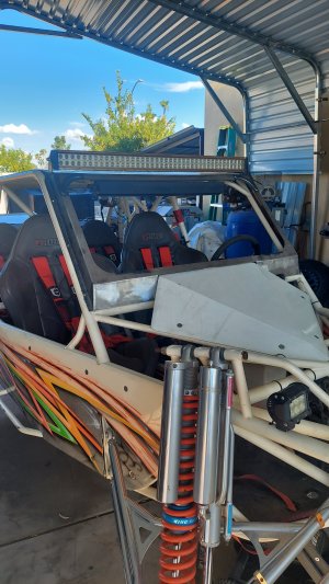

2019 Polaris XP1000
Originally a short course car, swapped the setup to desert rec. use
Fox 3.0 IBP rear and 2.5 IBP Front

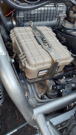

Rerouted Air intake inside cabin
New seats with custom mounts as the new owner is pretty tall
HRP Chassis (Modified slightly by FM)
HRP rear sway bar
Super ATV LT Kit
33in Tensor DSR on Fuel Beadlocks
I wanted to do the setup on the suspension after it was swapped to the foxes but the owner works for shock therapy so excuse the horrendous spring setup, and the fact that they are blown out.

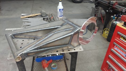

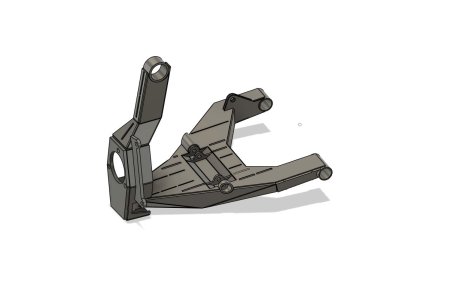

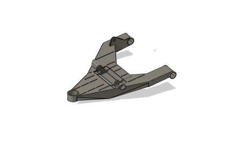

Here's the final draft on the CAD model for these arms, added bypass mounts, limit strap tabs (will be in double sheer but not 100% sure on placement currently due to chassis limitations) and modified the interior rib for the arm to get closer to the shock mounts, I also added more gussets on the hub carrier plate, now the fight is going to be nesting all these parts into the 3x6 sheet of chromoly I have.

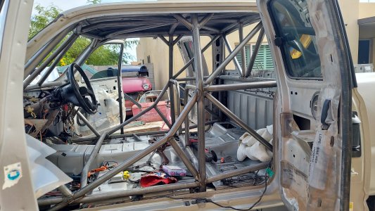

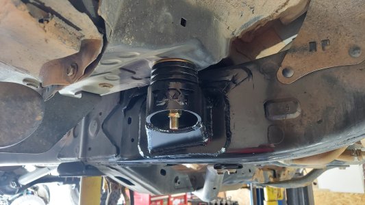

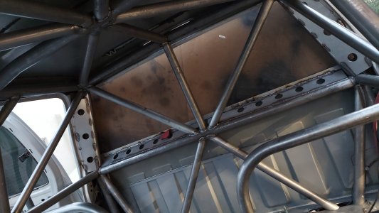

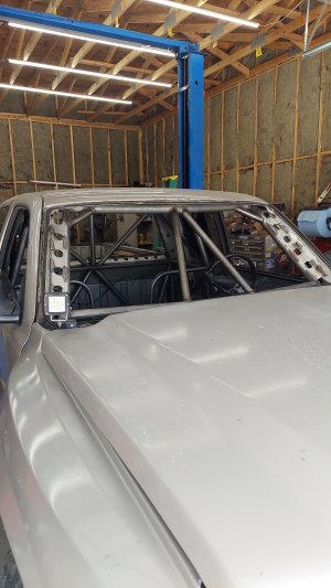

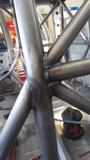

I've been cranking out quite a few jobs the last few weeks, between rebuilding parts of the sand demon, caging RadoNoah's Silverado, and also sneaking in a DRT cab mount relocation between the two.

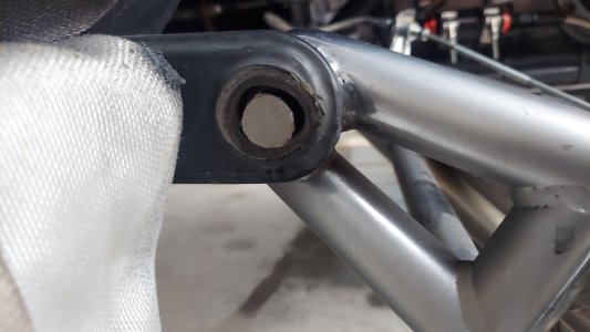

Brought me the truck pretty much fully stripped which saved a lot of time, although I had plenty of issues trying to get the cage in the truck, the cage just didn't fit as well as I would've liked, which I guess is typical for a prefab cage, but the frame of the truck is bent which added to the complications, however I didn't realize that until the tail end of the install, but most importantly, the cage is in and its solid should it need to be used.20250430_160944.jpg
Tie ins are all hand cut and brazed in with silicon bronze filler, for my first time using it I'm happy with the end results

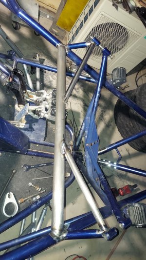

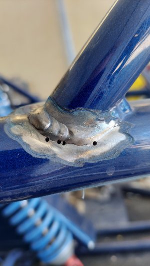

The Sand Demon had a bunch of cracks in the frame that needed to be repaired, primarily the front shock towers and the steering rack were ripping off the frame. The parts I'm designing for this thing are definitely more along the side of being overkill, but for a play car that isn't going to be completely torn down every few hundred miles, I'm prioritizing reliability and toughness over being on the cutting edge of performance.
I made a brace for the rear portion of the shock tower to prevent the mounts from ripping off the frame again, its way overkill being made of .120 wall tube, but its not going to have any future issues

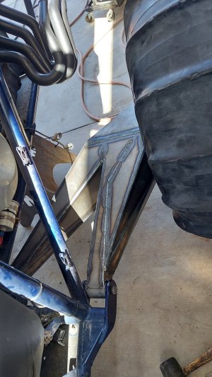

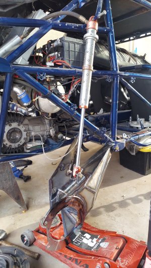

Finished welding out the main structure of the first of the two rear arms, it came out pretty good, mocked it up on the car to make sure it was all straight, now I just need to finish welding the overlays, gussets and shock mounts, then move on to the second arm. Also, I made a mistake in a previous post, these are still going to be 930 CVs, just moving to a mid-board gear one hub instead of the previous inboard CV

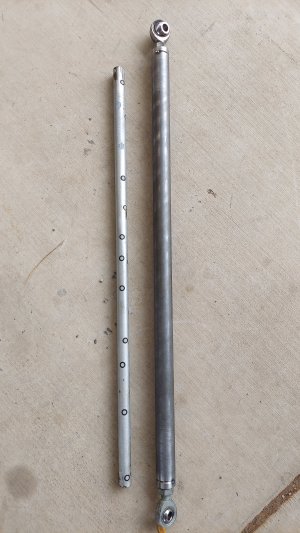

Had to cut off the old rack and mounts since the owner wants to put on a newer gear-one rack, and newer uprights on the car, I scanned it and put it into Fusion only to find out whoever put the original uprights on, made them too short on the vertical spacing so the car had no Instant Center in the front end and had horrendous bump steer, upwards of 1.5 inches. The new setup has less than .5in through its metal to metal travel (~16in). I made new tie rods for the rack and new uprights, replaced the heim joints on the upright side of the control arms and now just need to prep the hardware properly, and weld in the rack mount and gussets

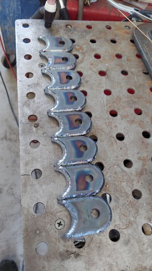

The rack mount is all .25 with ,120 overlay, the rear frame tie in plates are .25 but also double pass welded on both sides just for added insurance since I didnt cut it as one piece and bend it, which would've been better, but its overkill as it is.
Old (.75in diameter .120 wall) vs New (1.25 in diameter .120 wall) tie rods

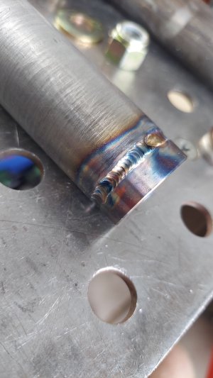

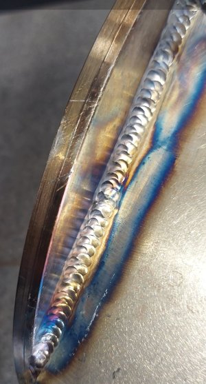

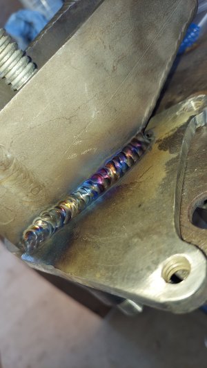

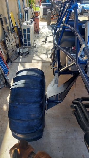

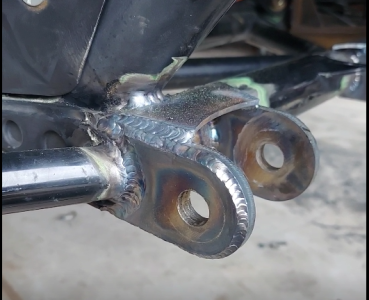

Just about wrapped up with the first phase on this sandcar, the welds on these arms are undoubtedly the nicest ones I've ever thrown down so I'm quite happy with them.
Passed quality control

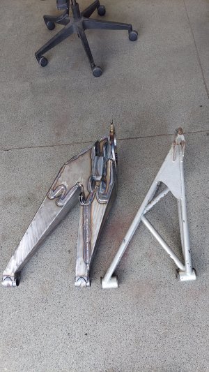

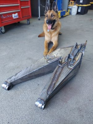

Old arms vs the new ones, obviously these class 10 style arms are way overkill but they should never have the issues the old arms did.

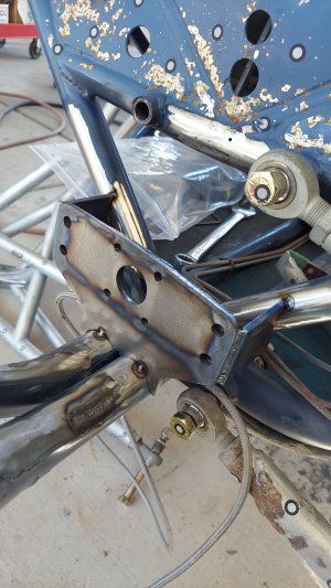

Had to add a brake caliper mount on the pass. side, for some reason it was just, not there, but no witness marks from where it may have been cut off, oddly enough.

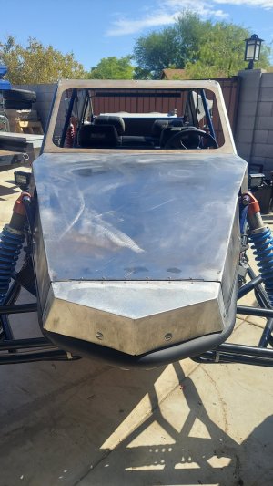

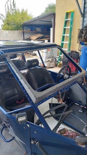

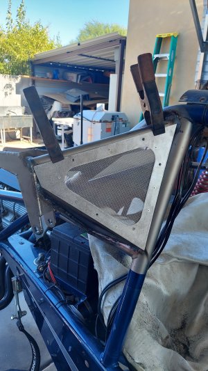

The next phase of this thing will be the upper shock mounts for the rear, along with a windshield frame, hood, and dash, I also need to measure for the new shock package since these sway-aways are trashed
