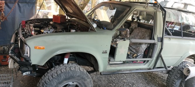

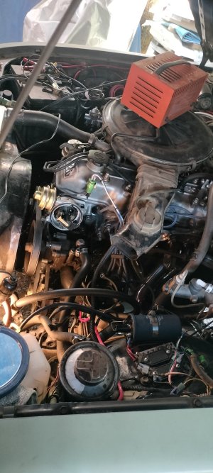

Distributor sends signal when out of the vehicle yet when installed against the cam will not send a signal to the Chevy ignition modification. Tested multiple different distributors outside the block it sends spark but when in the distributor there is no spark. Most all wires, Chevy ACI system, and 90% of the rest of what's under the hood is new. 200 miles total on everything, well except the body.
