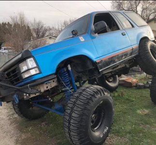

I've owned several Fords and a Jeep over the years for one reason or another some got sold and I grew up a little, but I find myself always coming back to wheeling. As a guy with some gnarly ADHD that is impressive. I started with a 1993 Explorer on a 2" budget lift and got into wheeling from there. Lately, I’ve been trying to convince myself that I can build a semi-budget full-size rig that can still hit decent trails while keeping the TTB.
My biggest complaint with my first Explorer was the suspension — I went with radius arms, and it only really articulated well when I ran a wristed radius arm (see first picture). I just can’t justify spending $1k on parts to do a solid axle swap only to have it articulate kind of the same — especially when I could just regear and add a front lunchbox locker to the axle I already have.

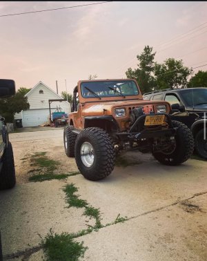

That eventually led me to a 4.3-swapped YJ that I wheeled for a bit and then sold. And that brings us to the current project — the Budget Basher.

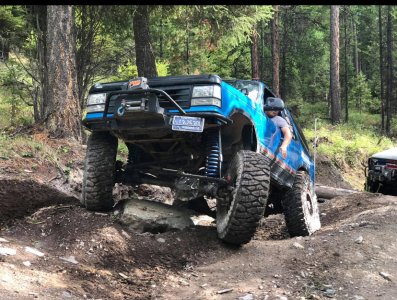

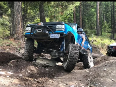

Still running the sway bar (too lazy to pull it before the trip), but it stuffs surprisingly well.
