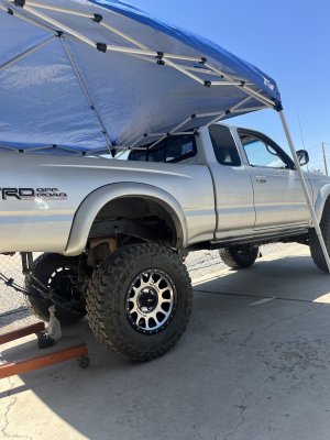

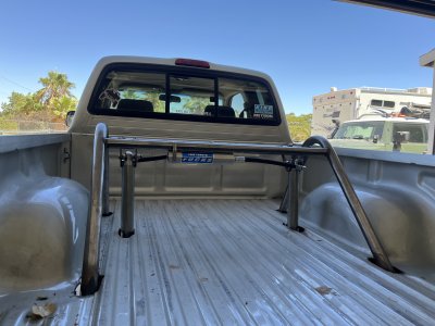

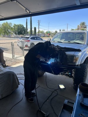

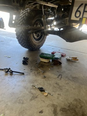

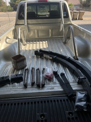

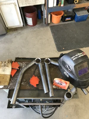

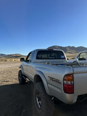

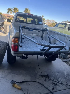

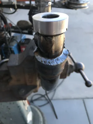

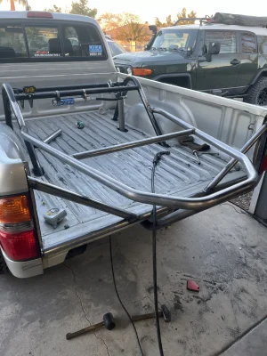

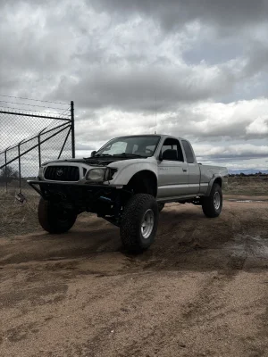

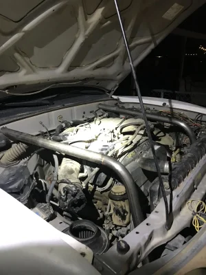

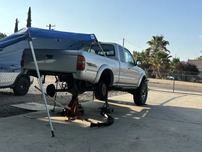

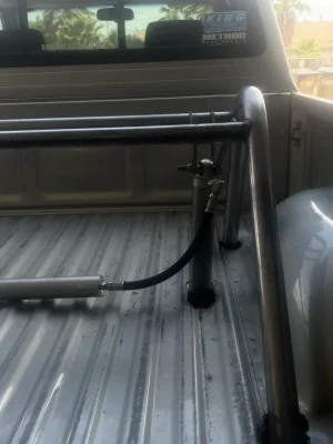

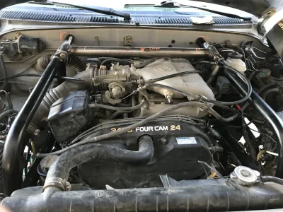

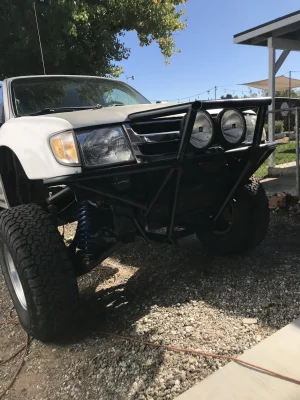

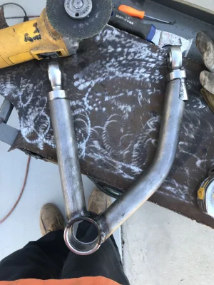

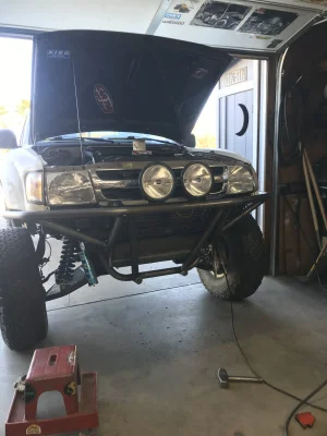

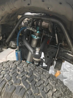

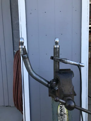

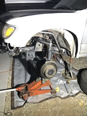

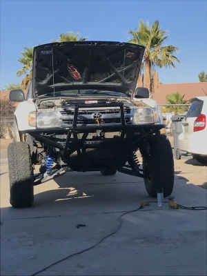

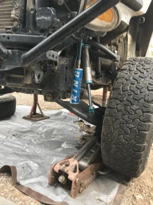

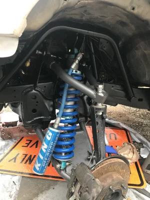

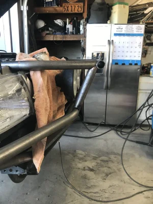

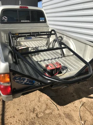

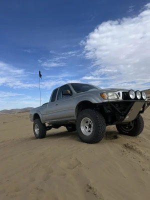

I started this awhile ago been doin little stuff here and there just started with a total chaos kit with upper control arms and some 2.5 king coilovers I’ve been workin on doing the full long travel rear with the Deavers under the axle 12 inch shackles and some 16’’ foa shocks I think it’ll work out pretty good had to build my own bed cage been learning how to rebuild shocks and stuff like that. Later in as I go

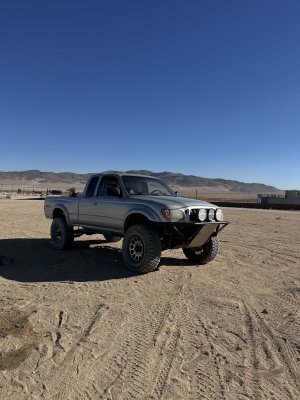

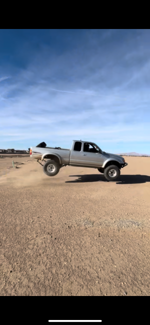

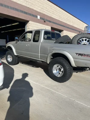

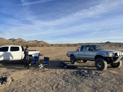

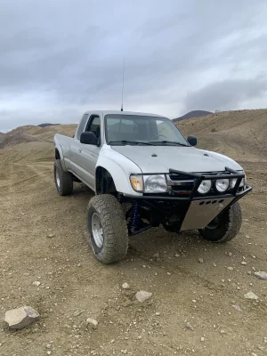

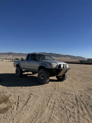

Finished up the rear end took first trip out to slash x and the OG deltaco did good exhaust got smacked around a little broke off 2 of the hangers soo had to fix that later but good rip

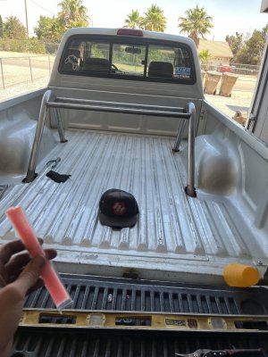

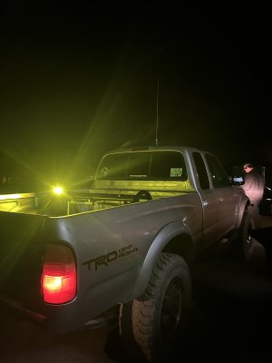

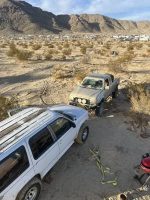

Been running this thing into the ground probably about Time for some maintenance gotta do some bed stiffeners bed sides shake so back as soon as I hit any kinda whoop needs some paint new exhaust setup and a good nut and bolt check not to mention both rear shocks are blown out obviously didn’t rebuild those as good as I thought 😭 amazing truck though running good and works well gettin ready before koh

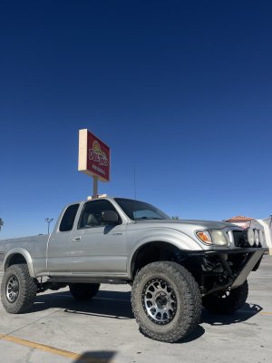

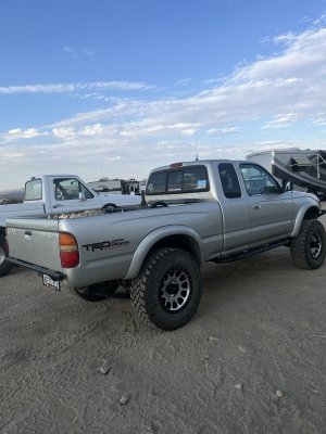

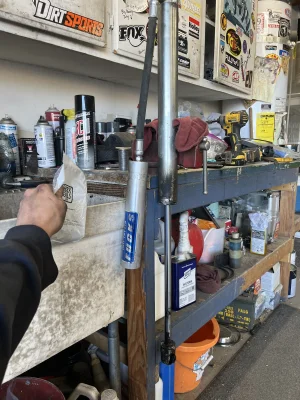

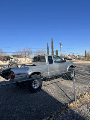

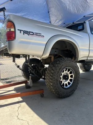

Been lacking on the threads but a lot has been happening I changed the tire combo went to a little slimmer tire to lose some weight and went to a OG ar23s to give it a more 90s look also needed some much needed love on the rear shocks

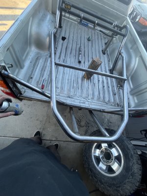

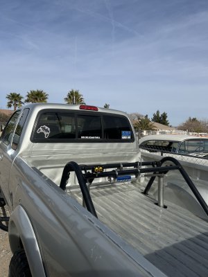

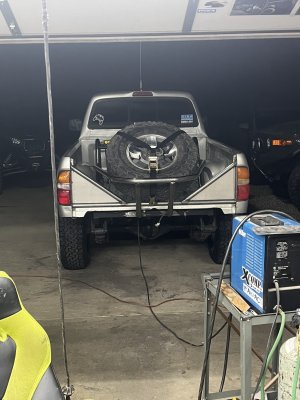

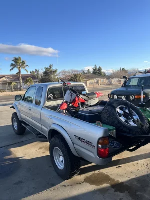

Also I went ahead and built off of my bed cage making a spare tire carrier mainly to put some weight in the rear behind the axle

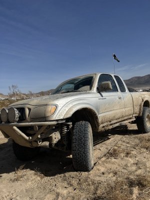

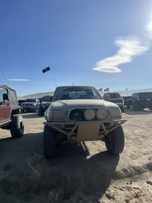

KOH was huge the truck was running better than it has in a long time absolutely hammered down on this thing had a sick time

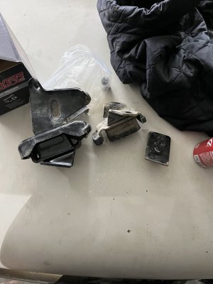

RIP my motor mounts but it was worth it

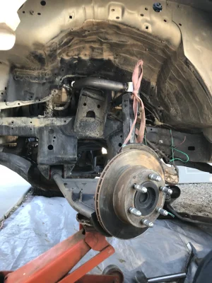

Have some big plans for this thing

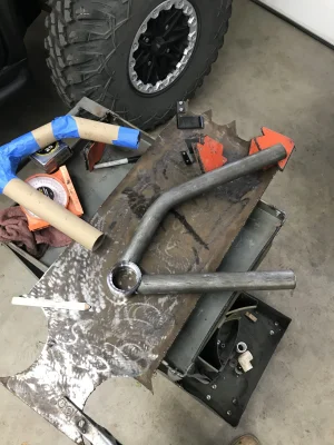

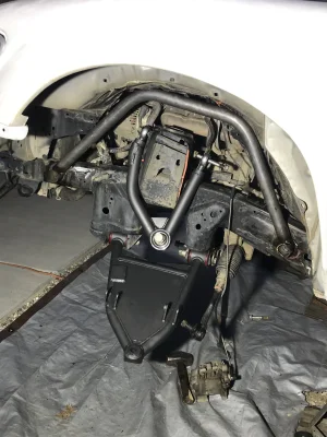

Have a long travel kit for the front in the works

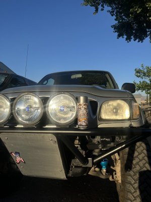

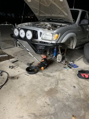

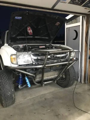

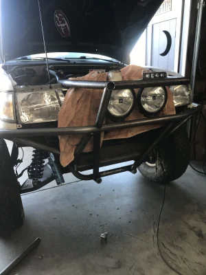

Just bought some pretty standard 2.5x8 coilovers for a sweet deal just need a little TLC this things gonna rip whole new front end redo coming up

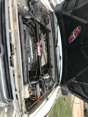

Do you mean like the motor mount perches ?those are Kinda toasted I bought oem replacement mounts but ripped those as well I have some trail gear solid mount ones I’m gonna try
Yeah, hes talking about the frame-side mounts - the ones welded to the frame. Solid offroad [in the link he posted] makes a fabricated frame-side mount too (in case yours are wasted).
