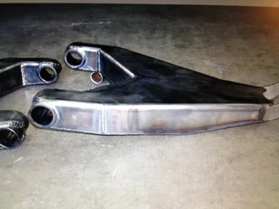

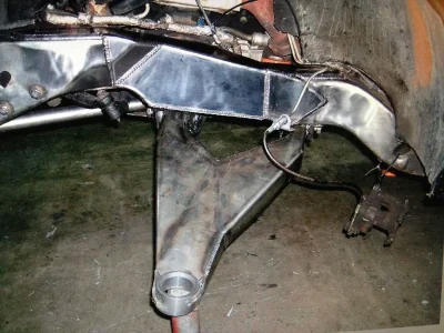

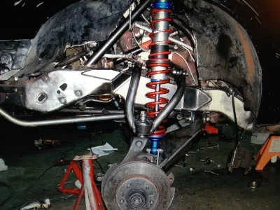

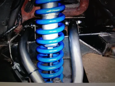

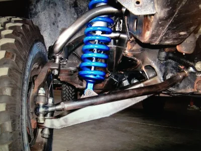

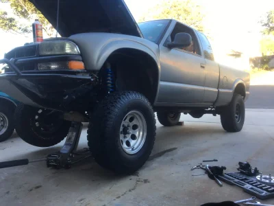

Currently its long travel front end was made and designed by Baja customs and was supposedly a development truck by their welder “Tyler.” Then another kid from Simi Valley owned it and then I bought it.

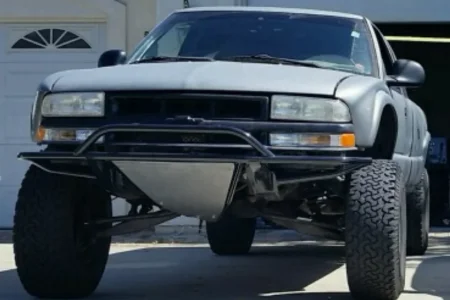

Pics are of its current design set up.
My goals are to make a front spindle for it. I have dana 35 snouts/brakes and blocks, and the econo spindle kit from Kartek. I want to fix some of the an arm steering geometry, run bigger brakes and convert it to 5x4.5 without a spacer.

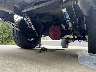

For the rear, I also picked up some fox SVT internal bypass shocks that need to be rebuilt and and modded to valve for the rear. I dont want to cut up the bed, so my goal is to maximize the possible travel as possible. Mounting shocks as low as possible on the axle and as high as possible on the frame.
Currently my rear is a 2500 drive shaft cut down(to remove the carrier) a explorer 8.8(31 spline, disk brakes, 4.10 gears), a ford ranger main leaf( so factory the s10 are 26+28” but currently I’m running a ford ranger main leaf at
25”5/8”+31 so it’s alittle longer on the back half with a longer shackle to compensate on compression. Due to my custom drive shaft I have 1.5” of slip on the yoke, so I could give up .5” for the ranger leaf, I trade for 3” longer on the rear)(I had it leaf over with the s10 main, but it wheel hopped a lot and I wanted to go back to leaf under and wanted a longer spring to run a longer shackle) with add a leaves, total chaos hangers and fox resi shocks and poly bushings.
