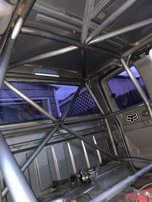

Have installed the TE designs cage in a 97 ranger earlier this year. Tube fitment and install was relatively smooth, I think we had maybe 1-2 tubes that need the notch cleaned up for a tighter fitment. Cutting out all the inner sheet metal in the roof is a must! But overall The cages we receive are pretty good. Cant go wrong with either.

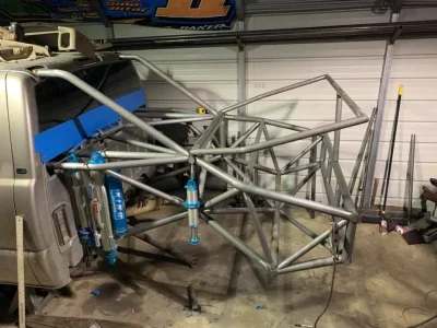

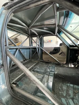

IMG_0495.webpIMG_0693.webpI have done several TE cages. Probably in the ball park now of 10-12 of them
They have all had their hiccups and pros & cons.
Currently doing the 98-11 cage right now.
Did my 93-97 ranger cage in my personal truck as well
The customer service at TE is awesome and they really do what they can to help with anyone.
They aren’t 100% perfect but I will tell you this if you and 4 friends wanted to you could cage a truck in a weekend with their stuff

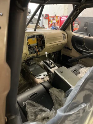

View attachment 33220View attachment 33221

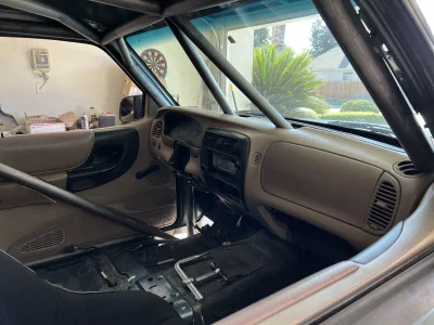

This is good info, too! I remember talking to you about fitting the dash in the newer cab. What else did you find is needed when putting it in a newer cab?

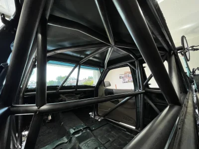

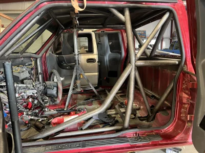

this thing is coming out so rad!
