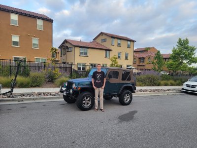

I figured I should start a build thread for my son Shane's Jeep. This way I can keep the thread for my Megacab just Megacab stuff.
Shane bought the Jeep May 26 2023. It is a 97 Jeep TJ 5spd. As it came it was on 2.5" lift, stock arms, junk shocks, stock alloy wheels, 33x10.5" BFG AT tires, 30/35 axles with gears and lockers.

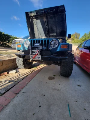

He switched to a Bimini top when the rear window zippers failed. He took advantage of HF sale on winches and grabbed a 9500 Badlands and a winch plate. We had fun moding the winch plate to work with the stock bumper and sway bar. The swing out on the rear bumper was real loose so it came off and the tire went in place of the rear seat. I think That brings us to the present.

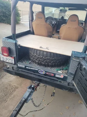

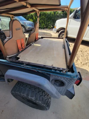

But packing stuff on top of the tire didn't work well. So we built this wood platform before going up to Monachee.

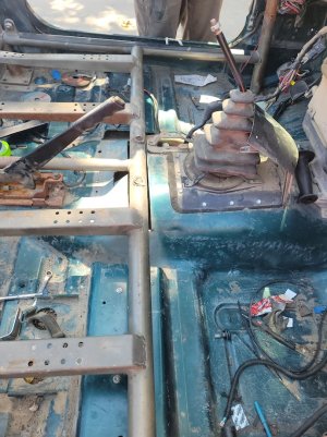

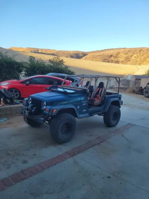

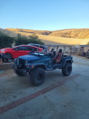

He has been wanting to put a real cage on the jeep for a while and we found one on a jeep getting scraped on market place. It has all the bars in the right spots and the price was good with belts and a good clean PRP rear bench. It came out of a TJ so how hard could it be...

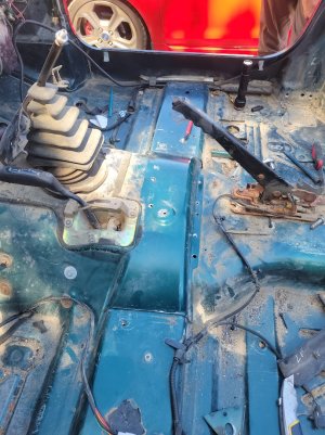

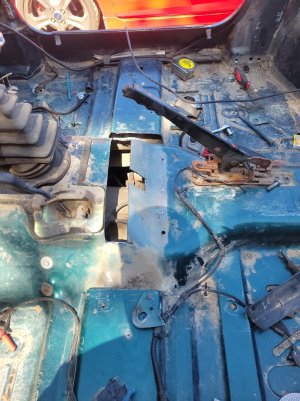

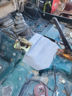

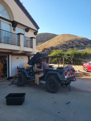

We after stripiing the dash, steering wheel, and center console out we finally got to try and get it in place. Only to find out the trans tunnel is in the way. I don't remember the one we pulled it out of having a cut tunnel so I don't know if it is a model year difference or manual to auto tub difference? After cutting the tunnel and notching the dash we were finally able to get it to sit on the floor. Only took 4-5 times of lifting it in and out.
We are going to sheet metal it back in, but we have a few more things to do before pulling the cage out again.

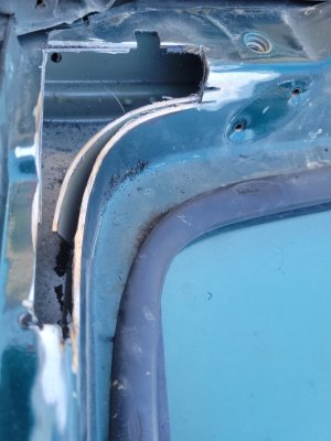

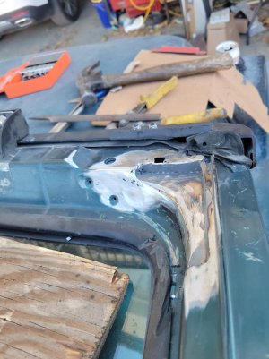

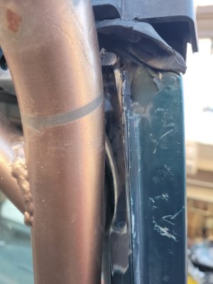

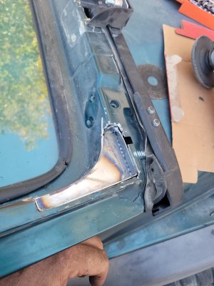

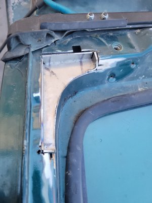

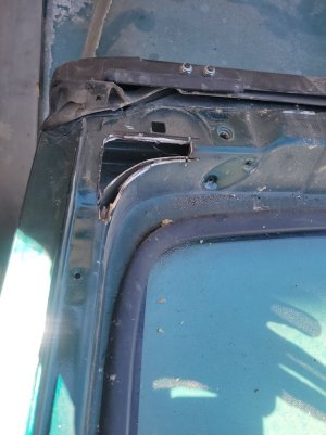

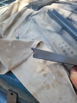

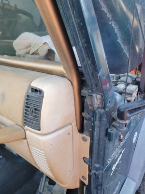

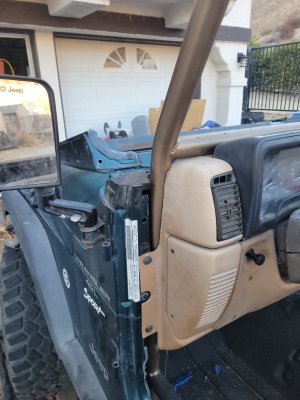

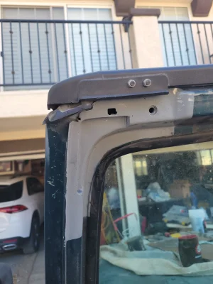

Other fun is the wind shield frame contacts the cage. So I pocket cut it to clear. This took a bunch of tries of cut, check, cut some more. I Got both sides real close and one side filled in with some sheet metal. Still need to finish off the other side and detail sand it .

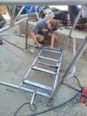

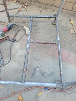

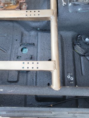

Cut out seat brackets (built for PRP seats, Mastercraft seats have wider mount points)
Remove cage to drill mount holes.
Weld in seat mounts and finish weld other stuff on the cage.
