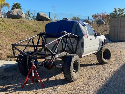

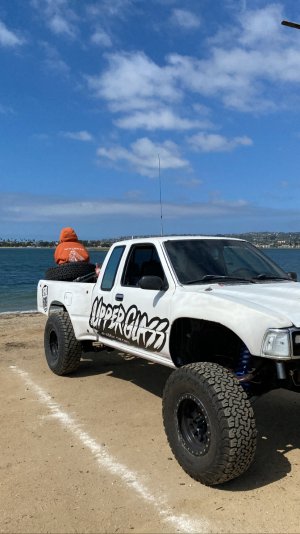

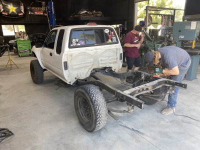

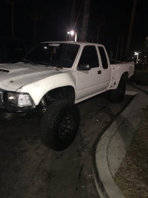

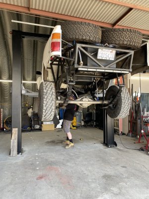

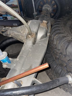

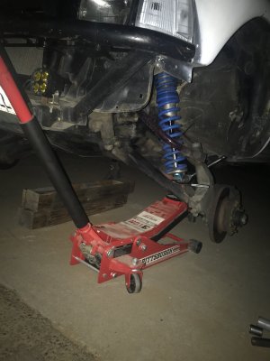

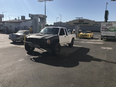

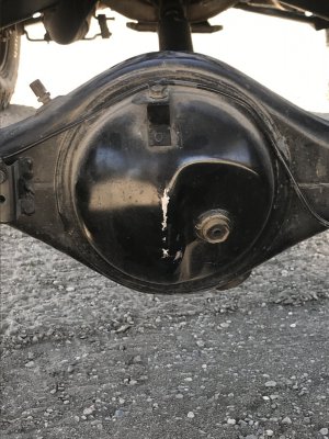

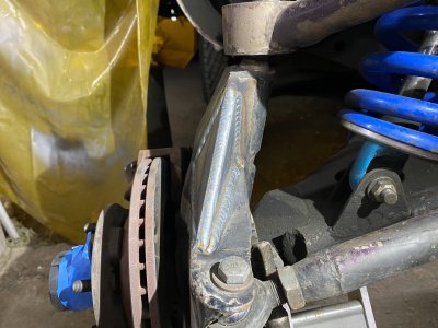

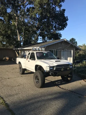

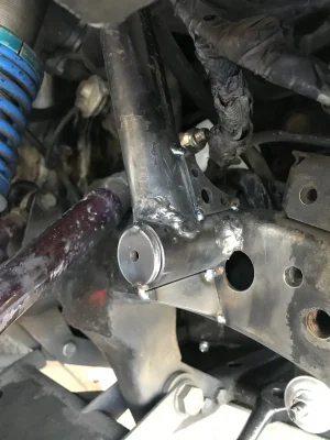

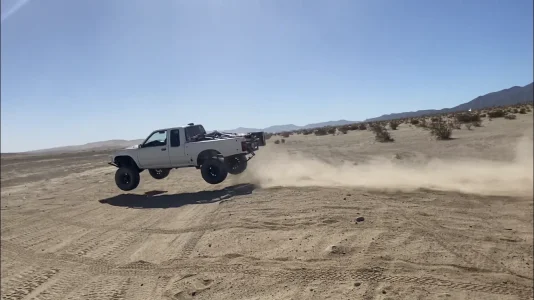

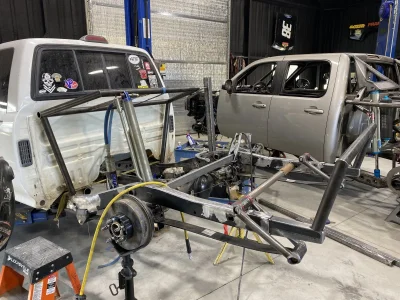

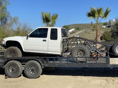

here’s my build from first purchase to where it stands now F132CC57-AF29-4D6A-9CBF-DF98FE9A37F1.webp
Got it for $3300 right before deployment, had a decent front kit on it from Craig (dog catcher) Toyota. Runs a king 2.5x10 coilover pulling around 16 inches of travel with a 86 front track width, rear was bone stock. Left for deployment and dropped off at steel nutz in murrieta, I will talk about that shop in a different thread… anyways got the 2.5x18 3tube fox bypass’ mounted up as well as deaver f67 with total chaos 12 inch shackles. Truck was completed an got new tires on it, then I went and got the front end beefed up a little bit with some gussets and took it out to octillio for some small jumps. In the process I blew up the 7.5 diff so I purchased this 08 Tacoma axle with a truss, 4.88’s and a spool. Put a fat ass light rack on it then blew the motor on my drive to Ventura one night…. Saved up an bought a full catalog motor from LCE with everything done to motor possible, still 22re then got some razorbacks added to front spindles and then took it to fiesta island an that’s a very short story of how my truck became what it is now. Future plans is cage and 3.0 bypass in the rear and then just enjoy the truck
