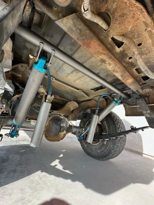

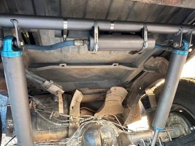

It previously had a sketch bedcage and some shocks into the trunk area but I knew I wanted to keep shocks under the bed so we put a tube from frame rail to frame rail, glued her in, added some shock tabs and boom just like that we had a new rear shock setup. (It wasn't actually that simple lol) we did lots of cycling and measuring and consulting with another friend Sean.

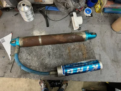

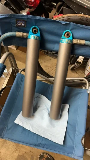

They had some King 2.5x12 Smoothie Bypasses laying around the garage in rough shape
Pulled them apart to rebuild and threw some Steel It on them
Current rear end situation. Don't mind the JB welded diff cover lol, look at the custom Deaver pack instead

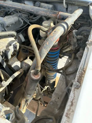

Front end has drop brackets for the beams and engine cage with some 2.5 Sway-A-Way Coilovers.

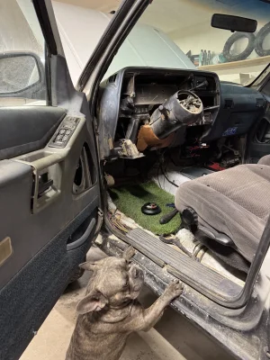

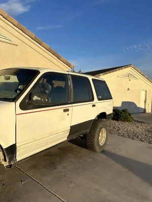

The front windows did not work, but there was a guy about an hour away that was parting out a white Explorer with working windows so I went and grabbed both front doors.
I got the driver side installed yesterday

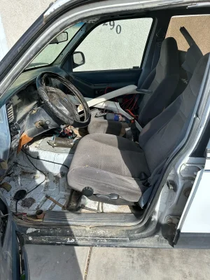

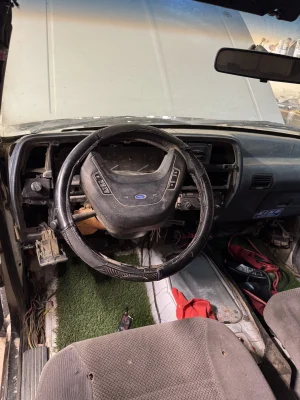

And here is the current interior situation
It's actually already been converted to manual seats up front which I'm pretty stoked on. One less electrical thing to worry about. And it used to have a roll cage in it but that was cut out last year. I will be cleaning that up better, and cutting the tubes out at the frame so we don't have random tetanus tubes sticking into the cabin haha.

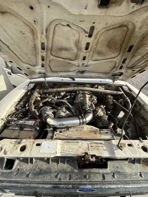

New ebay intake installed with some custom trimming to fit next to engine cage

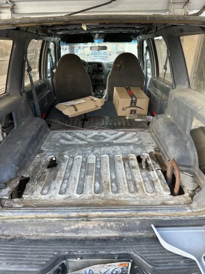

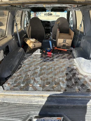

Cleaned up the rear of the cabin. How it started:
How it ended

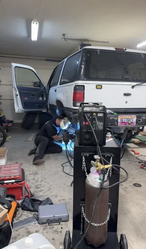

@Sean.Linden got some axle shock mounts cut out for me, and @John Reynaga and the homie Luke stopped by on their way home from SEMA and helped me get them welded onto the new axle. John also wired up my fancy chase light.

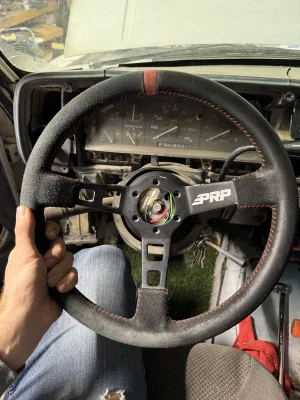

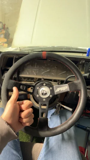

That brings us up to this week, I have a box of parts from rock auto to replace the front balljoints and brakes before KOH. So naturally I started on the most important task and replaced the steering wheel first
Old grime
Lou wondering what the heck is going on
PRP wheel I got off the BLGT classifieds!
Didn't like the no center cap look so I made one.
Also if anyone wants to do a steering wheel swap on their first gen expo and is curious what NRG hub to use. I used SRK-174H and it worked great.

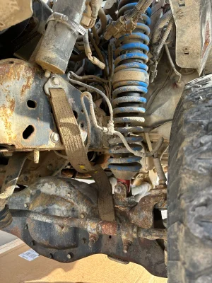

6 months later...guess it's time for updates. Started pulling the front end apart to do the balljoints and brakes and next thing you know I have the beams and radius arms in the backyard getting power washed.

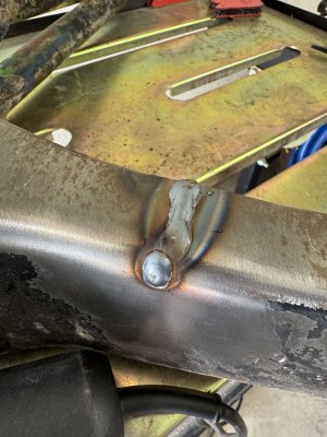

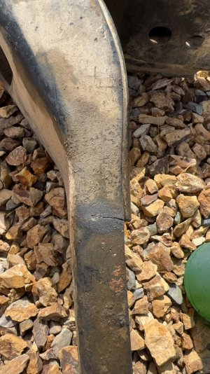

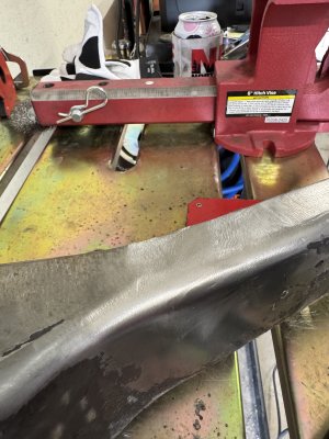

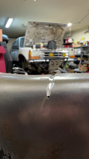

It was a good thing I did, because I found a crack in the passenger side beam!
It went all the way across the top of the beam and a little ways down the front. So I drilled it and filled it.
It wasn't pretty but it'll get the job done.
What crack?
Then I proceeded to replace the BJs, brakes, and even added some Mile Marker Manual hubs. And while it was sitting on jackstands for months the front passenger coilover decided to start leaking. So I tackled my first coilover rebuild. I'd rate it 5/10. Not terrible but not my favorite thing I've ever done.

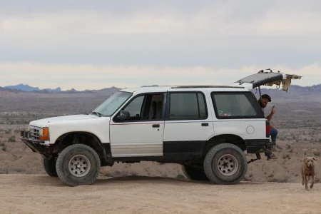

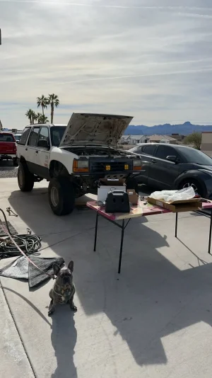

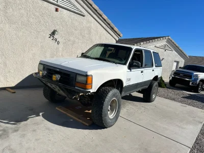

That pretty much brings us up to current day. I had been kicking around the idea of selling it and last night it was under 100 in Havasu so I took it out to the desert to take pics of it for the for sale ad....and I kinda had too much fun, so now I don't think I'm going to sell it.
