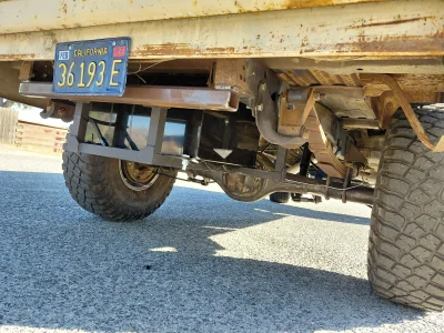

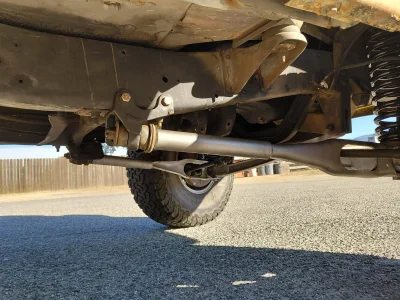

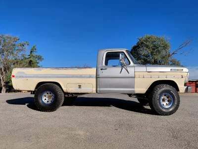

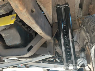

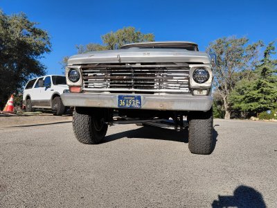

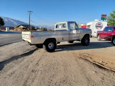

Been wanting another dent side for a while. Not really sure what all is gana be done to it but for now it's a cool around town cruiser.
69 f250 with a clapped out straight 6, 4 speed manual. Trying to keep it old school right now so built some 5" lift beams with longer radius arms and dual black rockets. The rear is longer shackles with dropped hanger to keep ride hight also set up for dual shocks. Needed a gas tank when I got it so threw in a 15 gallon cell. Currently debating on what v8 to throw in it. Would also like to make it a short bed. Had more pictures of building but ran my phone over with it.
