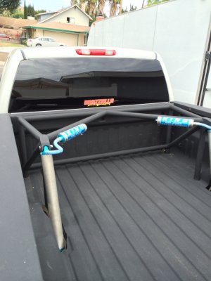

- Front: Mazzulla “Mid Travel” kit w/ 2.5” Kings
- Rear: MZ bedcage, 16” King smooth bodies, F87s

Here’s a few random pics from around the time I bought it.

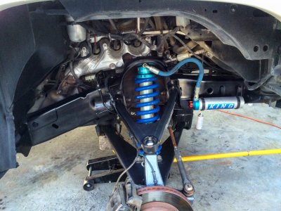

About 2 years later, after bending and breaking a few too many front end parts, it was time to upgrade the front end. A buddy of mine got me in contact with Nate at Blitz as he was prototyping a new race kit for the 07-13 GM trucks. Price was too good to beat so I sold my old front kit and went for it.
Nate’s plan was to fit a 2.5” coilover and up to a 4” bypass. Me being poor, I opted for just 2.5” coilovers and 2.0 bumpstops for now(more on that later). After a few months I was able to pick up the parts and mock it all up.
Made some bumpstop mounts that just barely tuck between the c/o and bypass location. Bumping off the upper would be a PITA the way this kit is designed and I’ve actually grown fond of bumps off the lower arm(without a bypass). This was my first real “fab” project so be nice… or don’t, I really don’t care 😂
Got everything powdercoated and got it re-installed!

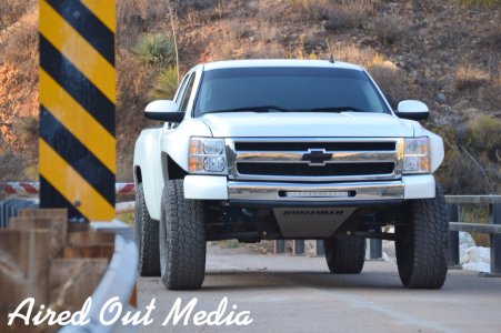

To say the upgrade was worth it is an understatement. I was able to push the truck quite a bit harder. Sadly around this same time life started to happen. Long work hours and bills to pay took chunks out of how often she saw the dirt. I still tried to take her out to local spots a few times a month, not a lot of documentation on that. Lots of daily driver miles too.
Then my girlfriend(now wife) and I bought a house and moved to AZ. This truck and her car were our only vehicles at the time so ole’ Brola got a ton of DD miles. I let her drive the truck most of the time because her commute was shorter.
Got tired of replacing hubs every year so I bought a set of MZ hubs. And a fresh wrap, switching it up from the Satin Pearl White that it was to just a Gloss White(trying to combat the AZ sun a little).
