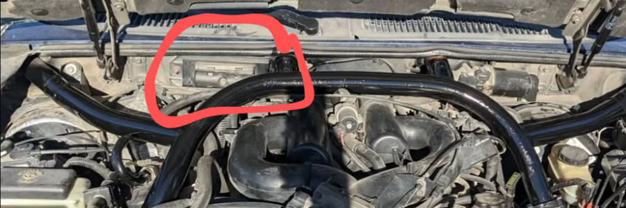

Not sure if you have this connector but, Have you checked this connector here? I know these were a problem and created some weird electrical Gremlins
