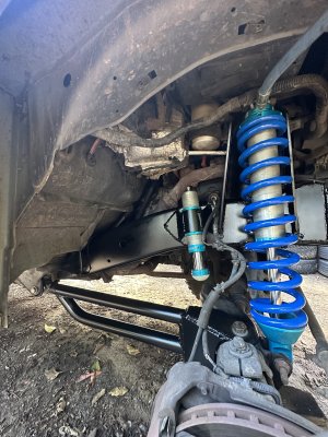

Took a couple hours one night to get the whole front end taken apart and then I started to clean up the frame rails and things like that. Took the coil bucks off and I got a beam kit off of face book marketplace. I got it for a grand with swingset steering it actually came off of marcels or (Marceytech) truck when he got a better beam kit. Also huge shoutout to Marcel for all the help and always answering my questions as they came. He always texts back. I got some radius arm buckets off of DIY off-road and had them laser cut. The beams went into factory beam pivots so I did 1/4 weld washers so the metal was thicker where the bolt went in for the I beams.
Here are some more pictures as I got the beams hung!

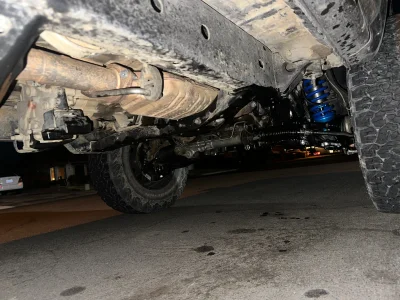

Me and my dad build the engine cage and made gussets for it and then started to cycle the front end and I’m getting around 15 and a half inches of travel in the front bumped and strapped pretty good for stock pivots and stock bushings.
The shocks I got for a grand they are Sway away 3.0x14 coilovers they work pretty good so far
Eventually the front was done and I got some really dry cracked bfg “KO” tires for an 100 bucks I couldn’t pass them up. They worked good for rollers, the front was pretty much done for now after final welding.
I got some deavers and shackles for the rear for now and also some leaf spring hangers to lift it and dad pulled the bed sides for me. Also put some shocks my dad had laying around on the back to get a little bit more travel so I could at least drive it off road.

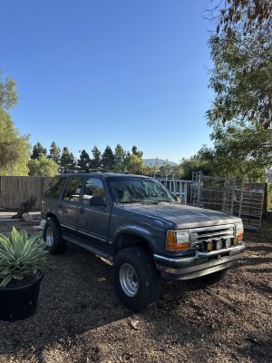

This is a picture I took of my buddy about to pull me 45 minutes home with a strap 🤣
I got some 35x10.5x15 tires for 400 dollars in a pinch to try and make in to Koh in time and and built a rear bumper and a little chase light mount.
