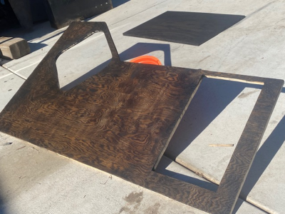

Wife finally came home (she's gone for 1 month at a time) so I had a little free time after work.
I had been planning on burning in the grain on the counter top so I went after it.
I went a little heavy in a few spots. First time doing something like this.
I hit it with a palm sander to try and smooth it out. Any tips to help smooth out the darkness in some sports? Wood is Oak Plywood from Lowes.
It's going to get a stain soon.

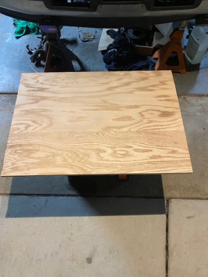

Here's a little before and after on what the wood looked like.
This piece of wood will be the wall to the closet area. I may cut up another piece because you can obviously see the different grains since it's a plywood.

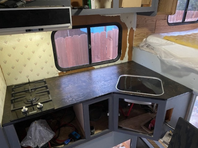

Burning the wood always looks good. Also If you find a piece of plywood you like the grain on. Have home depot/lowes guys cut it on their track saw. That's what I've always done when using burnt wood for backer on signs. Also I burn it more than you did and then use 4-0 steel wool to buff it back and get rid of any ash on it, then I stain it with some wood stain before varnishing it for durability. I need to make a camper of some kind for my truck, just need a bed, sink and bathroom.
Thanks dude.
I hit it with 120 grit on the palm sander. Didn't read your message about the steel wool until after I had put a finish on it. Here's how it came out after a finish and some varnish.
The second piece (square in the background) I hadn't sanded prior to staining. It did not turn out nearly as well as the counter. So going to scrap that piece and re-do.
