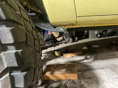

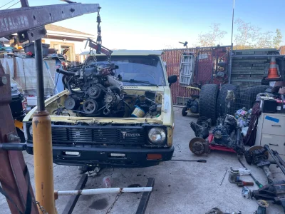

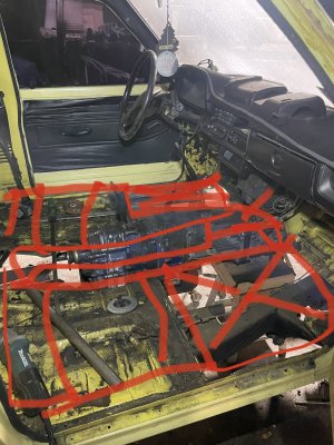

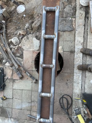

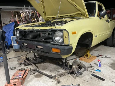

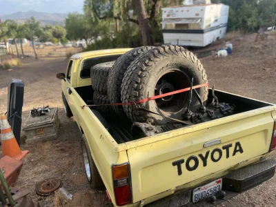

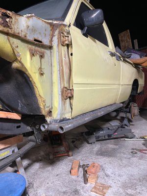

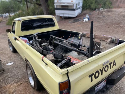

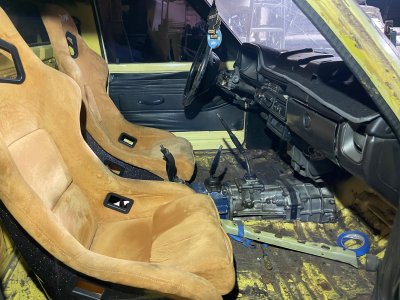

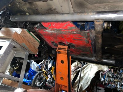

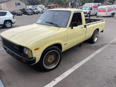

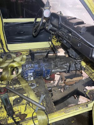

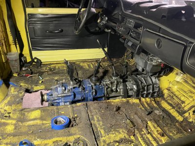

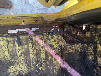

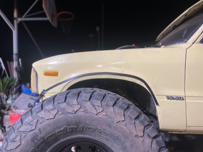

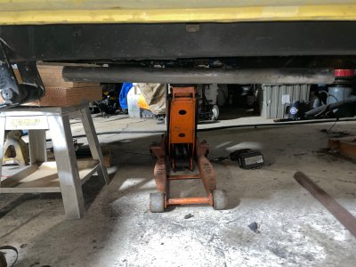

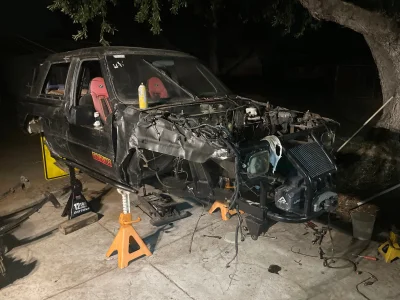

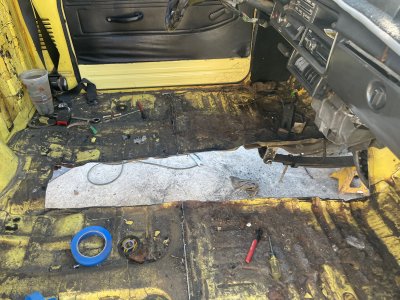

Since I don’t have the time or funds to finish my 4runner I got a 2wd pick up I’m about to swap everything over to wheel for this and maybe next season. I’ll post updates as it gets done. Also I plan on selling the thing eventually when the 4Runners done.
Parts list
-taco width rock assaults
-3rz
-w56 and dual cases 2.28 front 4.7 rear
-rears up front and Chevy 63s
-150’ of 1 3/4” DOM tubing 😂

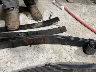

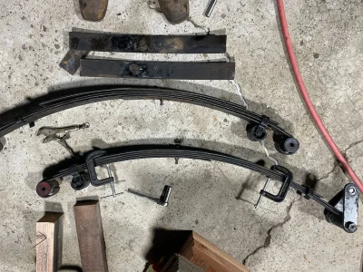

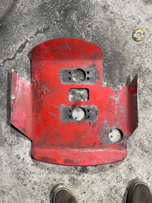

First things first pulled a spring from the ruf pack that was on the runner they work good but I’m trying to keep this thing as low as I can and cut a lot of the fenders and body off it I need to. I was going to French the hangers but I’m lazy and have a lot to get done in a short amount of time.
The anti wrap leaf on top is great idea broke a lot of spring packs before I found that out. 🍻
