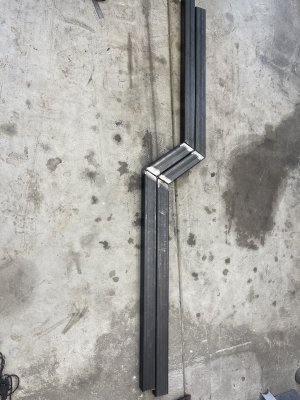

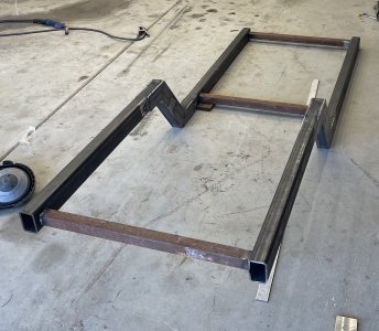

Originally I planned on keeping some of the stock frame and building off that, but I ended up just building some 2”x3” .188 wall frame rails for it
Temporarily holding them level and square with some 1.5” square tube

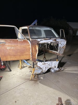

Gutting the cab

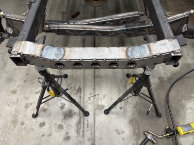

Got tired of the rusty square tube so I built a front crossmember, no idea if it’s going to work but we’ll see

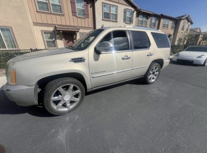

Trying to keep this thing on a budget, picked up a 2008 Cadillac Escalade as a donor truck, going to be using the motor, trans and rear end out of it for now. Bought the Escalade for $3,000 and I sold $2,710 of stuff off of it. Still have more to go so I should make a small profit and still get a 6.2, 6l80 and a 10bolt for free, pretty stoked on that.
Gutting the cab
