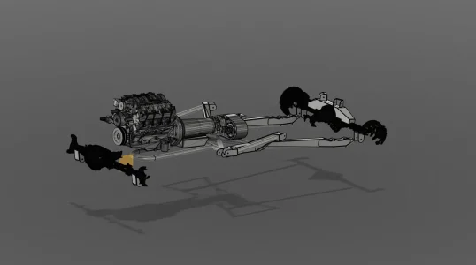

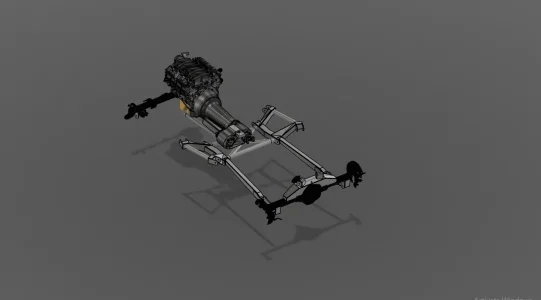

Finally started working on this thing again - Once again booted the idea of using the stock frame, I'm going to bite the bullet and do a tube chassis.
Initially had it set at 105in wheelbase, now it sits at 116, I'm working on V2 of the lower "bulkhead" since I moved the wheelbase around to be able to fit the powertrain package which will be a SBC 383, th400 or a manual, haven't decided, and a NP203 or Dana 300 since a billet T-Case like an atlas or TMI box is probably out of budget.
I can see packaging on this thing being my biggest issue by far, and I will most definitely end up lengthening the tub since I'm not going to like how far the axle hangs out the rear end. The axles are a GM Corporate 10 bolt (pass drop dana 44) and a Dana 60U rear.
Got the central bulkhead pretty much figured out after redesigning it a half dozen times. I'll most likely add more bracing in the upper link mounts by just adding some cross tubes between the pivots, but this bulkhead is entirely overbuilt, I don't want to have to redo any of this later down the road because I find it isn't beefy enough after slamming it into rocks repeatedly. Currently have my antisquat set around 80-85% and antidive around 50% or so since this is a hybrid rock crawler and desert rig, with these numbers I'm shooting to get good traction in the rocks while keeping the front end from diving and the rear from overextending in the big fast hits.
