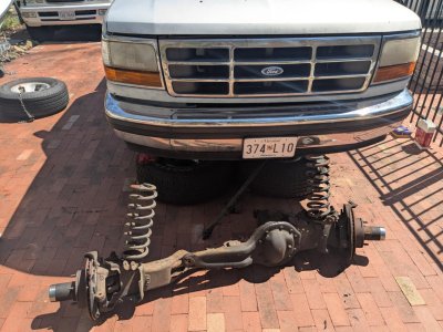

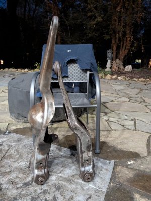

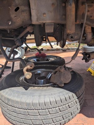

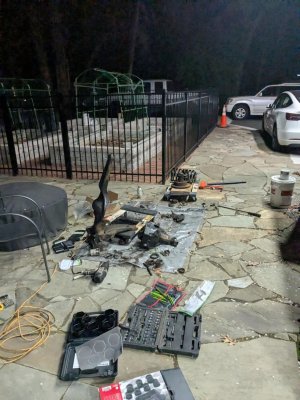

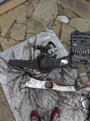

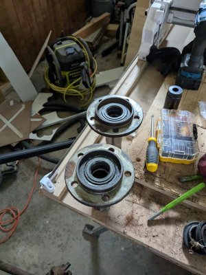

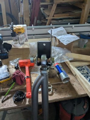

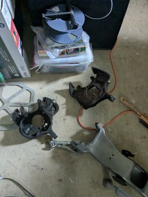

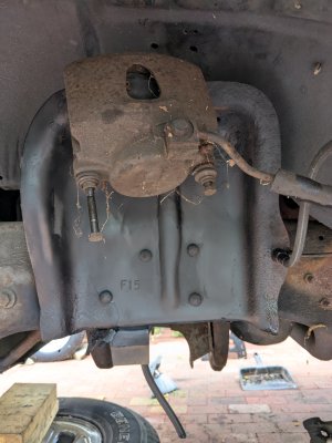

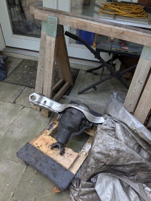

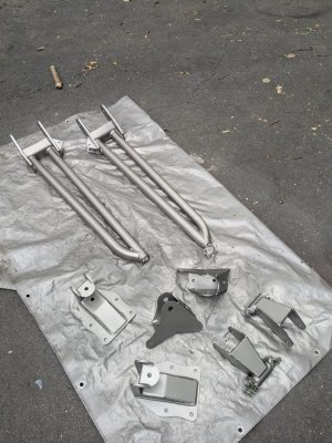

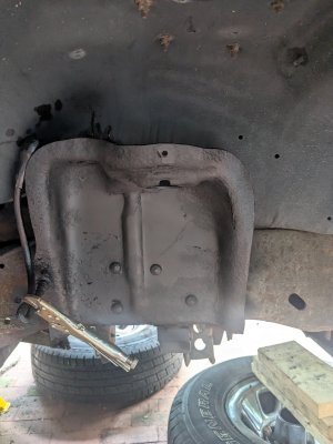

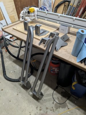

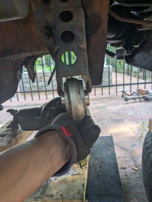

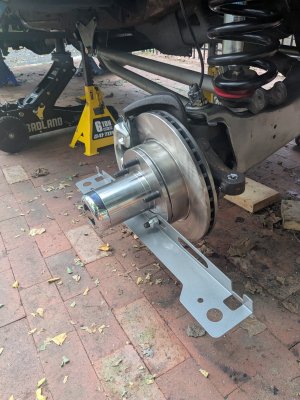

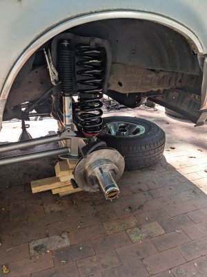

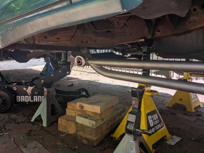

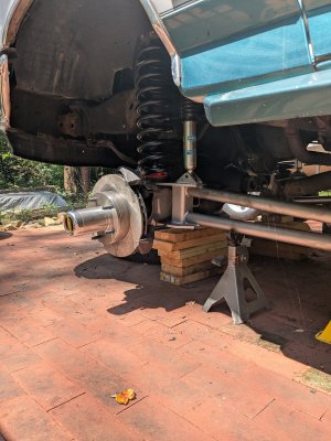

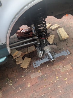

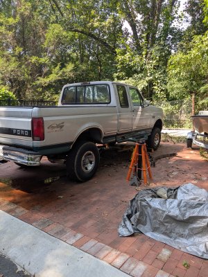

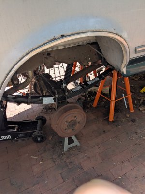

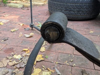

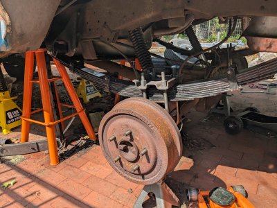

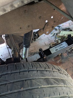

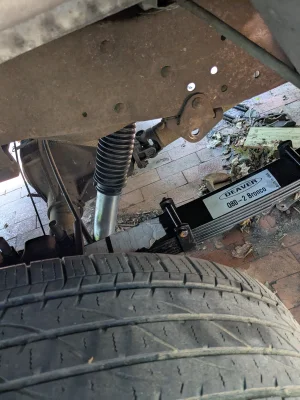

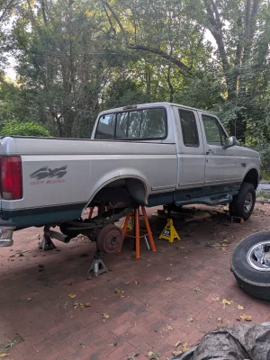

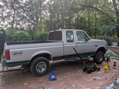

In the process of building a 1996 F-150 for camping and romping around the East Coast. Threat motorsports is doing the kit - cut and turned beams, radius arms, deavers in the back with 5100's (for now). Doing a refresh of the steering as well, knocking off all the surface rust and, and putting in a set of cheap corbeaus I found on marketplace. Once I sort the suspension out I'll be building a little pop up camper out of extrusion. Probably will keep the stock wheels and bump up to 33's and if I find I need more travel/shock adjustment, I'll step to kings and the threat coilover bucket with the under the bed shock hoop for the back and maybe 35's. Still waiting on parts right now, but I'll keep this thread updated as I finish work on it!
