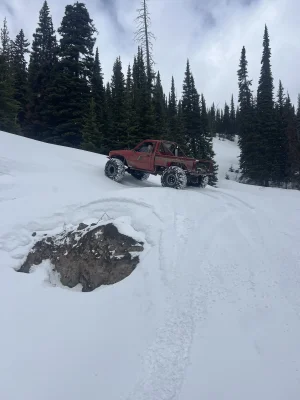

Rosé - rear steer 88 toy 🇨🇦

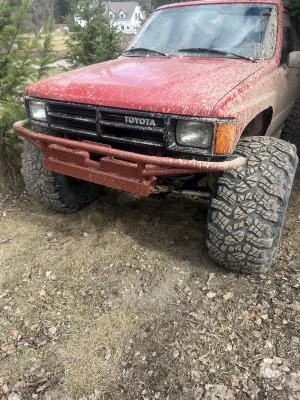

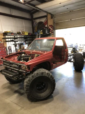

This was a fresh build last winter, it worked but had quirks. My buddy had some life changes and decided to sell it, I bought to see the project through and dial it in. I would love for it to be a fine wine and right now it’s more of a rosé

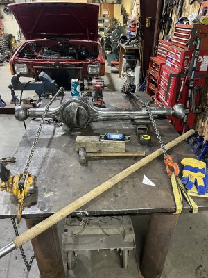

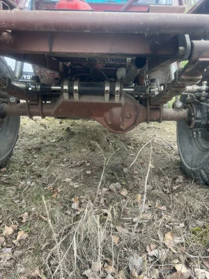

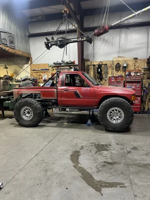

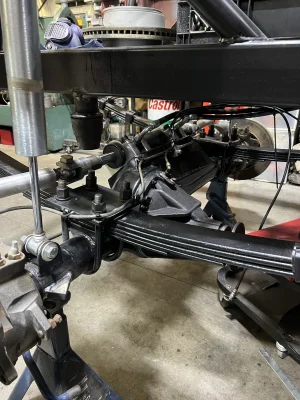

Interesting way to store an axle. It's definitely out of the way.
I work best under suspended loads

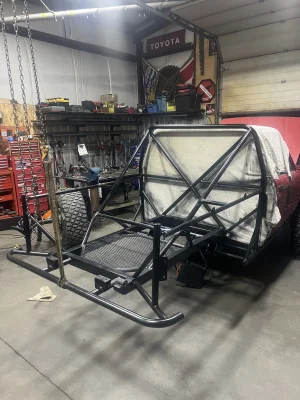

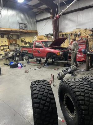

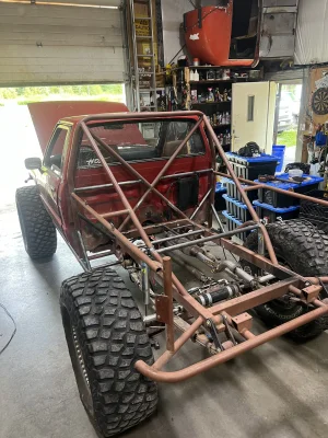

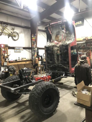

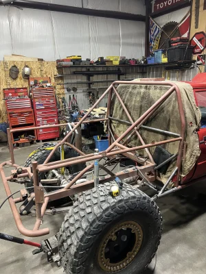

Next up was starting the flat belly and front suspension rework

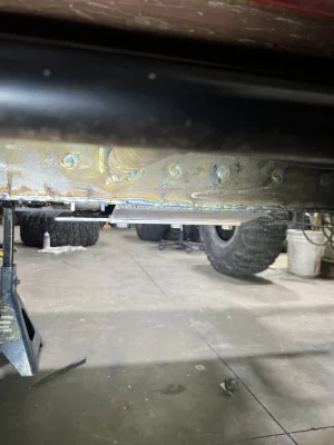

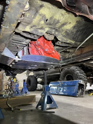

Made a custom skid plate and added 1” to the bottom of the frame rails to get a bit more room under the cab and stiffen the frame up

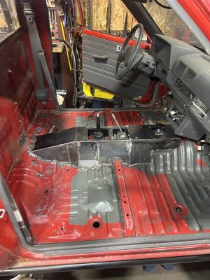

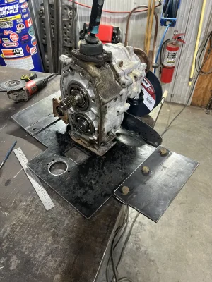

The trans tcase came up 6” to be parallel with the frame rails

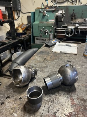

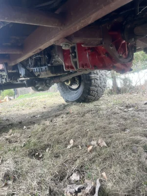

Tg rock assault axle removed and sold. The pumpkin is massive making clearance a pain and the knuckles limit steering compared to factory

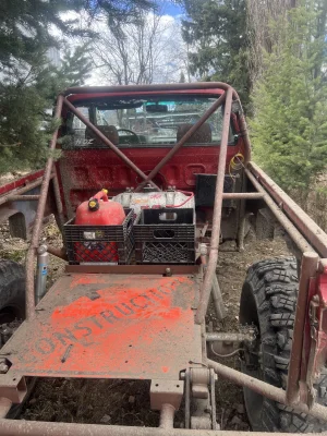

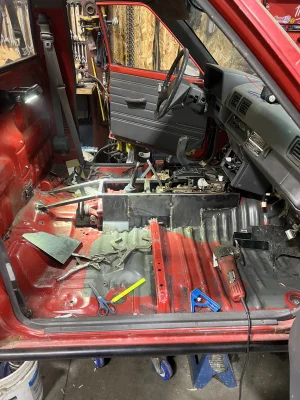

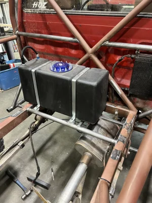

Get the floor finished up and some little misc things. That brings us to current, I’m putting it on the back burner and working on some other projects but I’ll get back to it sooner than later IMG_0505.webp

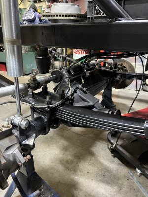

Rear bump stops and brake lines mounted

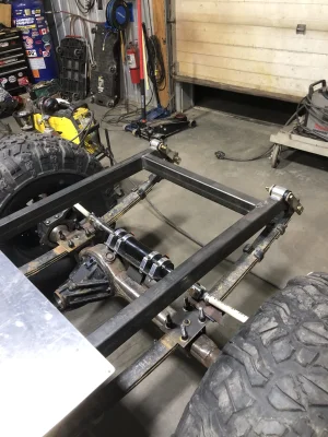

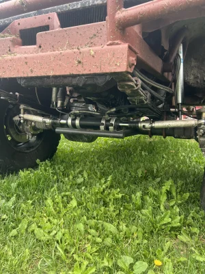

Widening the front axle +1.5” a side

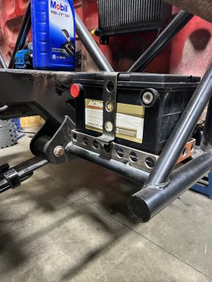

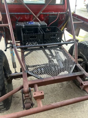

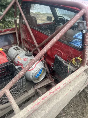

Battery box
