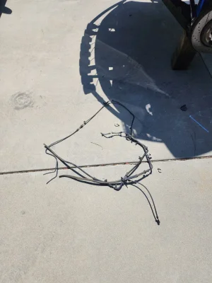

I'm leaning into doing the delete. Trying to do the secondary shock and it will be nice just get the vacuum lines out of the way.
