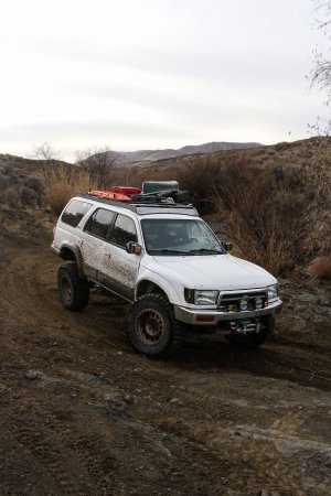

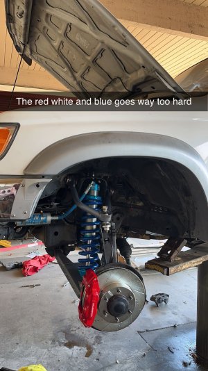

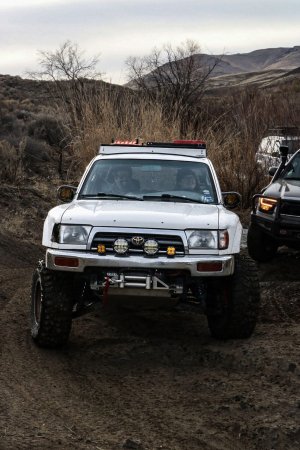

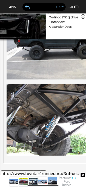

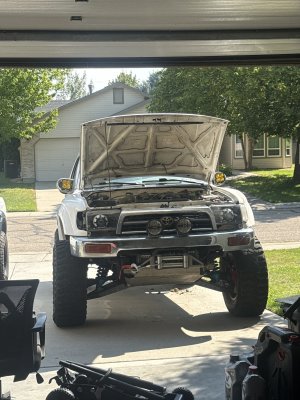

This is my 98 4runner limited that I’ve been building for the last 3 years and I thought I would finally start a thread on it since I’m planing to start building the rear. It currently has Total Chaos 3.5” long travel and some 2.5x8 coilovers. I just picked up a rear sequoia axle to match the front and to help run bigger shocks with less cutting. I’m on a budget as I’m still in college so I’m planing on running total chaos links and then an outboard shock setup with some 2.5x12 bypasses.
