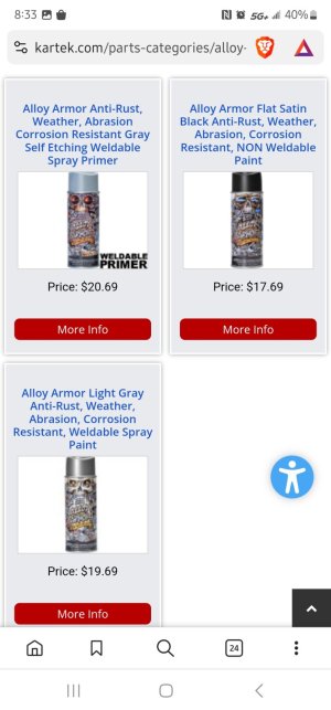

Just trying to get to the bottom of this mystery. Where can I get a Alloy Armor SDS?

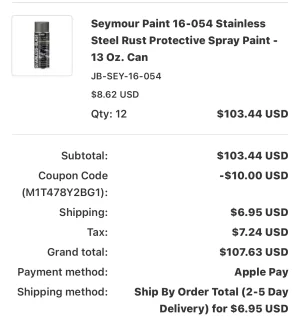

Yes we just did my suspension in it. It’s the same and if it just happens not to be, the Seymour has such minuscule difference. I got like 12 cans online for like $100 shipped? Lol. And it’s at autozone too

You did the suspension in Alloy Armor or Seymour?
With the cost of Krylon professional creeping up I tried Seymour 316L and was thoroughly impressed. Sprayed out smooth, went on thick, and didn't run. Retail of $13 but regularly on Amazon for less. Impressed me enough to want to try their MRO paint on axles I want black.
The Alloy Armor art is cool, but not $7 cool.
Not sure about the Alloy Armor vs Seymour. I do know Nick ( Loose and Lost) and Michael Cox are good dudes. Alloy Armor is their company. I'd rather support a few buddies and spend a couple bucks more personally. 🤷‍♂️
It’s easily double the price, without shipping. Them trying to pass it off as something it isn’t is lame. Makes me not want to buy anymore loose and lost stuff lol

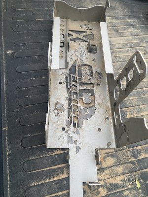

I will never use steel it again. It fades really fast and the skid plate for my badlands jack started to bubble after less than a year of being sprayed. Plus it’s way over priced and usually only get to use half a can before it stops spraying.

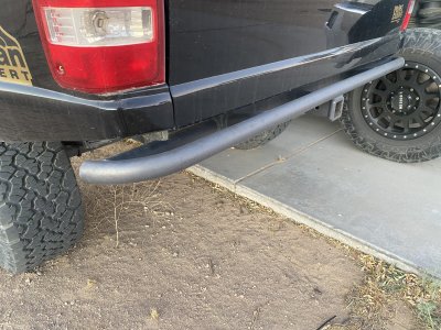

Just did all my bronco suspension in Seymour. It sprays on really nice and dries to a very consistent smooth finish. No runs or drips. Also you can get through the entire can without it clogging or running down the side of the can like steel it. Paid 8 bucks a can at JB. So far i'm a fan.
Side note I had 3/4 of a can of steel it left so I decided to do a removable cross member in it. Got about 10 seconds into the can and it clogged!! To be fair the can has been sitting on my shelf for about a year.
