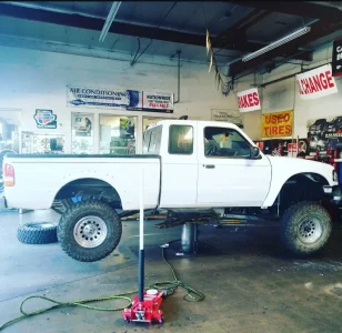

Truck looks rad dude!
Still leaf sprung?
Yes! Deaver F31s with and Bilsteins with a resi in the rear. The shocks mount to a tube that run between the frame rails where the spare tire used to be. It's a simple setup. Looking to do spring under or a short course link setup in the future.
