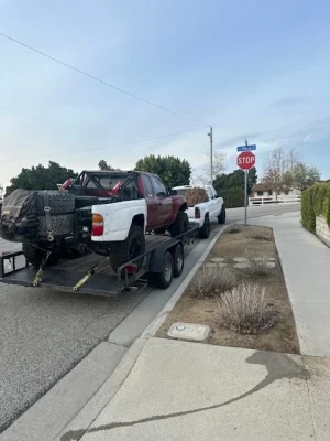

Whose flat tows their desert truck? I generally drive my Tacoma to trips, but once a year a beg/borrow/steal a trailer to drag it to KOH. I’m too cheap to buy a trailer and store it to use it once a year. Considering going the flat tow route this year.
Tow vehicle, 2003 1500HD Silverado tows the Tacoma on a car trailer just fine.

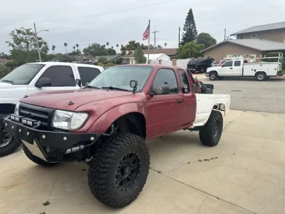

Desert truck. 1999 Tacoma 4wd on 35’s. Long travel, cage etc. It is an auto, so I will definitely have to un bolt the rear driveline, front should be fine with the t case in neutral.
Any tips or insight? Things you have learned or tow bat recommendations.
Truck in question.
